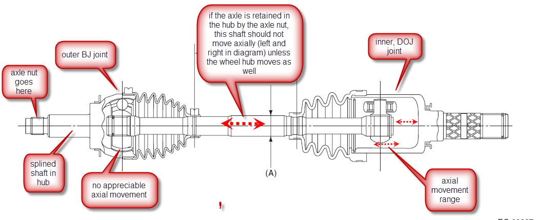

thanks, I think you are right. I found this diagram on the web and it should be helpful for others.
Basically the outer joint (wheel hub) and the shaft should move together. The lateral movement occurs w/ in the inner joint (front diff side). Thus, my symptom is not normal as my shaft is not attached to the outer joint.
Now I will have to study and decide what replacement cv-s I need to get. lovely...
