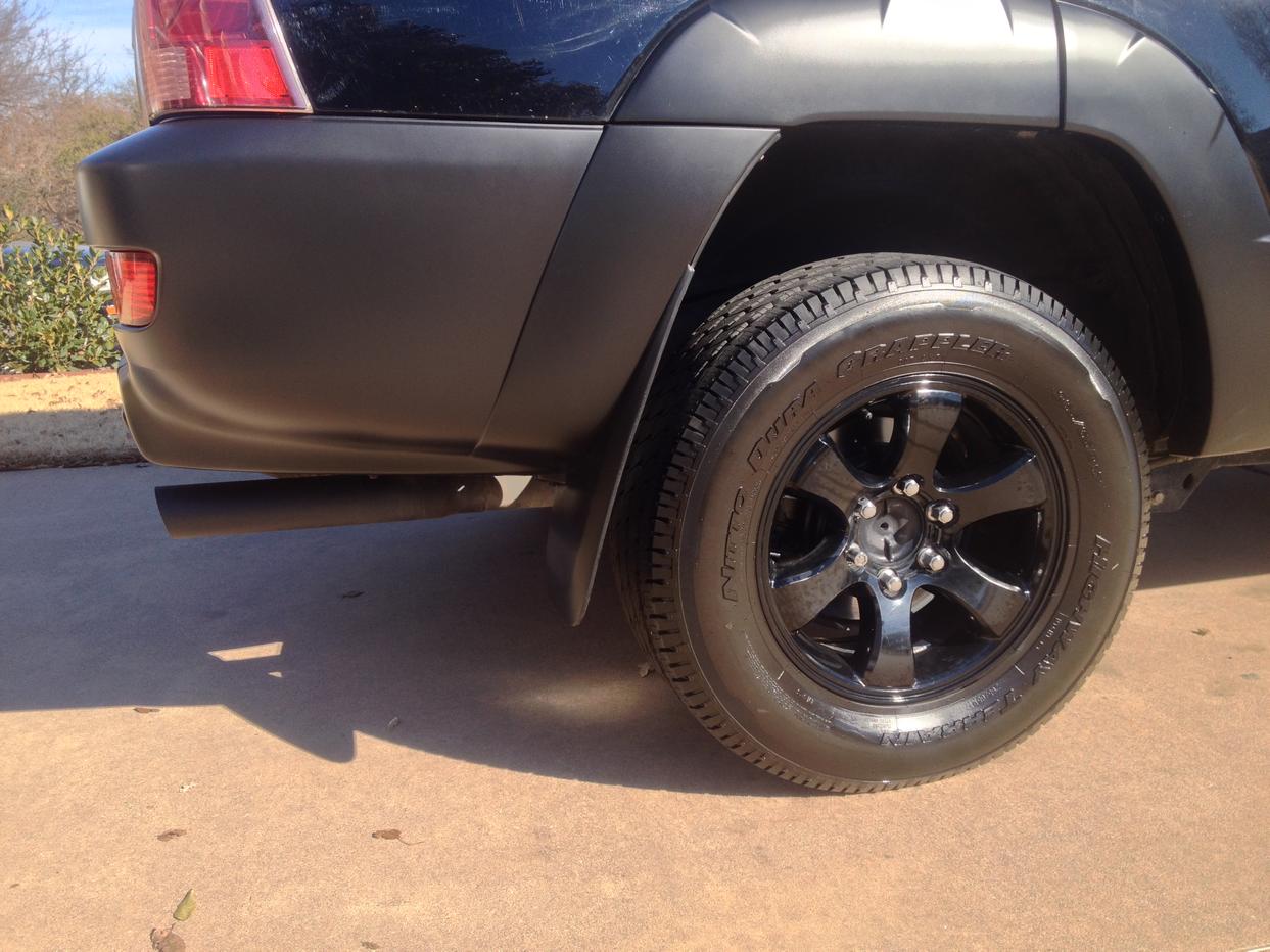

any idea (roughly) what it would cost for a shop to cut off the old and weld on a new section of pipe?
It cost me $35 for the 3" Stainless Steel tip and installation.
