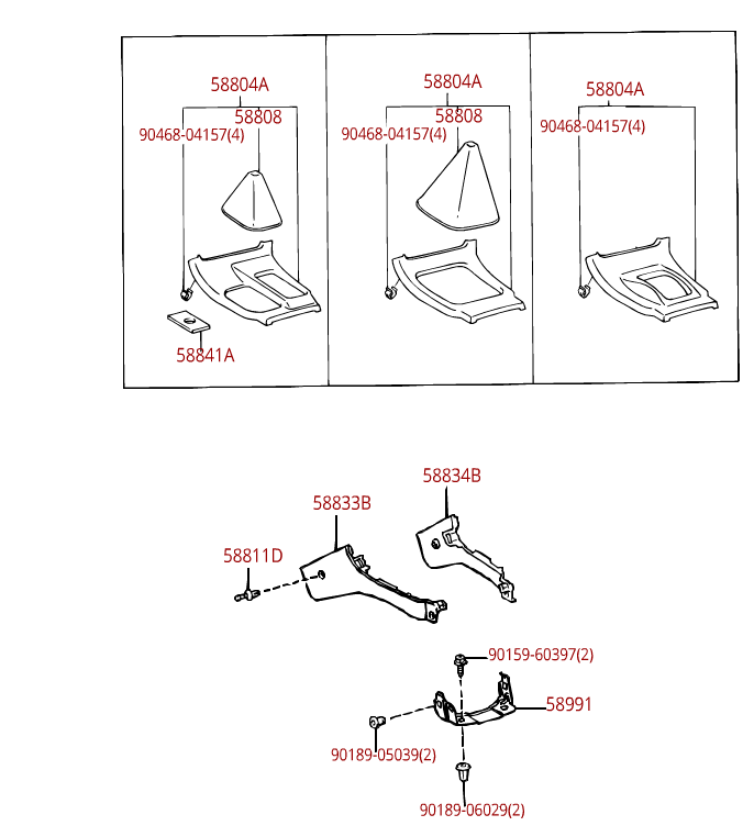

Well when I went into the catalog the part that shows these are the same between 96-98 and 99-2002. it uses the same pictures and has the same part numbers the lower part you are talking of I am not so sure of. Although the 'wings' that go up under the dash (in the picture they are the 58833b and 58834b) they are what is used to mount the upper piece (58804a) to the vehicle. I also just checked the wings are the same for the 96-98. I would be willing to send you mine. Mine is the 'wood grain" style I would hate for it to get broken. It is expensive :(
That's weird that it shows one part when there is clearly 3 different parts. There is the 4WD, 2WD, and the manual. Looks like I need to find one lower piece and then all 3 of the top bezels. I will probably have to make a cup holder for each option because I want it to be on top of the console as much as possible and not hang off the side. I want to ensure the passenger seat moves all the way forward without issue and the passenger doesn't have something sticking out into their leg. My guess is the 50% of the cup holder will be over the console and 50% will hang off. Very similar to my 80 series front double cup holder.
I may have mispoke. there are 3 different upper pieces as in the picture. they are the same part numbers between 96-2002 the lower are the separate pieces.
I didn't realize until I was in the junkyard removing the center console that the lower piece was actually 2 separate pieces. There is the driver side, passenger side, then the top black bezel. 3 pieces total. I then needed the 3 pieces off the other gen 3 for 6 total pieces to give me the auto and manual trans set up. At least now I have everything I need and can get the design side of this wrapped up.

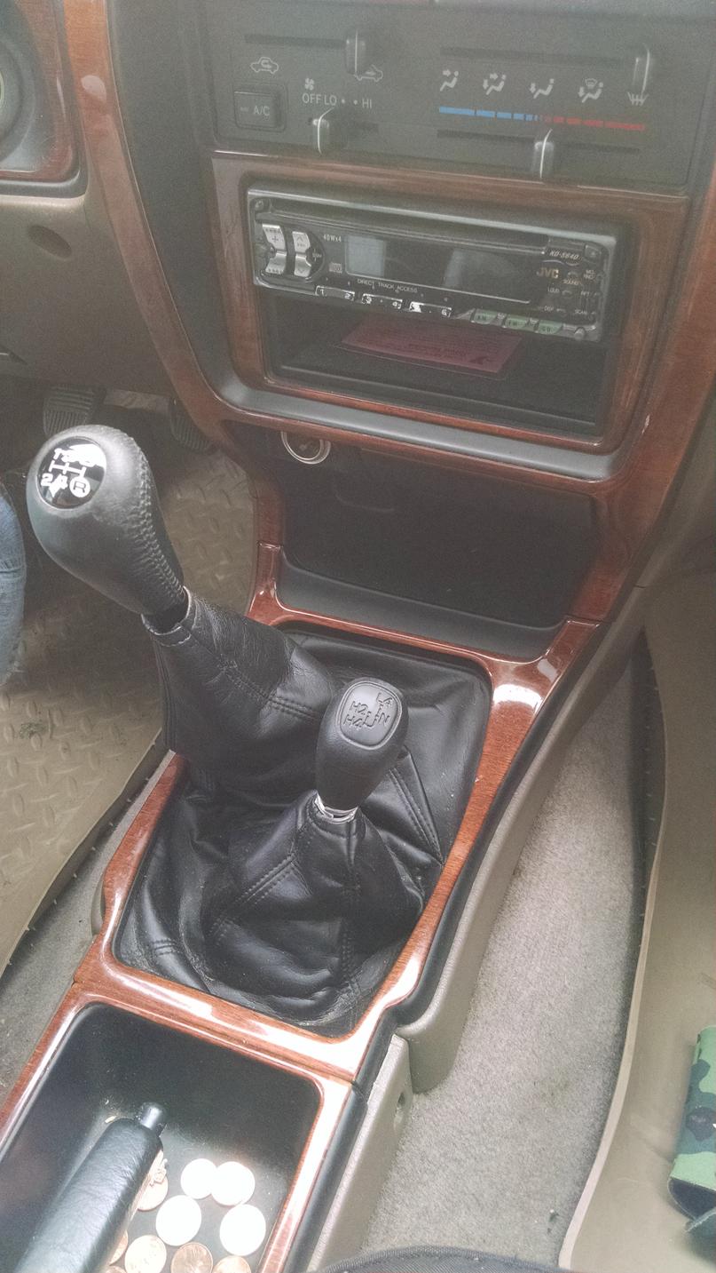

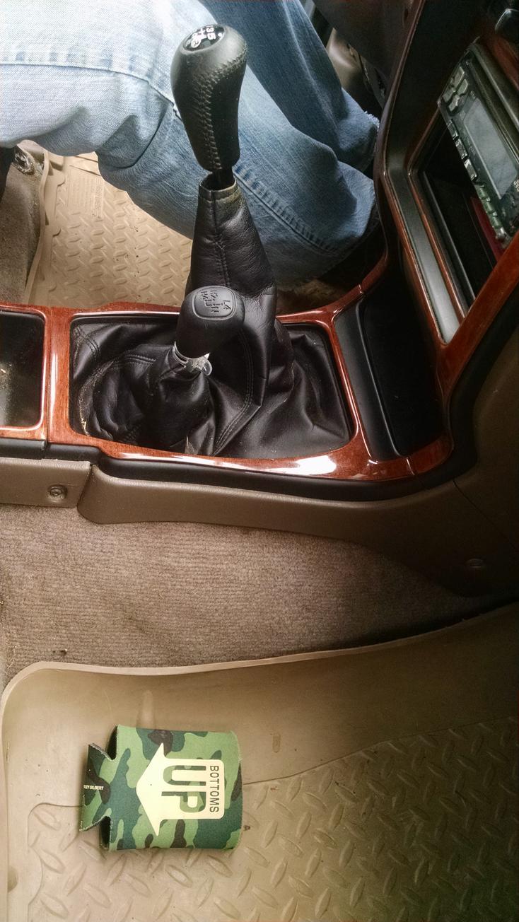

Do you have a pic of that console bezel? I want to see if one of my 2 current designs will work with it or if I need to create a 3rd design. Also, do you know if there was a 2WD manual option and if that was a 4th bezel option? In post 43 of this thread a member posted a diagram showing 3 bezel options but it looks like the manual option is for a 2WD and not a 4WD. I definitely need to know with 100% certainty what all the bezel options are and make sure I have one for each option. If I need to create two more designs then whoever loans me there bezel will get a free cup holder shipped back with it. I don't need the gray/tan part underneath since I already have that. I just need the black piece that goes around the shifters.

Just a note, the autos have another piece for the shifter that has the P-R-N-D-2-1 that comes out of that thinner slot. Its raised and has an arc shape, higher in the center of the arc. I mention this since I can see you cup holder partially covers opening.
I don't have measurements on me right now, but it does protrude up higher than the console. You can't see it too well on this picture, but it is raised.
https://flic.kr/p/uMPGUi
if you need more angles, let me know
