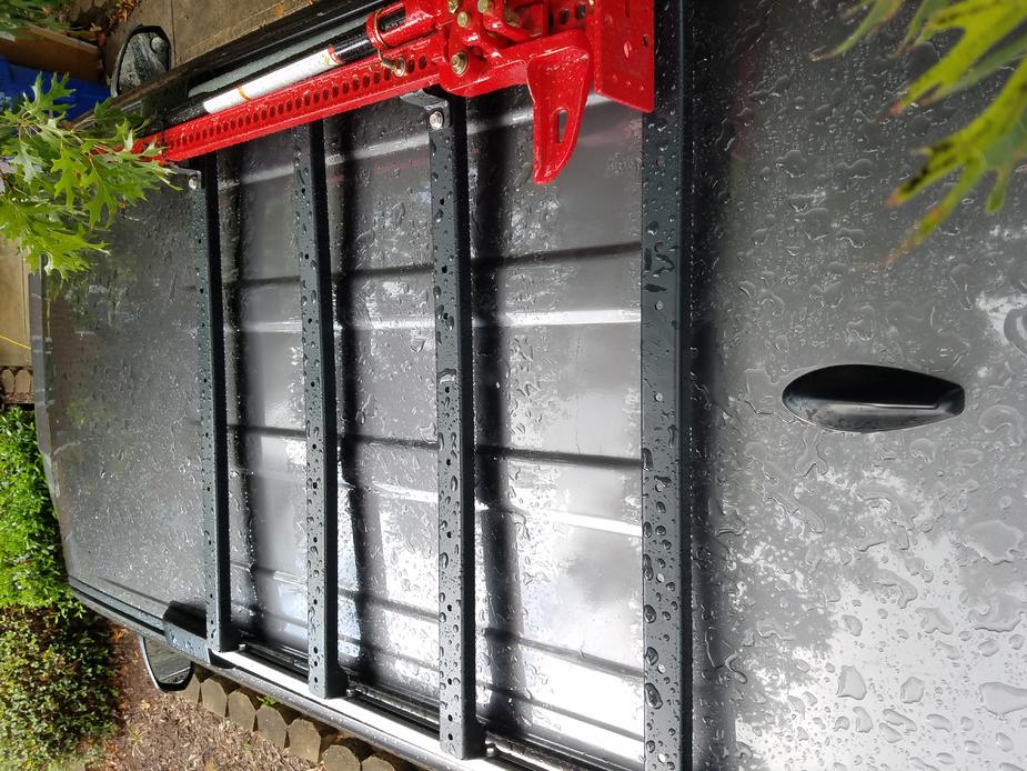

there is metal inside the end piece on the factory bars
However I strongly recommend the LFD off-road crossbars though over factory, they are much stronger, sit a little bit higher, offer a flat surface, and allow you to easily bolt on whatever you want.
i have the hi-lift mount that is being developed on mine, there are a few other accesories that will be available in the next month or so
http://apexoverland.com/#!/LFD-Off-Road-Ruggedized-Cross-Bar-Sets/p/97509282/category=21774015

I'm really liking those crossbars, thanks for posting.
I know there are threads for removing the end caps, but my question is: can ^these crossbars be installed by just removing one/both end caps?
Oops, one more: I can't see the hardware that secures the crossbar to the rail. So, to loosen/slide/retighten the crossbars, what is required? A socket, torx, box wrench, fingers?
TIA.

installed/un-installed the same way as the factory cross bars
you pop off the cap in the back, if you have a paint can opener that is the easiest tool to use. then you just slide them in and tighten the bolts.
there are 1.25" x .25" squares that go into the side rails, 2 on each side of each cross bar (4 total per cross bar) that the bolts go into.
All you need is something to pop off the back cover (screw driver, plastic panel tool, paint can opener, etc...) and a socket or wrench. The rails have pre-drilled 3/8" holes to mount accessories and also larger holes that fit maxtrax mounting pins. The hi-lift mount works well, and since it's just holes and a flat metal surface you can pretty much mount or drill and mount whatever you need.
