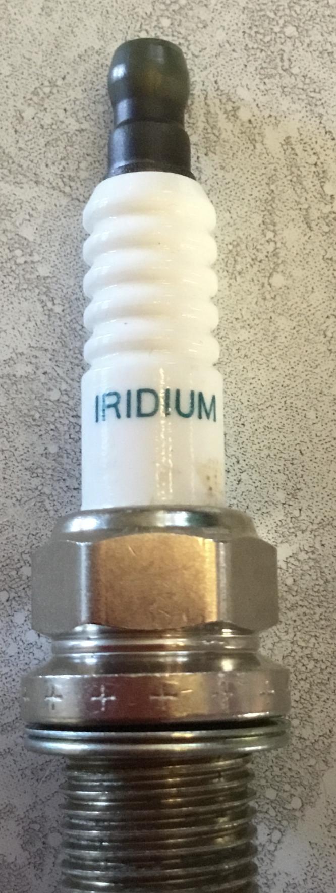

This is what original part looks like:
Keep in mind that seller image online can be genuine Denso while what they send you may not. Check your product when you receive it. There you go:
The box shows the latest part number. However, according to the Car Car Nut video, the metal case should be engraved with "ASSEMBLED IN THE US WITH FOREIGN CONTENT" (time stamp 12:45 in the above video link.) Furthermore, the box should have printing on the side that states, "Made in the US with Foreign Content".
This Toyota web site probably doesn't update their photos each and every time the spark plug has changed. Printing on the ceramic appears genuine.

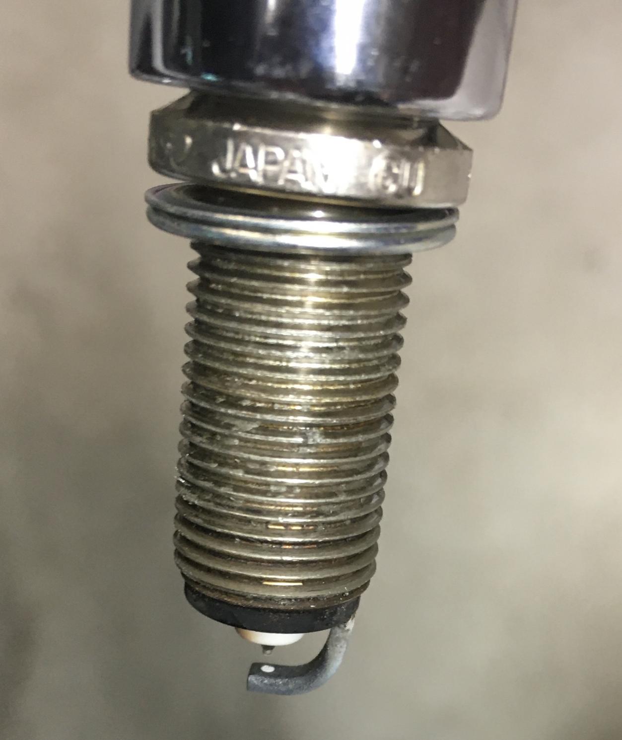

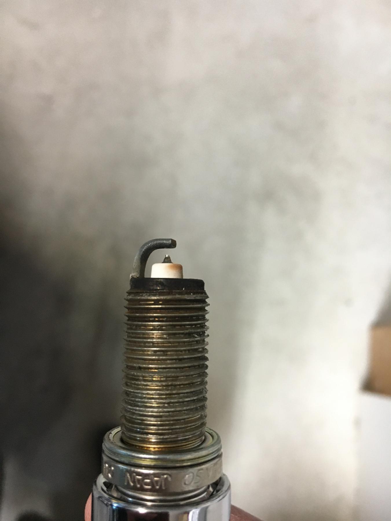

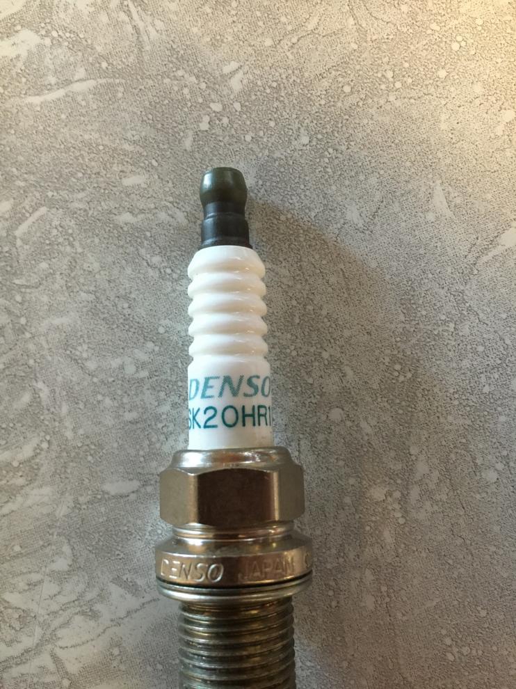

I pulled one of the plugs I bought on Amazon and installed several years ago. Bought directly from Amazon, not third party.
First of all, only 35k miles and this plug did not come out smoothly, I think I will use anti-seize on the next change despite the warnings.
This replacement plug was not bought as a Toyota part but as a Denso part.
Says “Japan” in the engraving.
Mine passes most of the counterfeit checks.
Good screen printing.
Good looking center and ground electrodes: width, weld, color.
Good gasket feel and gap.
Passes the scratch test for plating or paint.
But fwiw, the engraved printing is not really centered, it’s a bit low.
I think it’s genuine and my performance and mileage is normal.

Well I ended up pulling all six plugs to have a look and to apply anti-seize. All looked about the same as the picture above. All threads felt sticky so hope the anti-seize improves that when it’s time to remove them again.

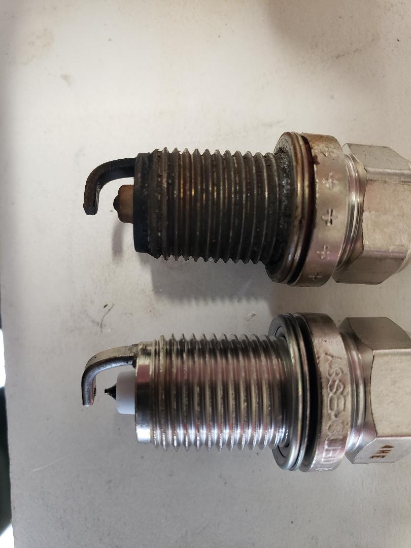

eBay Denso plugs are FAKE and cheap, I got 6 for $24 for my daughter's Highlander and they wore out in 15,000 miles. Check out the pic, the center electrode is GONE. Started misfiring, threw a code, and burned out one of the coils. Required a tow. All 6 look this bad. and changing the rear bank took 1.5 hours EACH.
The counterfeits said Japan had the + signs engraved.
The Denso in Toyota box from Coad Toyota say "Assembled in the USA with foreign content"
If you aren't paying $8 to $11 apiece for Denso plugs, it is probably a scam.
The genuine plugs for the 4Runner, and looks like the Highlander as well, should have a slightly tapered center electrode ceramic insulator.

Yeah the paint is burned off the engine compartment with all my #@$*&^@ bad language! left some blood in there too. Whole ordeal cost $220 including a uhaul rental (gas not included) because I was a dumb ass and bought counterfeit plugs to save a few bucks.
