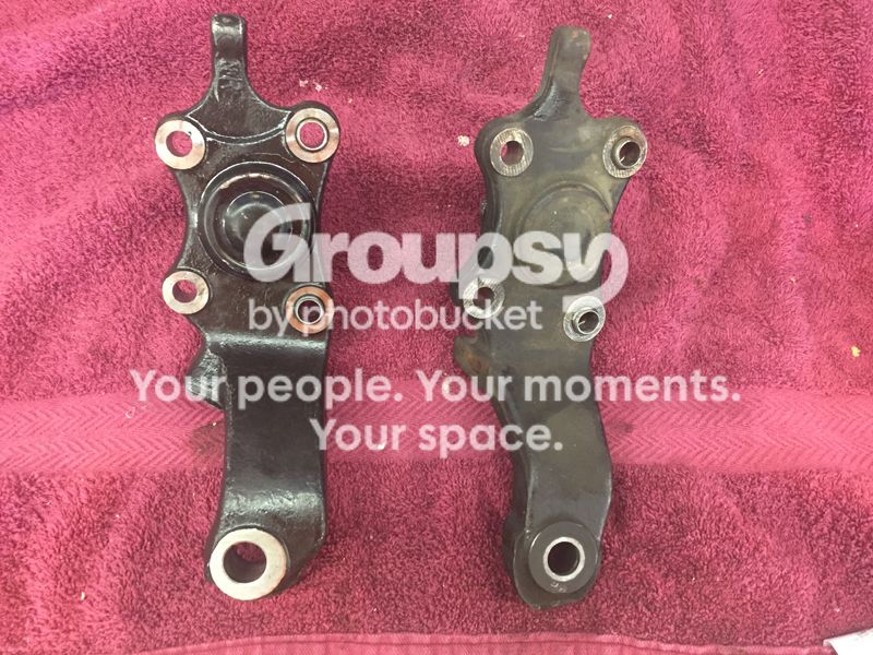

Here are old and new, side by side.
You can see how much oversized the hole for the tie rod end is, and what looks like a bushing pressed in to the old one. Maybe it's just where the paint rubbed off. Looking at them more closely to take the picture, the new one is different from the old one in several other ways as well, and pretty crudely made. The off center drill for the tie rod end looks especially strange.

Looks like a Tacoma LBJ. Why they didnt simplify and just use the same LBJ design between Tacoma and 4Runner I have no idea.
I wonder if you could swap out your tie rods and have a beefier steering setup!
Good news is it looks like an OEM part. If you can peek underneath the boot and see white grease and a polished, smooth stud then it's likely OEM.
Yes you can add tacoma outter tie rods and have a beefier setup. Many have done this, i have seen multiple posts on it. No personal experiences
