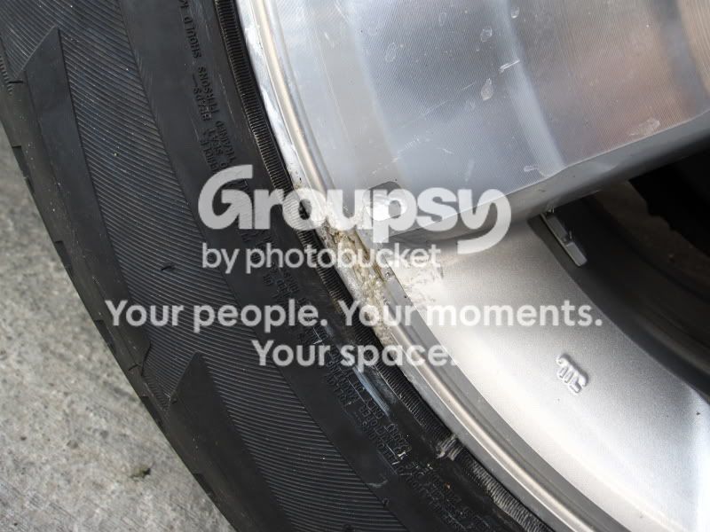

Call them up as I'm driving home, they want me to come in tomorrow morning. Fine, I can deal with that. When I get home I take a look at my wheels. 3 of the 4 have big scuffs where they removed the weights that were on there previously.
Is this normal? I mean it looks like someone drove a flathead screwdriver under the weight with a hammer, and then wrenched and pried on it to get it off. Or is this just how a wheel should look when a weight is removed and placed elsewhere on the wheel? Some of the marring looks like it would be normal, but there are other areas that definitely look like they were scraped. I always take extreme care to not screw up the finish of the wheels and they get cleaned and babied as much as the rest of the finish.

My take is they damaged your wheel. And I would demand a brand new replacement. I bet they carry insurance for employee caused damage. I would not let that just pass by.:sniper:
There will always be some level of damage from where a clip-on wheel weight was on the wheel, but that first pic looks like they really marred up the wheel when removing. There's a tool designed just for removing wheel weights without damaging the wheel. I doubt they used it on your wheels.

All the 4Runner wheels have a lip to accept hammer on weights. Unless you specifically ask for stick on only, you're getting hammer on weights. You're going to get some small marks from the weight, but those look excessive. It looks like they used a weight for a steel wheel lip, which is typically a lot thinner, and tried to hammer it over the thicker 4runner lip.

Though, the difference between lip on a steel wheel and a Toyota wheel is VERY different, and as such the hook on the weight is very different. I can't imagine trying to hammer a steel wheel weight onto a Toyota/Honda wheel. That being said, I'm sure there's idiots out there who try.
There is usually some damage caused by the installation of hammer on weights, but it's usually just on the lip (towards the tire where the hook attaches), not on the wheel face. As stated, there's also a tool used to pull hammer weights off without damaging the wheel that is 99% effective. The damage I see in the OPs pics is excessive and abnormal damage to be caused by removing the weights. I'd be pissed.

anyways it is pretty normal when removing weights for it to scratch the wheel but not that bad, there is a specialized tool we use to pull them off the lip and the only marks it might leave is just dirt and debris that got in there and the difference in color b/c that was hidden from the sun for a few thousand miles. sometimes we might put a small light scratch on them, nothing big, but that is rediculous, i know toyota has to have the tool we have but seriously they must have put the wrong weights on it when they previously balanced it for you because there are 4 different types of lip weights, MC's, TW's, AL's, and then the ones for steelies. all 4 have differnt size clips to correctly attach the the correct wheel, some wont come close to going on, and some go on too easily, my guess is whoever balanced your wheels before put the worng clip on (one that was obviously too small of a clip for the lip) and they beat the hell outta it until the thing went on, (to put them on we use a plastic/rubber hammer so if you miss it wont damage the wheel.)
if i were you i would most definantly go to the place where you last got it balanced and tell them, you might definatley need some documentation, but that is pretty rediculous that they did that, you would think the guy that did it would realize that it didnt fit and would stop and ask his manager, (what we call the service coordinator) before continuing to ruin a customers wheels.

While I expected some amount of corrosion on the wheels K.C., my photos show freshly marred metal beneath the finish in photo 1, and cleanly scraped paint on the other two. Photos 2 and 3 show some corrosion, while photo 1 does not.
The finish on all 3 of them look gouged where they took off the weight.
