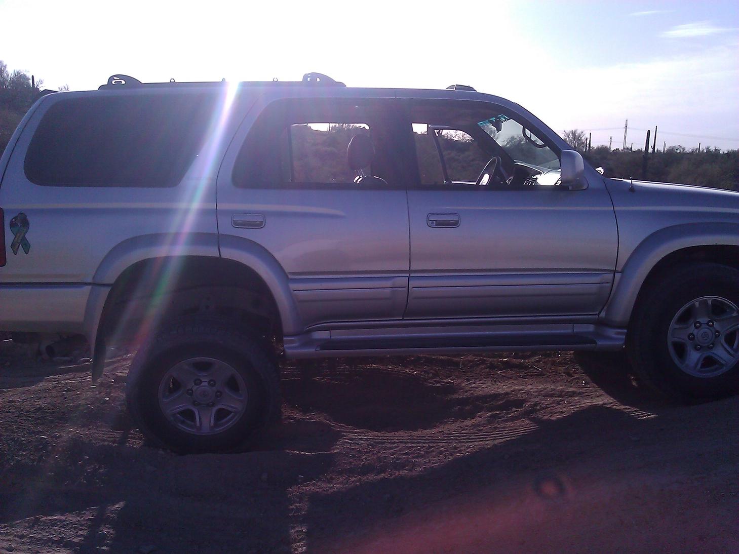

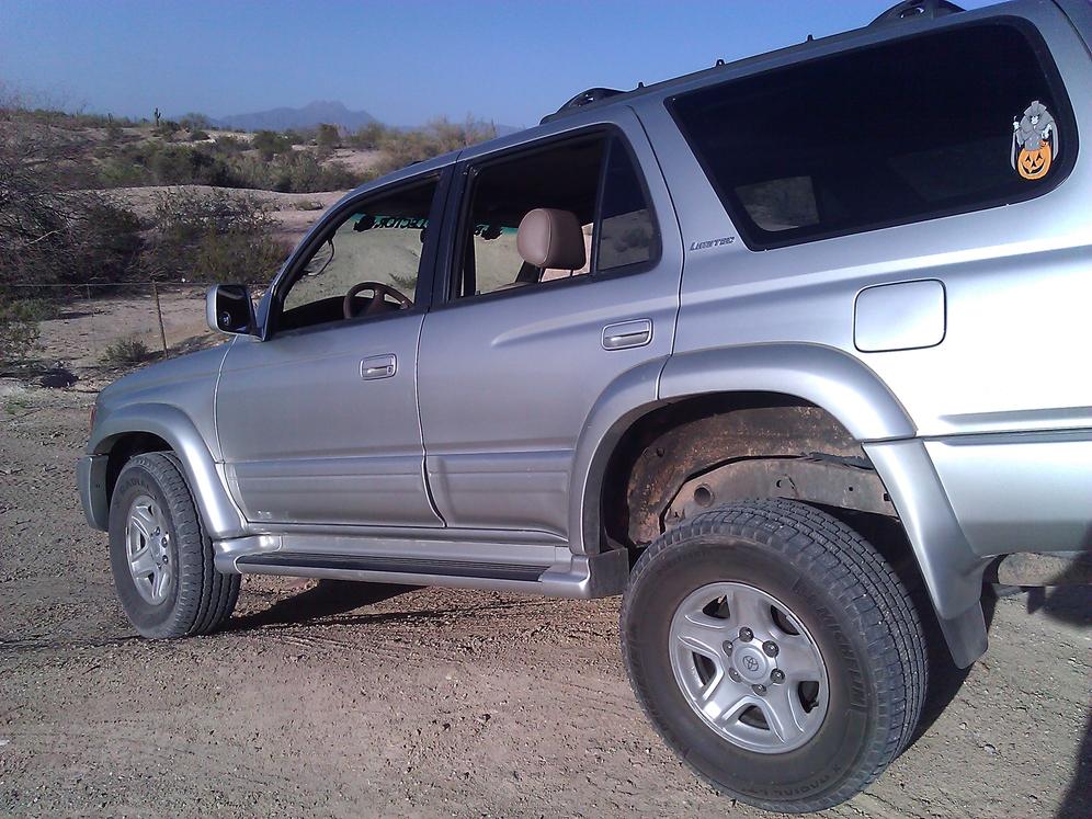

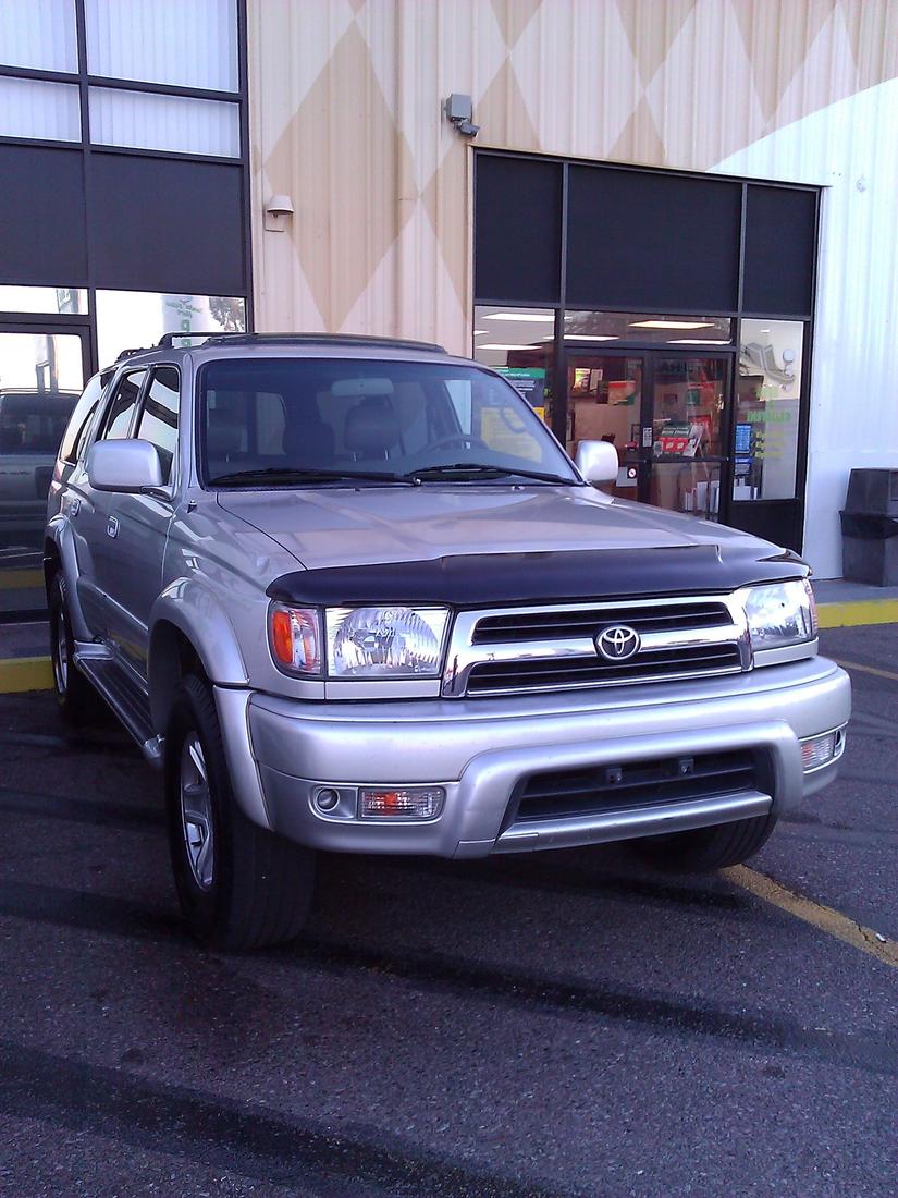

Its a limited Push button 4wd. to add it will not shift back on any surface, like its stuck in 4wd. And here are some pics for you guys:)
