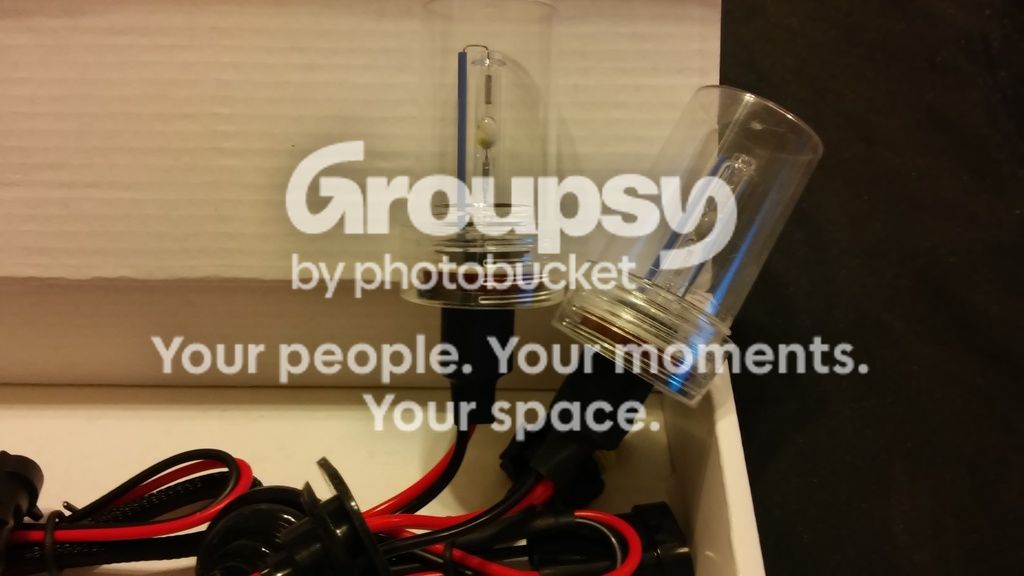

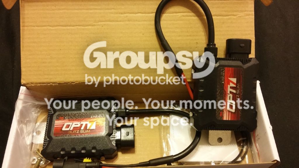

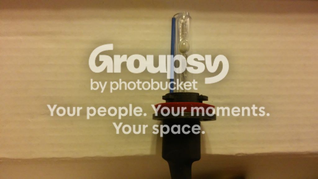

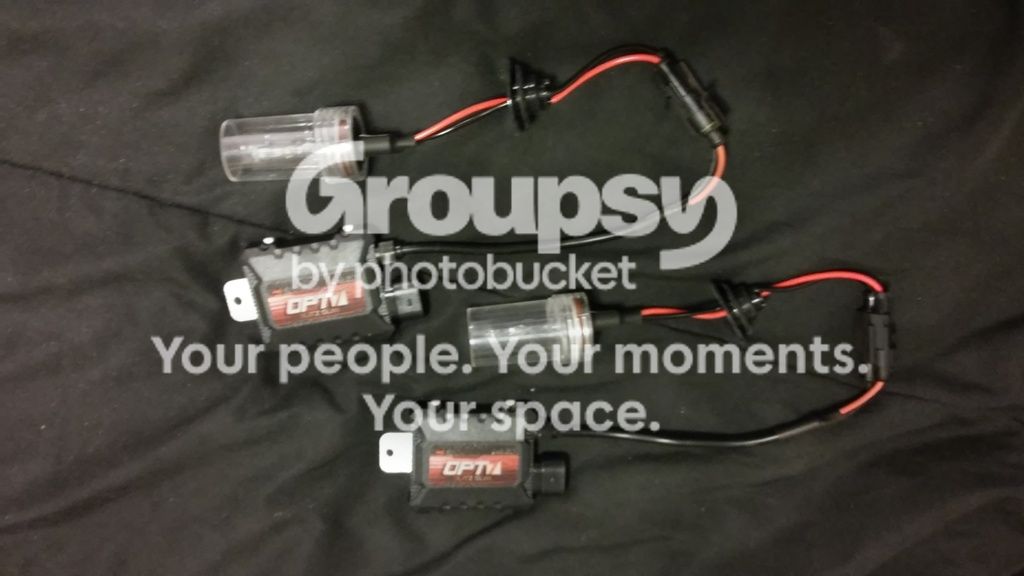

No... You're okay bro! I have the OPT7 HID kit in my 2012 L.E. and it works better than I could have imaged! And yeah, the driverside HID lamp failed to start-up on two different occasions. At first I was pissed about that because I was so very happy about the install and performance. But it turned out to be just a mis-fired startup. Because the cost of the kit was such a bargain (at $33.00 bucks complete), I picked up an extra kit just to have in case I need to make a repair while traveling at night, so I keep it in the cargo area but it never happened again!
http://www.toyota-4runner.org/2275076-post1.html
OPT7 35w Xenon HID Kit Slim H11 6000K Blue Beam HeadLight Conversion Light | eBay
...the bottom line is you either have a borderline bulb or questionable Ballast! It might be worth it to carry an extra kit just for the spare parts in an emergency! 'Best to you',

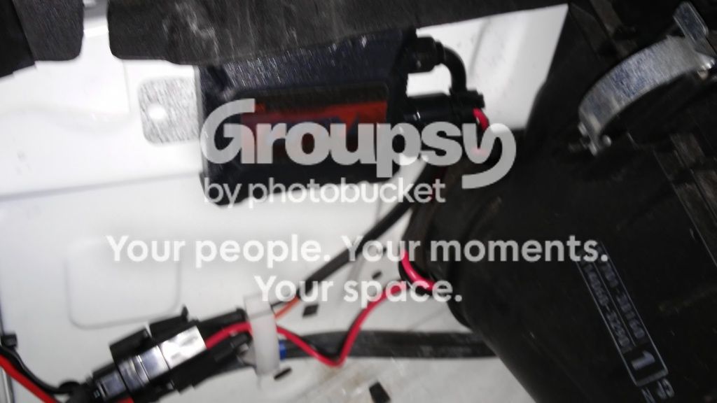

Just installed my HID's the other day. Mine did not like being connected to the negative post on the battery. I had to connect mine to some screws in the engine bay that were marked "E". Solid connection once that happened.
