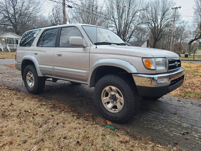

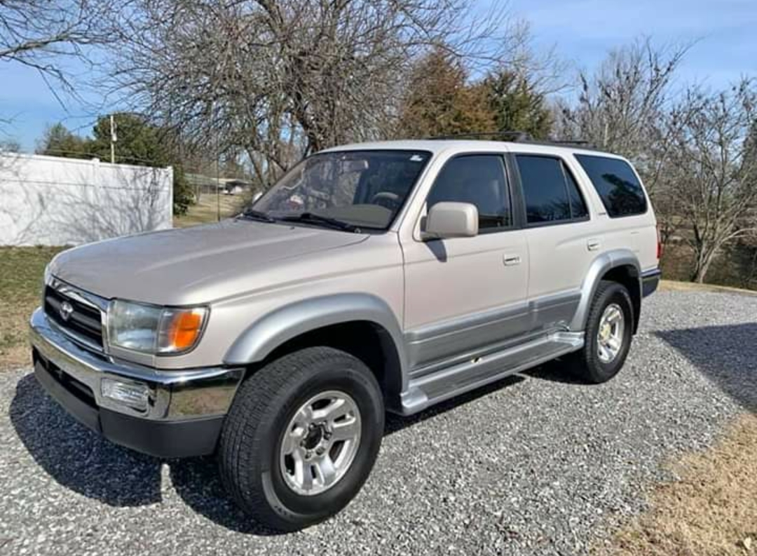

Purchased in late February for $3,500 from a local seller. Picture below from the ad on Marketplace. Wasn't the first person in line by a long shot, but the first person with cash in hand.

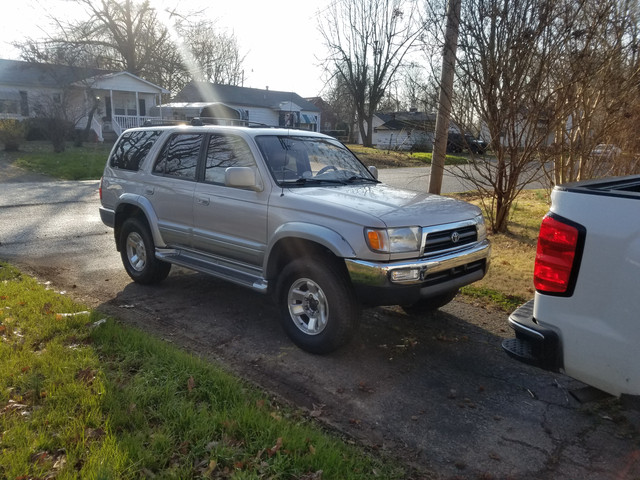

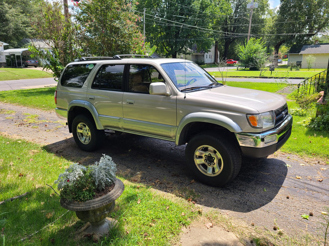

Shot of the first day I had it in my driveway, realizing a childhood dream of owning one of these. The excitement was real!

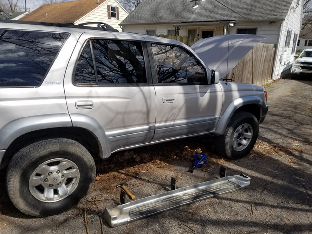

Obviously, the internet said the 4Runner looks better without the steps, and the internet can never be wrong right?

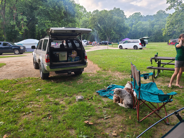

Since then its been all maintenance and other wrenchings. We did find time to do some camping! She's going to kill me if she see this...

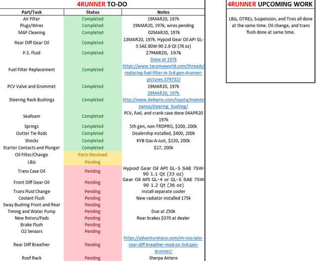

Below is a snapshot of the maintenance that's been done to date. The plan is to update this post with a screenshot instead of typing it all out. I've had a request to make the spreadsheet available for someone else to use. If you'd like one let me know! I can send one over.
Of note, ordered the wrong damn LBJs from Camelback, and they wont accept the return to get the right ones. Those will be on order soon.

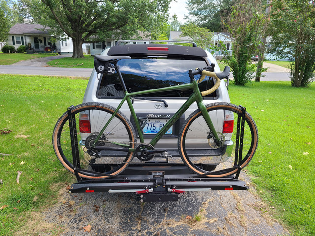

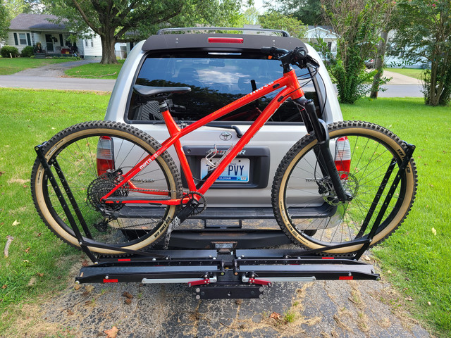

One of my other, more expensive hobbies is biking. I settled on the 1Up super duty rack, in black, double carrier. If you're in the market just do yourself a favor and get this. It's pricey, but it looks so damn good and is stout! When I purchased the rack I got the hitch lock and 2 wheel locks for peace of mind.

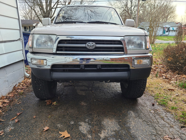

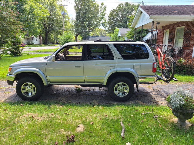

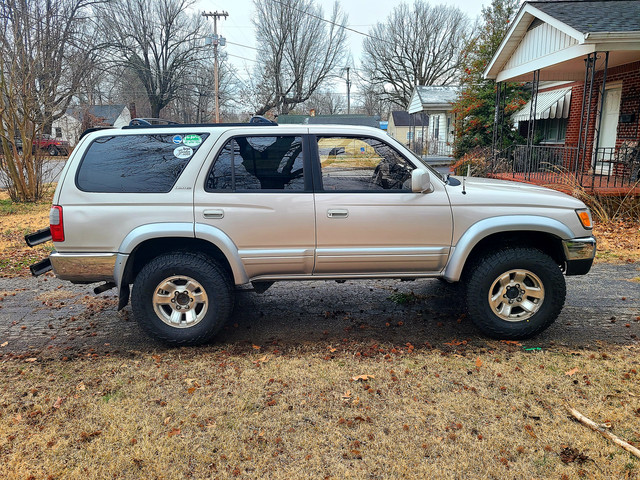

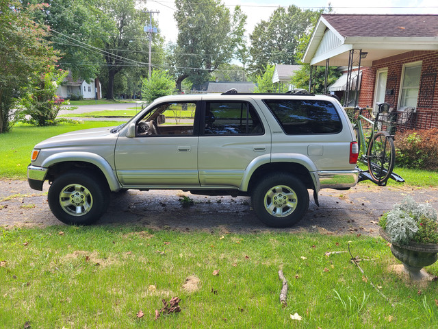

5th gen springs with KYBs installed. Raised the rear up a good bit, the front about an inch or so.

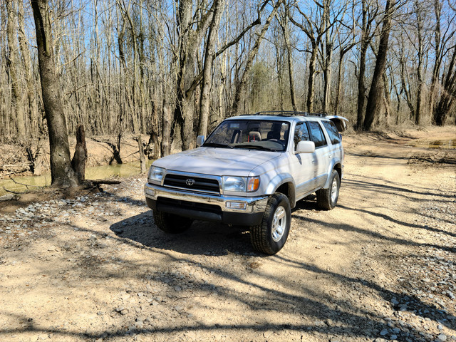

ATW/3 tires in 265/75r16 installed today, 08FEB21.

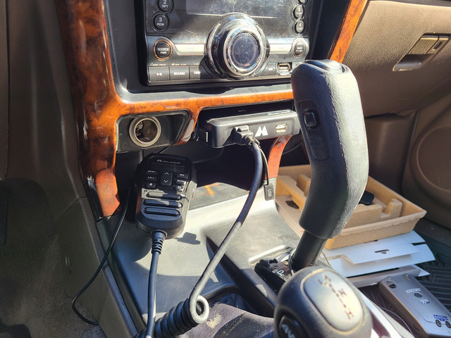

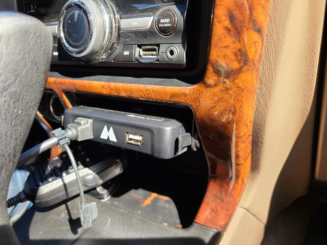

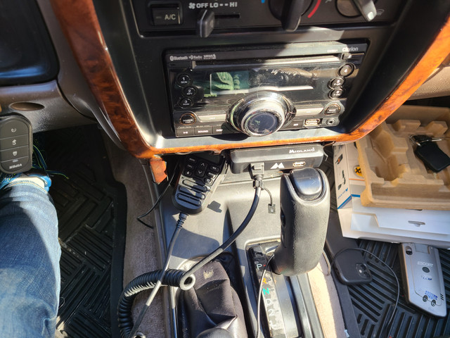

Got my MXT275 wired up. Used an Add-A-Fuse on the Wiper fuse. The only blank slot I had didn't get any power at all. Found a ground via a bolt holding a bracket on the left kick panel, no idea how good of a ground it is but it works for now. Using a 4A fuse on the radio just incase.
Ignore the mess.

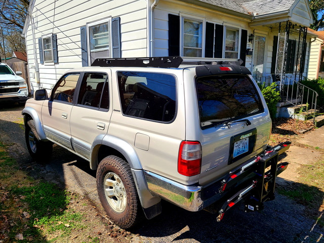

Sherpa Antero installed!

Yes it was a straight swap. Front is the most straight forward, rear actually took much less time though oddly enough.
Here's what it looks like today. Just had some 265/75r16 tires put on.

I did, yes. I can go outside and measure the hub center to fender if you'd like.
If you could when you get a free moment that would be great! I am in no rush for that number. I need to thaw my truck out before I can take some initial numbers. Its a frozen heavy pig right now
thanks for posting those numbers, thats where I would want mine to sit, thats about a 2 inch lift, I did a 3 inch on previous 4runner, and now not sure I need that much. plan on doing new springs/shocks this spring. See you ran KYB's. Did you get 3rd gen specific KYb's or did you have to bump them up to 5th gen also ? How is the ride ? Are the 5th gen 4runner springs progressive ? WOnder if they will take the weight of an ARB up front and not sag too much ?
thanks
thanks
I believe I got the KYB 3rd gen specific springs. Ride seems fine to me. This is my first "lifted" vehicle, all of ky other vehicles have been lowered or kept stock. I have no idea if they're progressive. There's a thread somewhere on here that goes over the 5th gen springs and they might have found that out, just don't remember. I'd think it might sag a little. What does that bummer weigh?

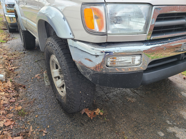

Got into an accident a few weeks ago. Another car failed to yield at a stop sign and clipped his front bumper with my front bumper. Impact wasn't sever, but hard enough to shift the battery forward and snap the grounding wire.
Doesn't look bad, however the shop quoted my 2200 to fix. And that's just the body work, brackets, bumper, etc. The front tire is toe'd in, steering wheel has a good bit of play, and tire rubs now when turning in any direction. Was found not at fault earlier today and dropping it back off at the shop on Monday.
Glad no one was hurt in the accident! Hopefully the suspension/steering won't be too much of a pain to fix.
Are you thinking of going aftermarket with the bumper now? Did you get a chance to look at the mounting points to see if they were bent at all?
I dont have a need for an aftermarket bumper, just going oem. We'll see how bad the damage to the suspension components and steering gear are when they tear it down.
Got my Sherpa Antero rack in today. Total wait time was under their estimated time so I'm considering myself lucky. Kinda anticlimactic putting it on a vehicle I can't even drive right now, but I really like it! While it's in the shop I'll be on the hunt for used Pelican cases to put on the roof to hold camping equipment and a small bit of recovery gear.
