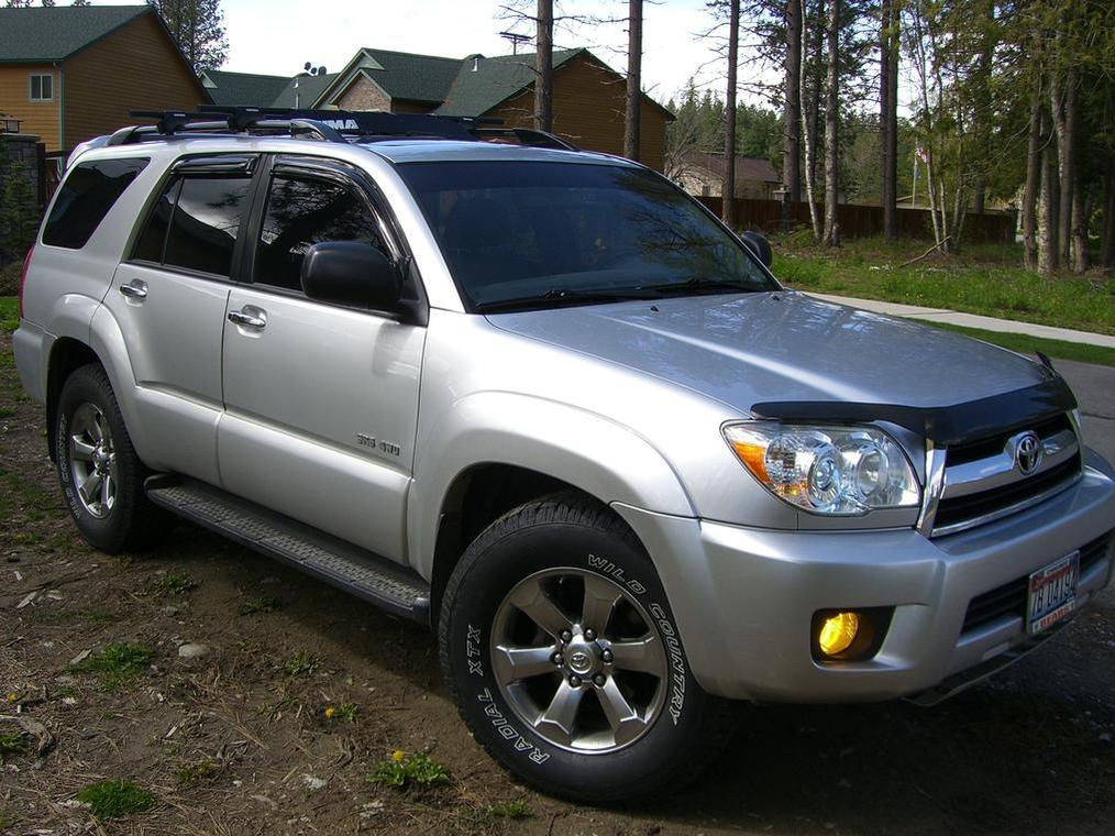

I have the 9006 Putco Jet Yellow in my Fogs. I love them. They are fantastic in the rain too.
Those look a lot better than the ones I grabbed off ebay, I think I'll grab a set next time the cash is laying around but for now, it's saving up for other t4r stuff :)
