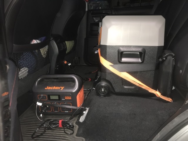

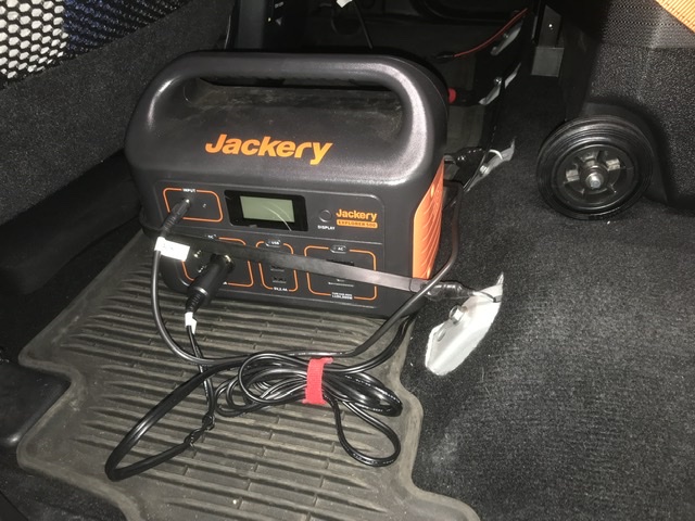

I remove the rear seat bottoms with just the two of us traveling. Rear seat backs are up. Ratchet strap the fridge where the bottoms were. The Jackery sits on the floor behind the driver with a rubber truckers strap holding it in place.
If we sleep in the back I have to move the fridge to the front passenger seat for the night.

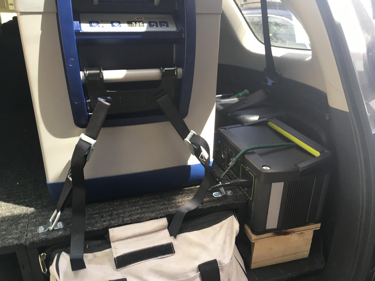

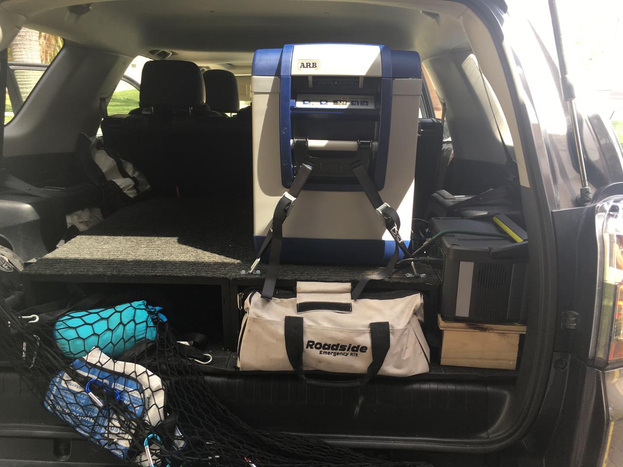

Made a platform next to our platform for our Yeti 400Lithium. The platform is hollow underneath for all of the wires to tuck away nicely. It now sits in the last configuration as I have since wired an ARB plug for constant power to the fridge (now on a fridge slide) and the Goal Zero is just back-up power. I could usually get about 18-24 hours of fridge runtime on the Goal Zero for our 50qt ARB. Now as a back-up it is perfect.

My Jackery 500 is strapped in front of the fridge, between the fridge and the back hatch. This allows the fridge to run from it, the Jackery to plug into one of the various charging ports I have back there, and also access to the Jackery to plug in anything that needs to be powered when in camp. Can also plug in the solar there as well for recharging.
I thought about putting it behind the fridge, between it and the rear seat back, but decided that was silly for access while camped when the back hatch is already open.
