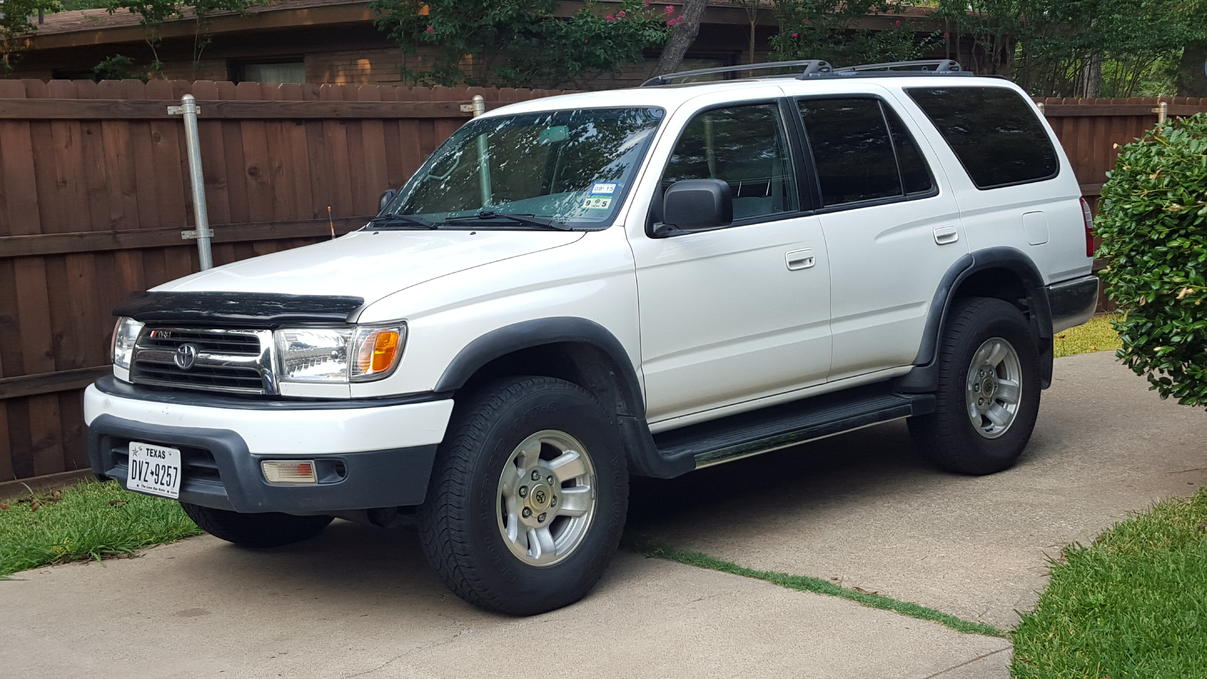

I Should have called this thread a refit not a build as I'm not going to lift it just return it to its original stock state. Heres my 99 T4R. It's a 2 WD and now has become my daily driver. I originally bought it for my son but because there was a lot to do on a 16 yr old truck he asked to take my Altima. He's in college and doesn't have the time to do the wrench work. uploadfromtaptalk1440977622626.jpg

Heres my 99 T4R. It's a 2 WD and now has become my daily driver. I originally bought it for my son but because there was a lot to do on a 16 yr old truck he asked to take my Altima. He's in college and doesn't have the time to do the wrench work. working on this T4R is addictive! I really don't have a lot of automotive knowledge and use a lot of the information from this site!
Now let me tell you that working on this T4R is addictive! I really don't have a lot of automotive knowledge but I have staying power and like a challenge!
I also have enjoyed and used a lot of the information from this site! The members here are awesome and I can tell have the additiction as well. More to come...
