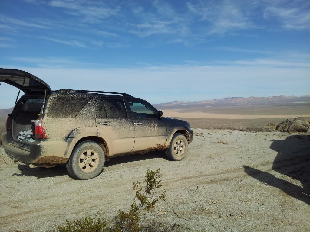

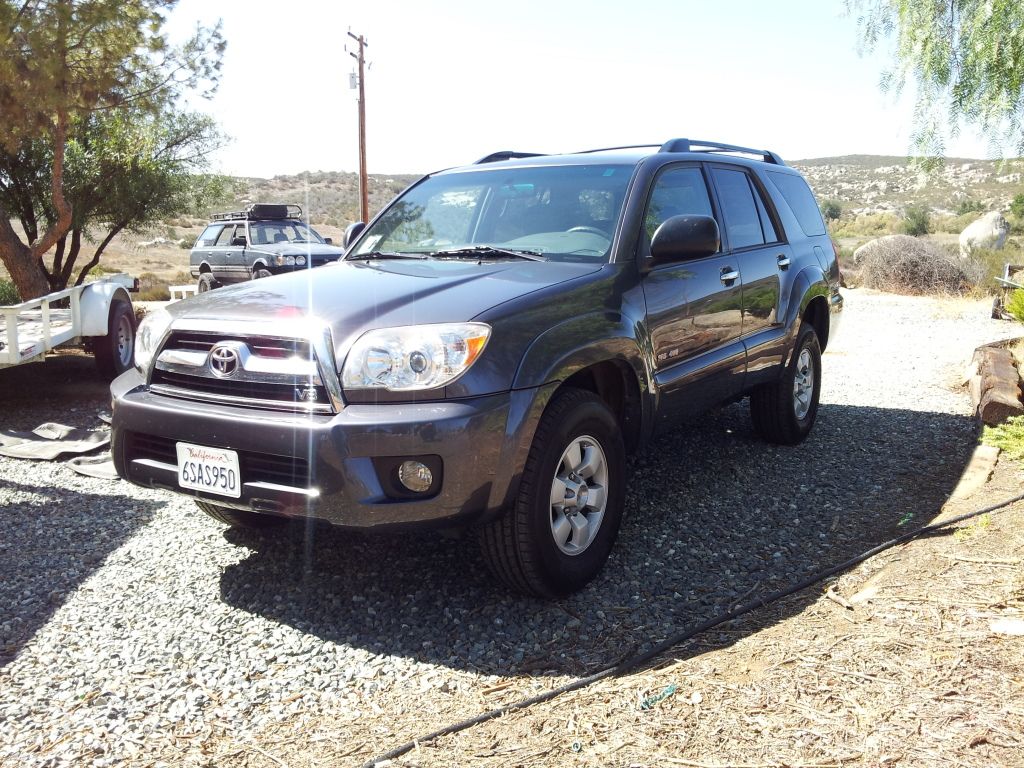

The wife and I purchased our 4Runner just under 2 months ago. With a new baby on the way we knew our Subaru Adventure Mobile was going to be too small for 2 adults, 2 children, 2 dogs and camping gear. I have always liked 4Runners and since Subaru does not have a decent mid-sized vehicle I was able to talk the wife into a 4Runner.
Our search began in early October. After chatting with some friends and lurking around the internet we decided on a 4th generation with a V8 :lookout: After narrowing the search we found ours at a relatively close dealer and brought her home that night.
Home on the range
The 4Runner is replacing my highly modified and capable Subaru. Stock 4Runner certainly leaves a bit to be desired in offroad performance.

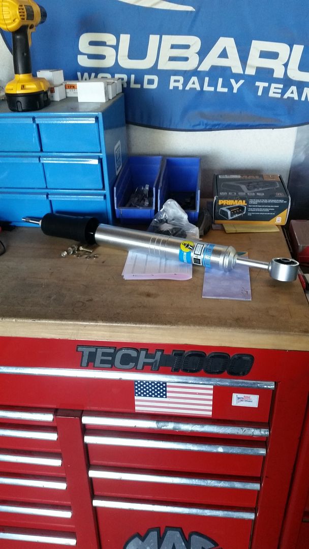

-Bilsteins installed f+r

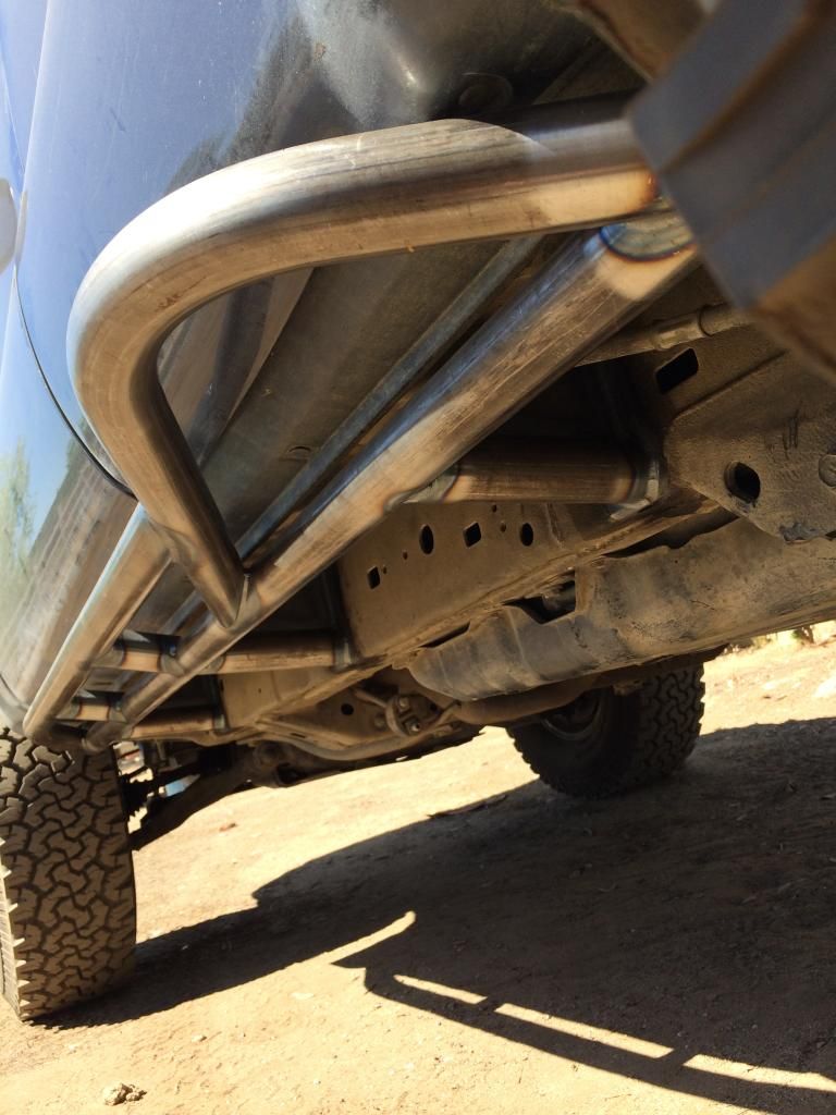

-Jackson Rally sliders

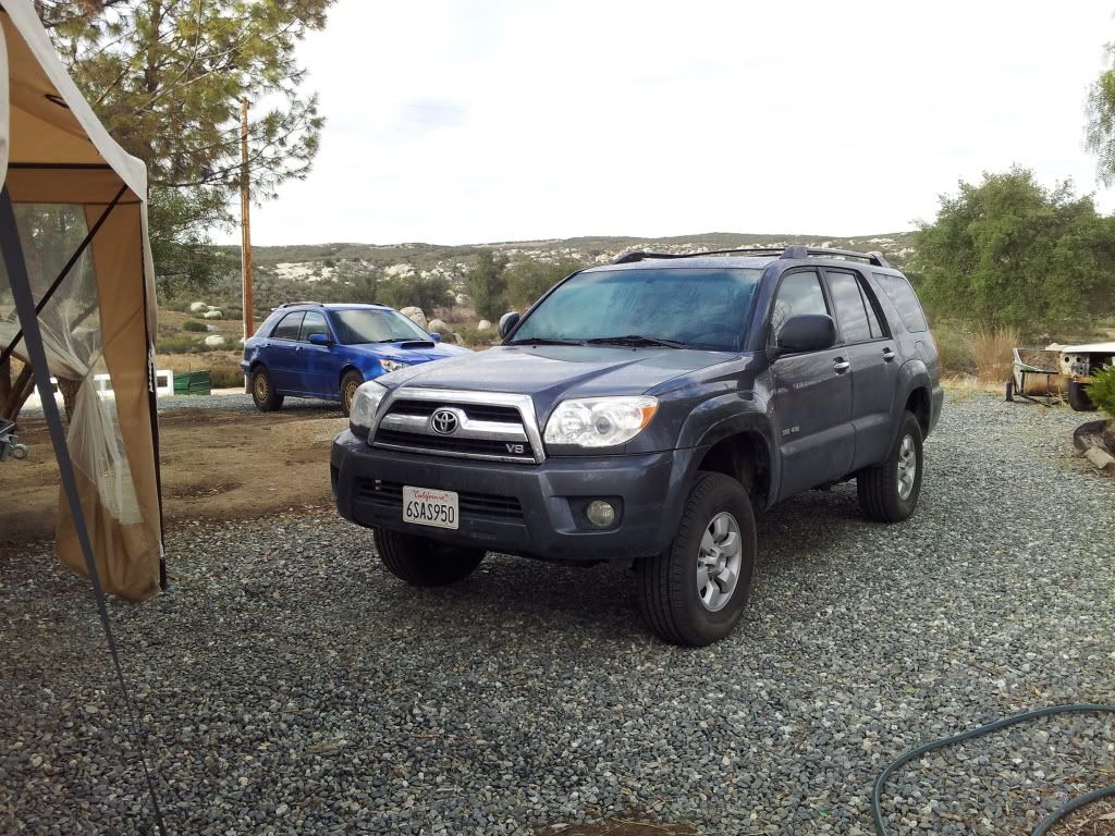

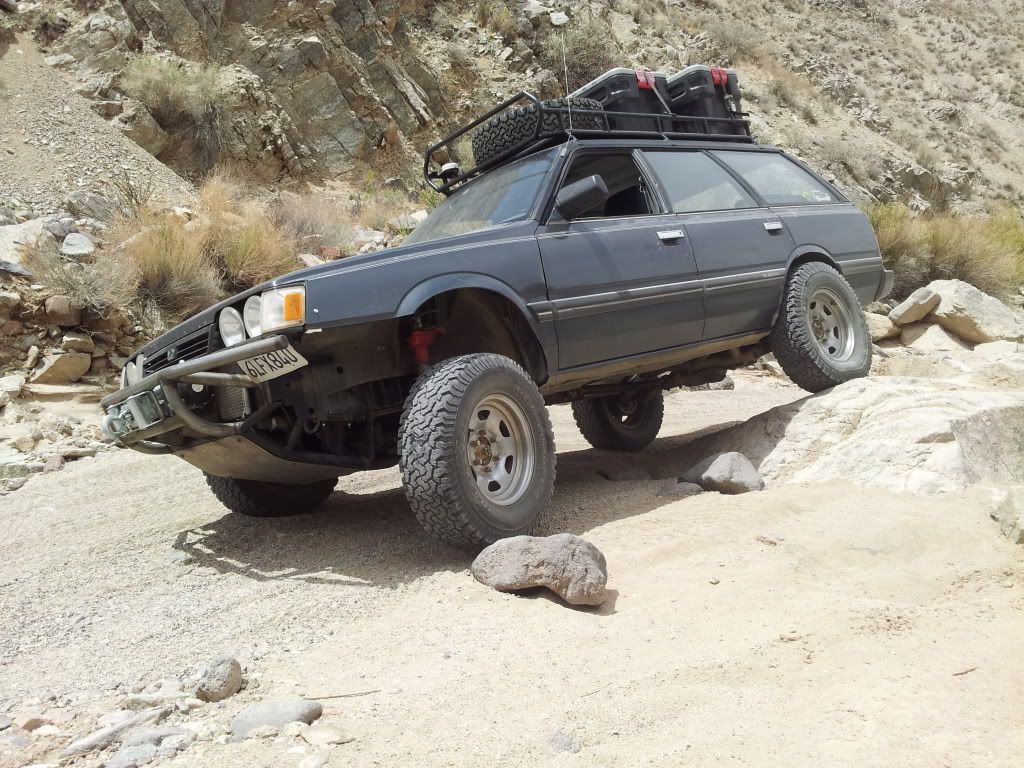

Subaru Adventure Mobile it is replacing (for sale!!!)

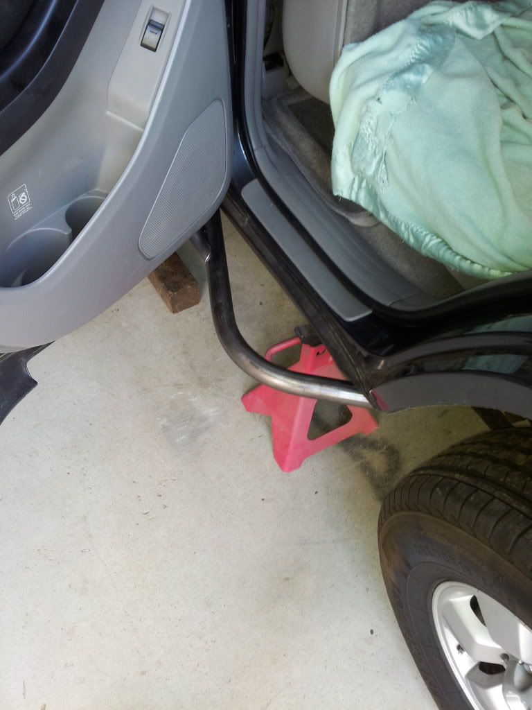

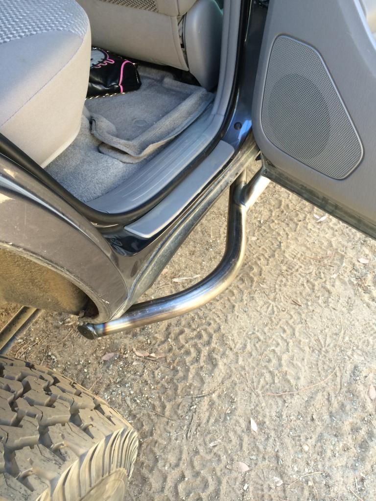

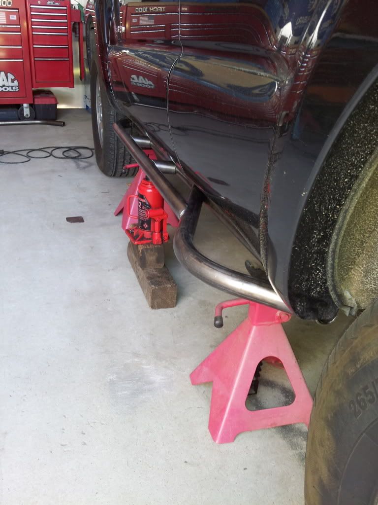

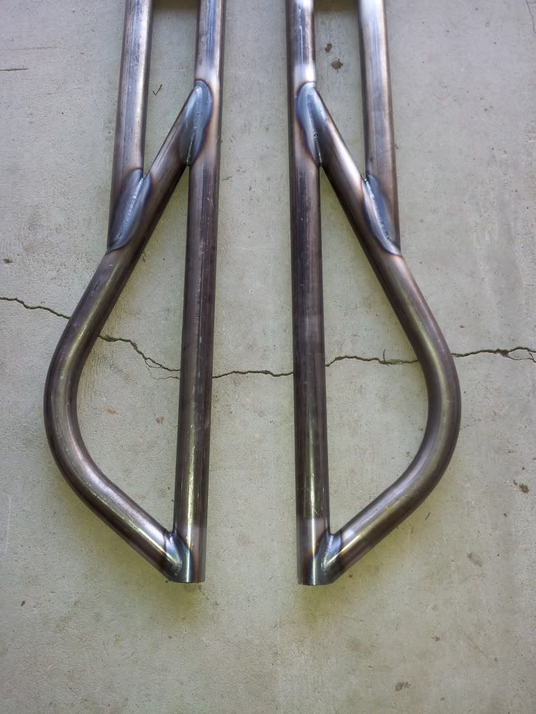

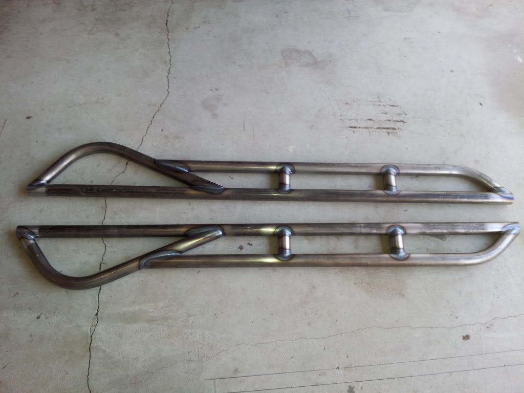

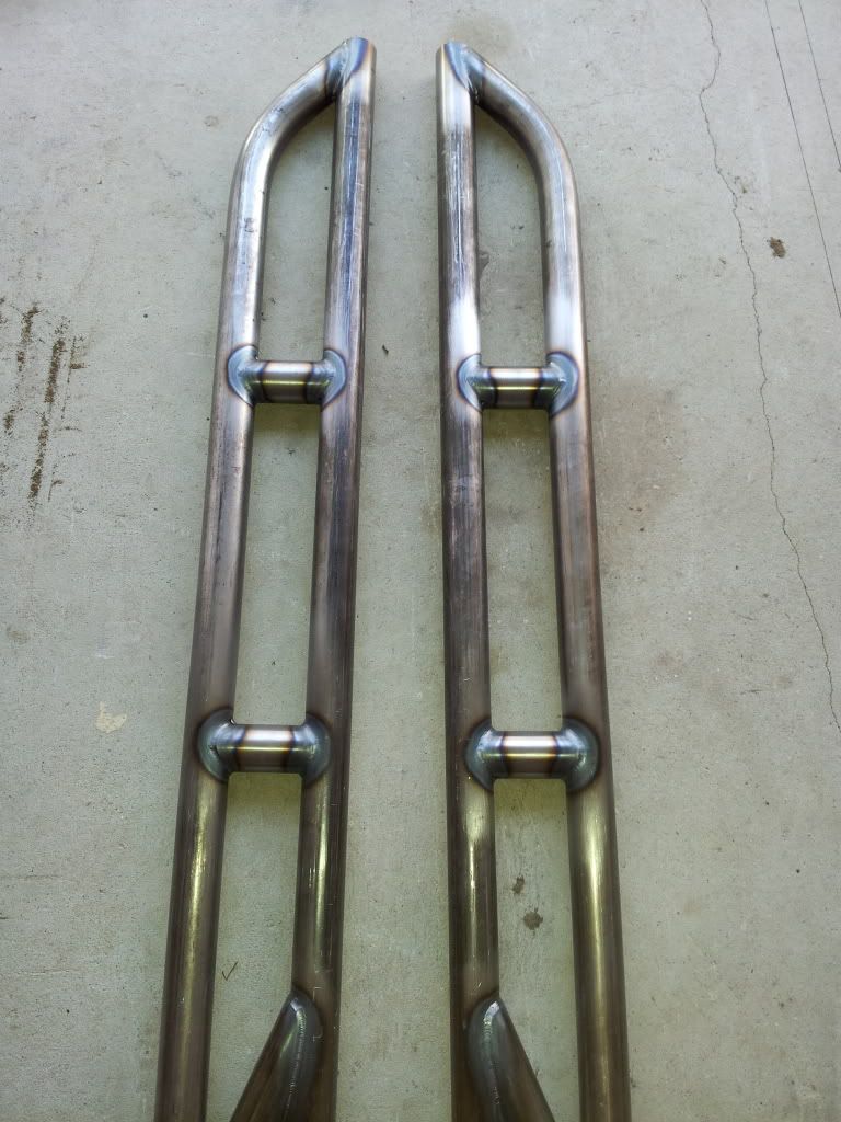

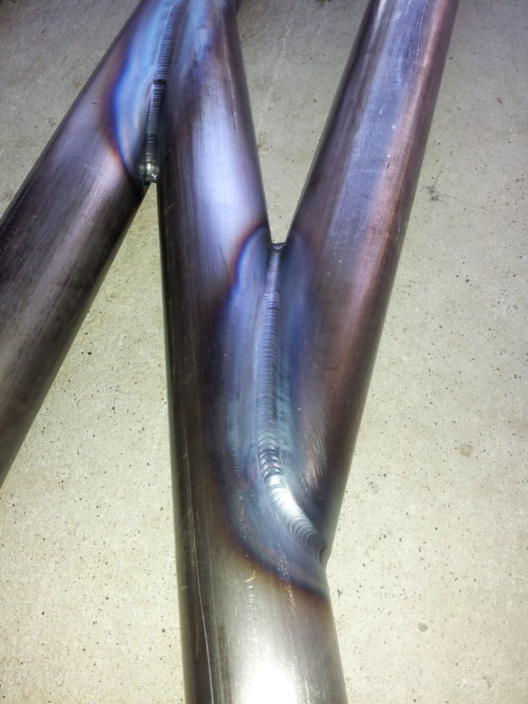

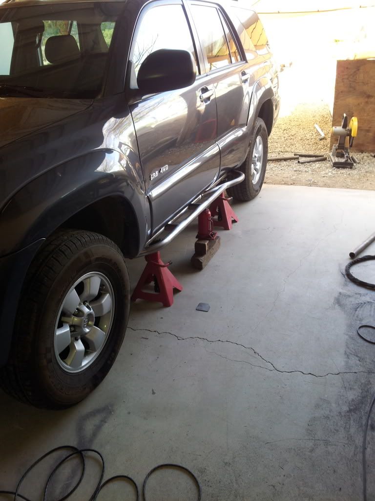

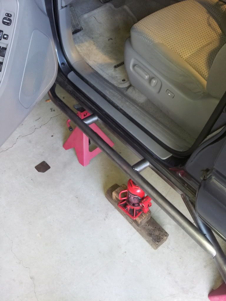

Sliders I built (I will weld on after lift and real tires are procured)

I may weld them on here pretty soon. Then I can make skids. Tires will have to wait til next year.

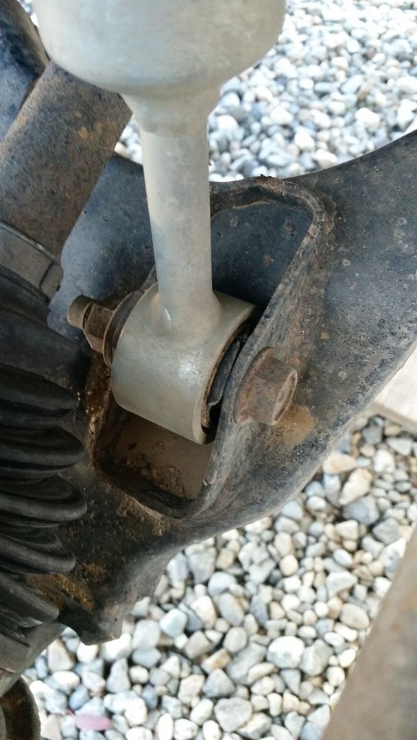

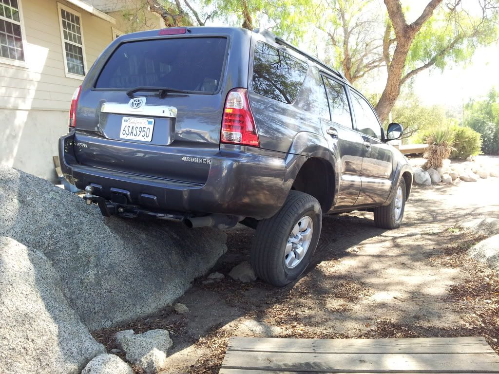

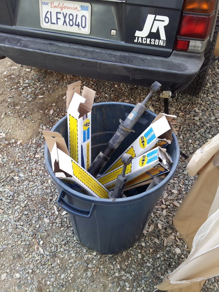

Almost forgot, I removed the front sway bar. Not a big fan of them anywho. And cut the tops off the old rear shocks to weld to the rear sway bar end links resulting in longer end links and the ability to use all of the travel the rear 5100's have. Its not much more but it is there for the taking.

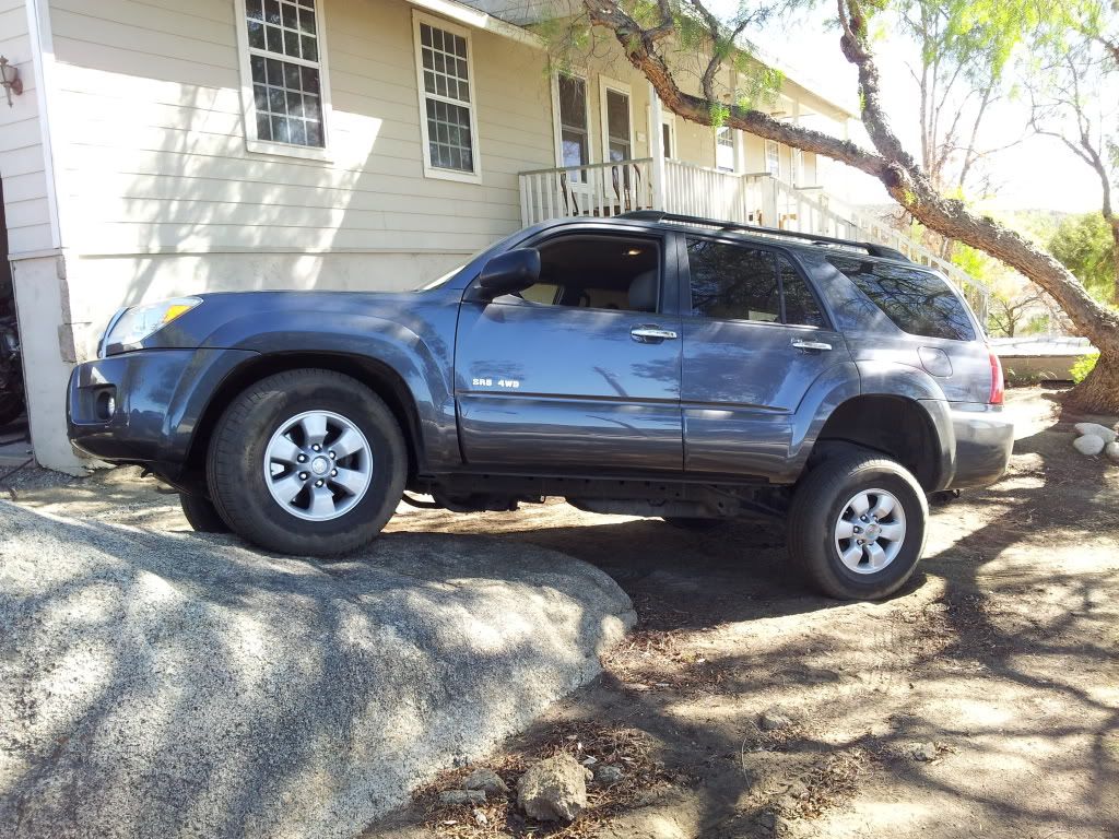

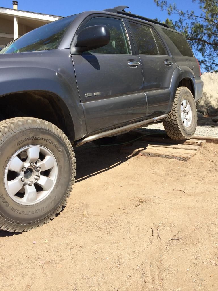

Ok so after installing the Bilsteins and removing the front sway bar I think the T4R is leaning to the passenger side. From my understanding the driver side springs are .250" taller to compensate for the weight of driver + fuel. So I think by removing the front sway bar this is now noticable. Whereas with the sway it would actually maintain a level stance...thats my theory. Im thinking the guys with proper coilovers (Icon, Fox....etc) and no front sway can maintain a level stance due to the adjustment available in the threaded shock body.
Thoughts!??
I think I might add a .125" spacer to the passenger side and see what that does.
Thoughts!??
After removing mine I noticed that it did that too. most people use a daystar 1.5 spacer and put it in the drivers side rear coil to level it out.
I meant to measure wheel gap before pulling apart the stock stuff. I did measure after and there is 3/16-1/4'' difference. So I think with .125'' spacer that will give me back 1/4''
