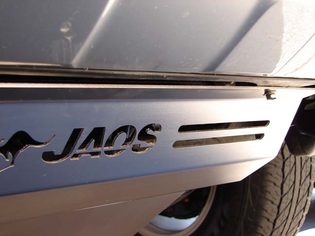

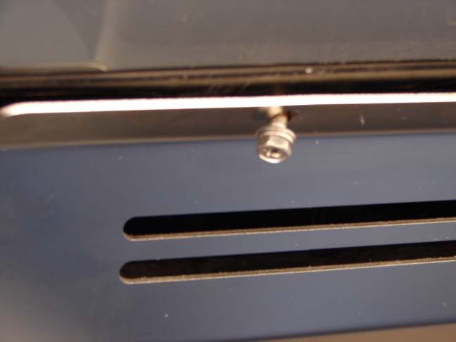

Anyone else having or had trouble fitting the JAOS Skid Plate on the 4Runner? I get every mounting point to fit except the two front screws together. I tried everything. I even tried removing all of the screws and bolts and just mounting the front two screws. They just don't line up with the holes at all. See pics.
What you see is that the right screw sits in perfectly. The left screw won't even thread in b/c there isn't enough space between the holes. That's why it's sitting at an angle.
i didn't have that problem. I also noticed mine was a some what an oval hole. Your gonna have to take a dremel to it and widen that hole. from side to side. I don't recomend enlarging it to a bigger hole.
I paid a lot of money to dremel that skid plate. I'm working with Burtman to see if we can find a resolution before I resort to that solution. Thanks for the advice though.

So here's the situation, Burtman has been in contact with JAOS USA and they have been in contact with JAOS Japan. Here's the solution JAOS has come up with:
"They said according to their experiences, Toyota does have some tolerances on the factory front bumper and the tolerance is 4mm (less than 1/4 of an inch) and for those customer who are so lucky (or so unlucky) to have those bumpers, they need to file the holes a bit to make it perfect."
Files the holes. That's there solution !@%!@# :wtf: Based on this I'm never going to buy another JAOS product again. And for those of you thinking about it, all I can say is think twice before you decide. You may just be one of those "lucky" ones. JAOS has completely lost my business.
As a side note, this is in no way reflective of how Burtman does business. He was more than professional in dealing with the situation and even offered to take it back.
And for those of you wondering... yeah I'll file the damn hole anyway. But, that's just not the point.
