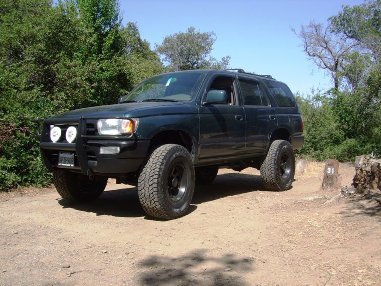

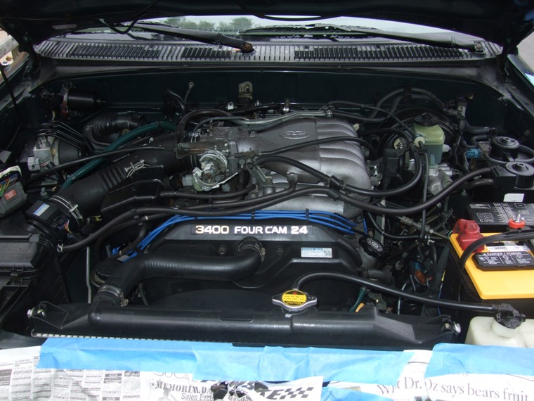

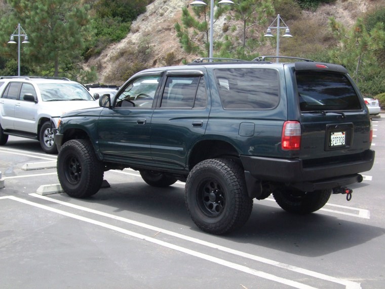

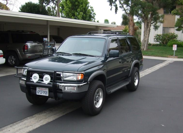

Anyway, thanks to this forum, here are pics of my rig as of today:
Now back to my original post:
I've become addicted to this forum while gathering advice for the 97 SR5 I recently purchased. Many members replied to my first thread and helped me a great deal. A few even requested pics and suggested I should start a build thread, since it's a better way to exchange info and gather advice.
And here's a pic of my rig the day I drove it home for the first time:

Upgrades/mods/maintenance I've done
These are the upgrades/maintenance items I've done since I bought my truck in late March, and I've posted some pics/details in my thread:
1) Installed Sonoran Steel 1.2 Alternate Kit
2) Replaced LBJs, UBJs, and inner/outer tie rods
3) Used Denso plugs and NGK wires
4) Flushed the tranny
5) Rear diff service
6) Replaced the left front CV, which was cracked
7) New lower control arm bushings
8) Rebuilt and rebalanced the front and rear driveshaft due to poor maintenance by PO
9) Replaced rear axle bearings and seals
10) Replaced both my front and rear brakes (Did this before I knew about the Tundra brake upgrade, so I'll eventually do this)
11) Installed Hankook Dynapro ATs 305/70R16
12) Had my Ultra wheels powder coated a semi-gloss black, which looks great
13) Installed Energy Suspension sway bar bushings
14) Installed Duralast Gold battery
15) Installed B&M tranny cooler
16) Upgraded dome and cargo light to blue LEDs I got on Oznium.com
17) Removed running boards and cheap wheel flares installed by PO
18) Plasti-Dipped the emblems
19) Replaced passenger door cuz of poor body work performed by PO
20) Aligned suspension and balanced tires
21) Installed new toggle switches for running lights and extra radiator fan
22) Installed Ultra-Gauge, though I still need to calibrate it
23) Replaced my torn up armrest with one from a 2000 Isuzu Rodeo
24) Had a pro electrician rewire most of my truck, including lights, stereo, and problems with dashboard
25) Swapped all speakers and tweeters for Pioneer
26) Painted my floormats black
27) Taco Whip Mod
28) Replaced missing plastic clips in doors and center console
29) Painted chassis/undercarriage
30) Painted front bumper, grille, rear bumper, and rear brake spoiler with SEM trim black
31) Reconnected AC clutch, so now I have a working AC just in time for summer!
32) Replaced my IAC to deal with inconsistent idle
33) Replaced fuel filter
34) Complete coolant flush and switched to Toyota red
35) Replaced A/C belt, PS belt, and alternator belt

Very nice!
That is one nice stock 'Runner! Very clean and the body seems in excellent shape! Almost NO rust and you got it for a song! (to me, that's a pretty stinkin' good deal for a 4Runner.)
In my personal opinion, those particular brush guards seem to detract from the overall look of your 4Runner... No offense to you or anyone else who likes them, they just seem a bit crudely put together/homemade looking. Glad you have an ARB planned, I LOVE mine.
Probably just me.

Very nice shape man! BTW, the paint color is definitely Evergreen Pearl, and those bumper signal lights, are after market. (I have the same ones)
