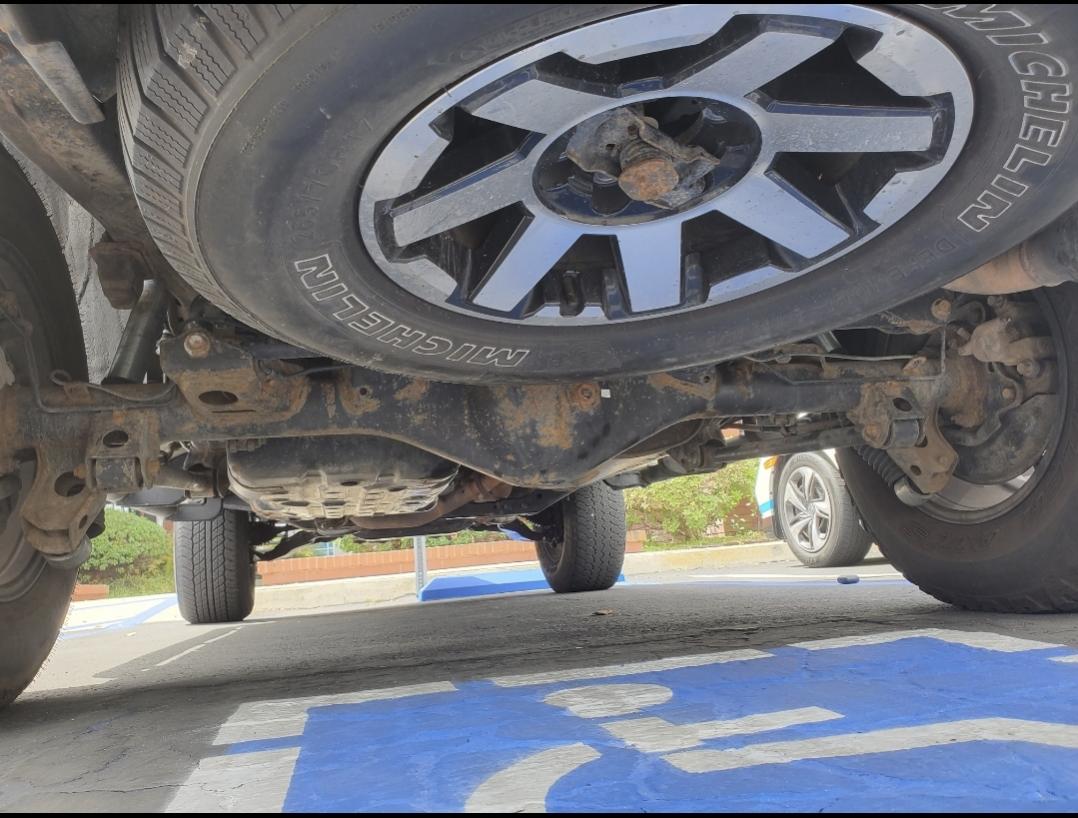

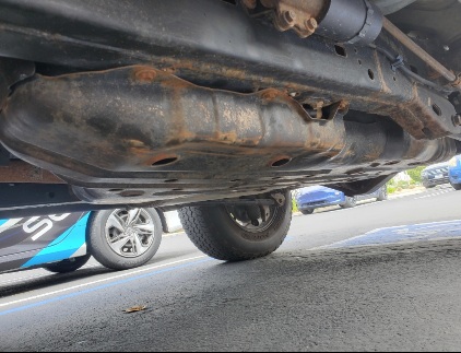

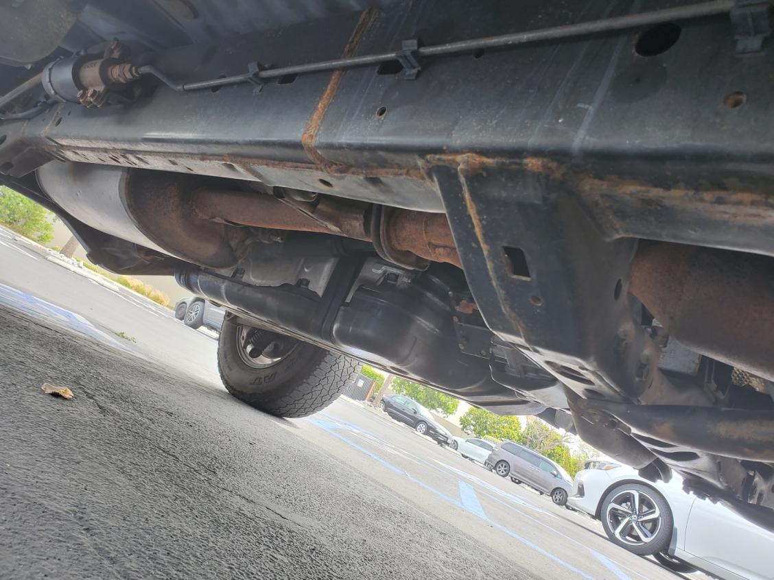

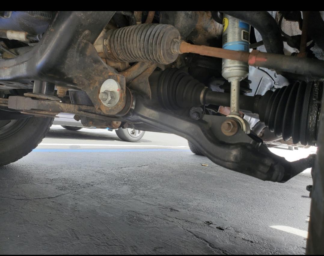

Hello guys so I have an 09 4runner v8 4wd with 229k on truck . I've been told that my rust is not bad just some surface oxidation but it's bugging me and I really want to take care of it before installing 3 piece RCI aluminum skid plates. I have been online and watching videos of ways to take care of rust and I think I might just go to town with wire wheel and brush then coat it . Posting some pics of my frame so I could get a general consensus of how bad it is. What are easy and inexpensive diy products I can use? I also want to know what's the best way to get into the frame crevices. I'm Not the best at mechanic work. Any advice would help since I'm planning to do this as a DIY project.

That's barely rust and yes, I would treat it with the method you are planning; wire brush/sand it, paint it over. You obviously don't live in the rust belt so that should take care of it.

I wouldn't bother wire wheeling or stripping, you'll just remove extra powdercoat or whatever Toyota uses as a frame coating and it'll take forever. I'd just use rust converter and then spray some fluid film or similar on top every winter and that will slow it down enough to last for 20 years in my opinion.
