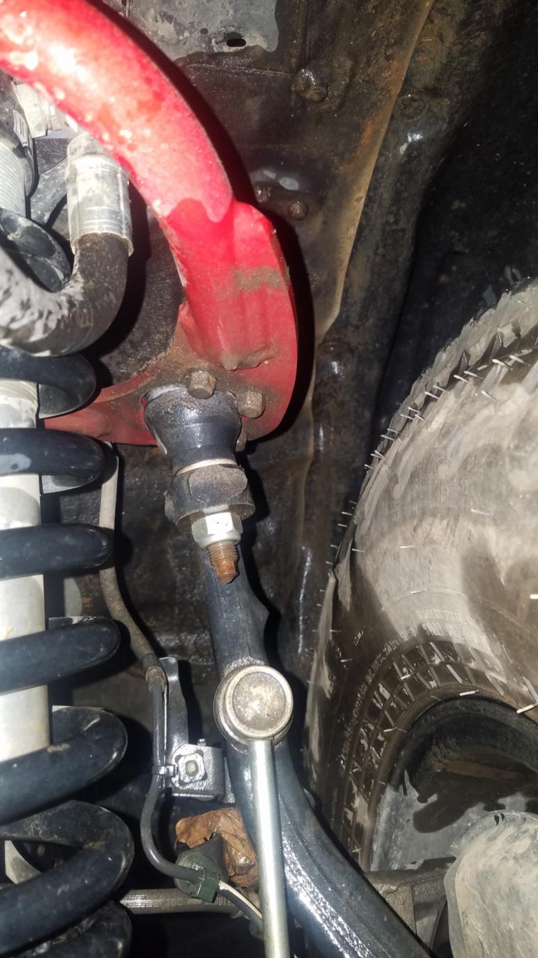

Yeah mine have that gap, what I thought was a tear, between UCA and boot. The boot slip was immediately evident once installed and the truck lowered off jack. Been functioning fine for over 8k miles. They've held up without issue but I thought that opening would be a concern.
*pic below, truck was filthy due to some offroad fun but you can see the gap.

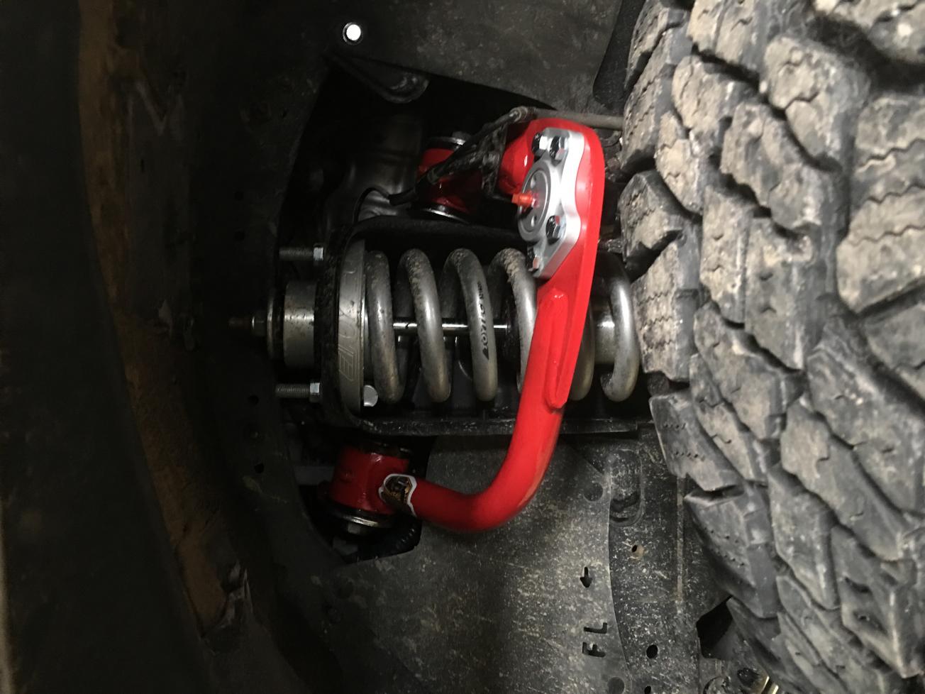

Installed the JBA UCA
Installed the JBA Offroad UCA's this week. Thought I installed them backwards being that there is no DRIVER SIDE or PASSENGER SIDE written on the arms, but after looking at everyones photos looks like they are installed right.
These are photos from my passenger side. I need to get a wheel alignment being that its pulling slightly to the left, plus i want a higher caster then 3.5. I swapped the Camburg balljoint UCA's out for the JBA's.
