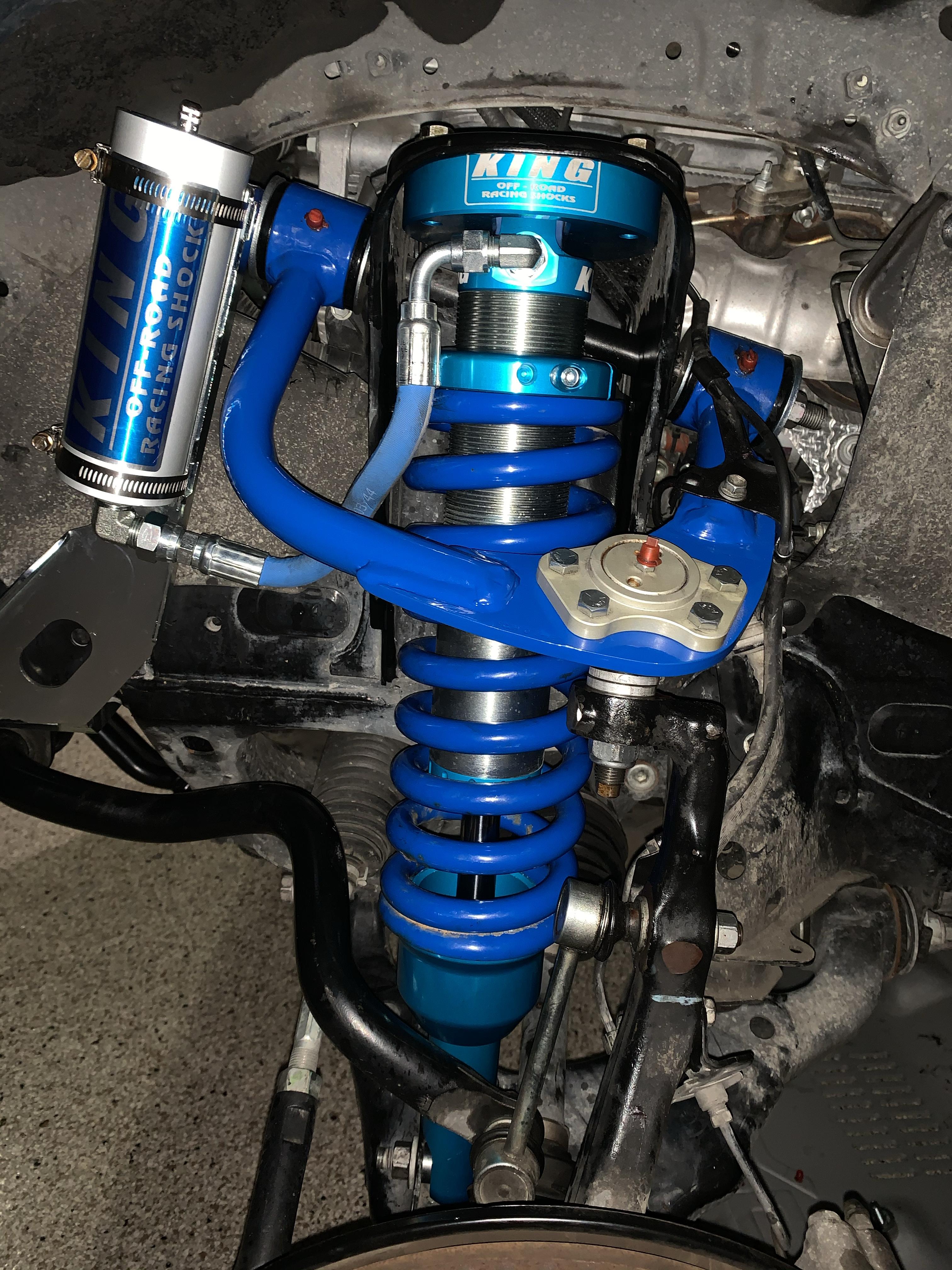

I didn't, I'm just playing around with the idea of it but I've had it off for a few weeks now. Doesn't feel awful due to the spring rate and valving. Can somewhat say it feels smoother due to the suspension actually able to work independently. I'll be able to really test it out this weekend finally.
I like them a lot. Pretty sturdy steering, no vibrations or jolts, much better bushings and nice knowing the uniballs is strong. Keeping them clean can be a pain but it is what it is.
Also, I'm running JBAs older design bushings where they're basically OEM style.
Anyone have any input if upgrading to their new bushing would be much better?
