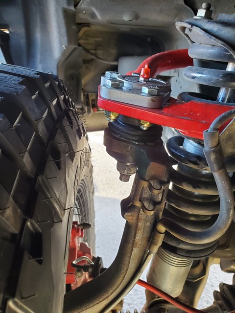

They have more clearance. Full droop with 315s and 16x8 4.5 BS wheels I still had plenty of room.

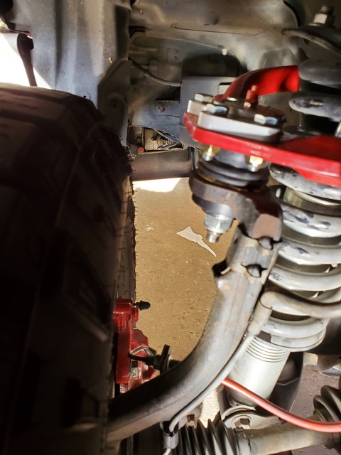

I’m currently running 275/60R20, and my tire comes within probably a half inch or less from rubbing on the UCA.
So you’re saying they actually sit closer in towards the spring bucket than the stock UCA?
I took a picture of what I’m referencing to if there’s any confusion.
UCA — ImgBB
I would of thought JBA would have made them to give extra space for bigger tires not less... However someone who bought them (albeit for a 02 Tacoma not a 99 4runner) said they came a half inch closer to the tire and therefore he needed spacers!? Was he just full of shit or what?

That tacoma person probably changed wheels or tires and that was the issue not the JBA upper control arm
Edit: Why are you wanting different upper control arms? If you're worried about the stock upper control arm rubbing the tire you have plenty of clearance in that photo.

With my JBAs I have more clearance between the tire and control arm than stock.

Great question! So for starters, I’m not worried about it rubbing now with the stock UCA, I’m worried about spending a bunch of money on new ones and them being different dimensions and interfering with the tire!
Now, I would like to replace mine because even though they look OK, I know they’re original going on 350,000km. The upper ball joints are also original and with my lift over the last 150,000km I notice they’re about to go, I’m not gonna spend all the money on a new stock UCA and ball joint if I can get a better aftermarket one that I can increase my suspension travel with.
Also, it’s the last piece of the front end I haven’t replaced in the last couple weeks besides the LCA (and I don’t have 4,000US right now to spend on a full long travel setup.)
Basically I just want to make sure I’m buying a part that will fit, because if I spend all that money and shipping to Canada, if there’s interference I’m gonna have a really hard time putting on spacers without fender trimming.
That said, I’ve looked at all the aftermarket options and personally and for where I live, the JBA’s are the best option for me.

Yeah I have a 2000 4runner with the JBAs. You cant go wrong with them, I love them!
