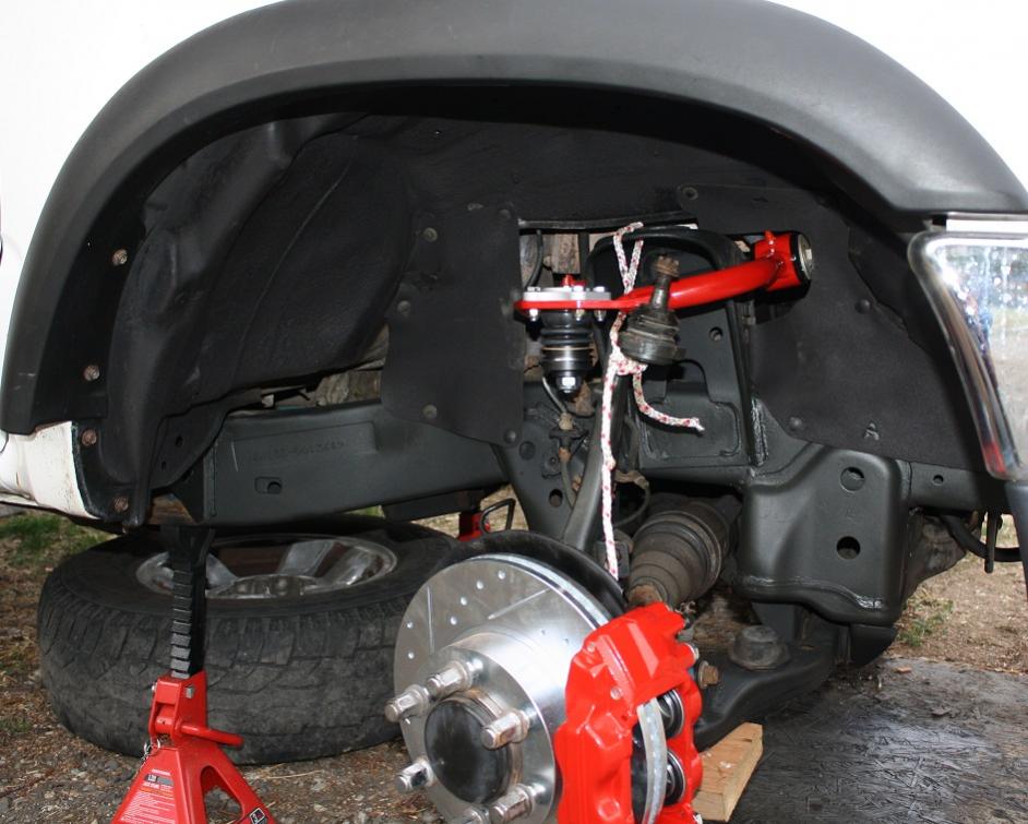

I have them on my 1996 runner. SAWEET! Better clearance with my skinny 32" tires and they give the 1" added down travel. Look great and install was easy.They have a new bushing design that is made by them now. It has groves in the outside face to help with bushing "push out" I use a HP moly grease in them and it works great. Here is a picture of when i put them in!
Have as great day all!

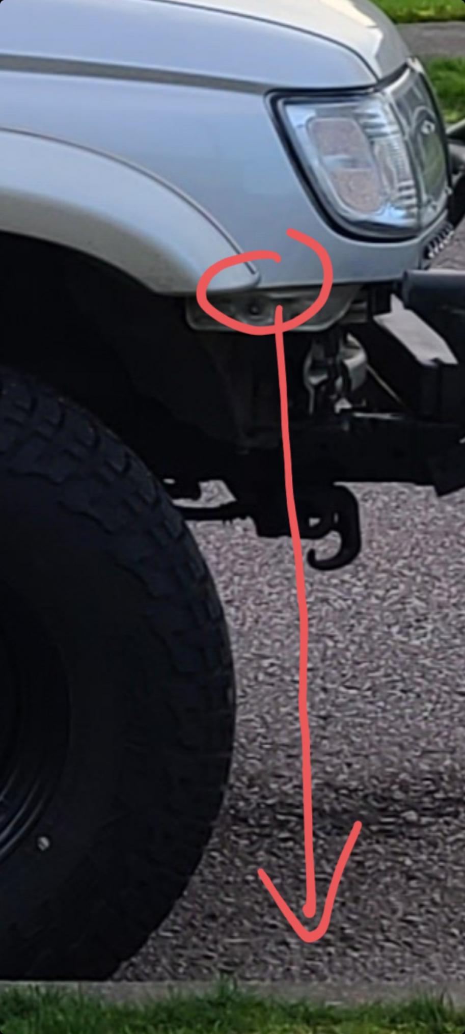

Just installed my JBAs this weekend and on top of the extra inch of downtravel I somehow gained an inch of lift up front? Not sure how that would be possible, but the tape measure doesn't lie. I always measured from underneath this corner of the fender flares, and it's gone from 30in to 31in.
Moved the knuckle much further away from the strut at full droop, which is great as I never properly oriented the TRD coils so they would hit, but not anymore!
Call me crazy but it seems like my driver's side lean is much less now too. All in all very happy with them.
