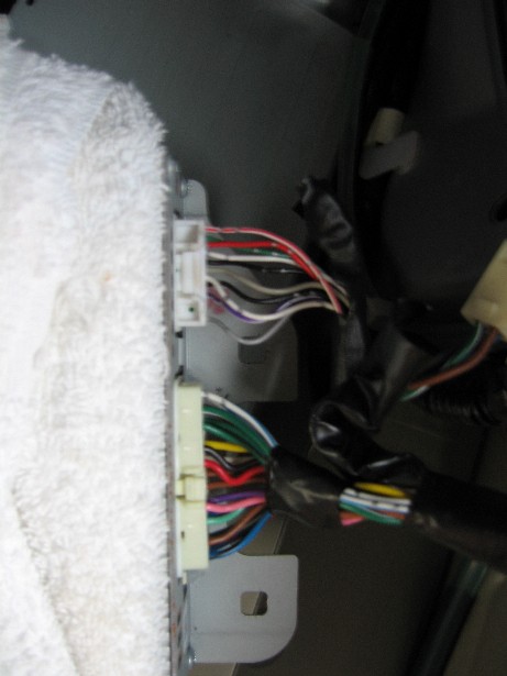

Does anyone know for a 2004 which color wire is the turn on lead (remote) so that I can tap into it to turn on my aftermarket EQ and amp? And also which wire color is a constant hot...thanks guys

on the S23 connector pin #1 or pin#10 wire ( white with light blue strip) both are the power side , so either one will be ok
the S23 only have 20 pin , the other one S22 is 24 pin , so dont mix up
from your photo , should be the bigger one connector and the wire u looking is the top one of the bottom connector when looking at your photo, white with blue
