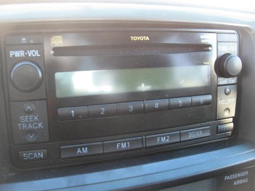

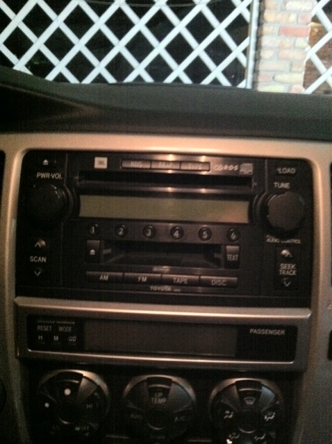

Ok, kinda hard to explain without pics so I dug up a couple.
This is non JBL, see how it sits back in the dash slightly?
This is the JBL, it sits out more flush with the silver trim. The face of the radio is much wider. This is what I have.
My question is what do I need, trim wise, to install a non JBL, Toyota/Scion HU?

you can install a nonJBL HU, but you need the SR5 nonJBL radio bezel. It's the whole front dash cover. About $350 online. ALSO, the HVAC display/controls will fit funny. Need to replace that too if you want proper fitment. This at the dealer will be big money $1200ish, but you can find them on fleabay for $100-200. I got mine for $75 (guy didn't know what he had).
This is my experience:
My truck came with JBL 6changer. I took that out and got the OEM NAV (fitment-wise, it's identical to a nonJBL radio). I eventually replaced the whole radio bezel and HVAC display/controls. Whole set up looks like it came from the factory (the way I like it).
When one converts from nonJBL to JBL its easy (lots of dash kits out there), but more difficult from JBL to nonJBL.

Radio bezel difference pics:
null.jpg~original
Sorry for the bad picture, I sold this bezel a while ago so I can't take another pic. BUT, notice the top one, you will notice black plastic the surrounds the radio whereas the bottom one is not there.
Hope this clears up stuff, if not, sorry.
