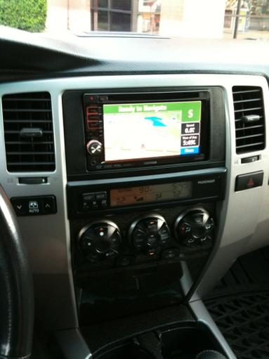

I have a 2003 4th Gen Limited with JBL 10-speaker w/o nav. I put in a Kenwood DNX 5120 using the PAC Tato adapter to retain use of the JBL amp and speakers. I've learned that the PAC Tato requires a 4V pre-amp input whereas the Kenwood only outputs 2V. The PAC tato has a gain adjustment, but not nearly enough to compensate. The volume does get loud enough, especially for movies.
Before I go buy a pre-amp signal booster, does anyone have a better adapter I should look into? The good thing about the PAC is the steering wheel controller which plugs right into the adapter. I want to keep the steering wheel controls.
OR, is there a way to manually increase the gain on the factory JBL amp?
Here's a pic of the unit installed, sorry for the iphone quality. Thanks.
