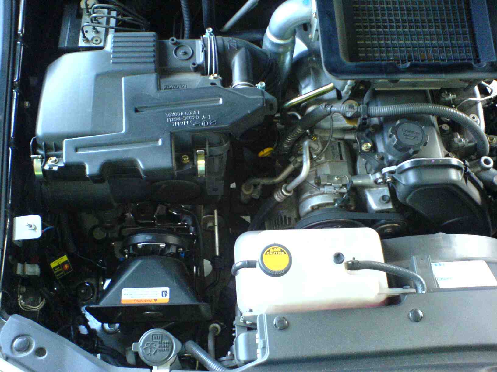

I suppose they supply dual batteries to countries with cold weather, or that additional battery you saw was installed by the owner.
It has the space for an additional battery. I used it for the alarm siren.
I noticed that it has "TOYODA" stamped on the metal part (manifold?). Interesting!
Then again, wasn't the name of the family originally spelled that way?
