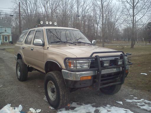

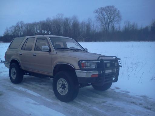

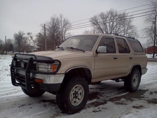

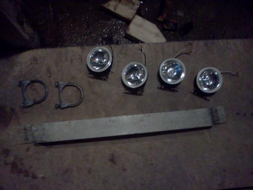

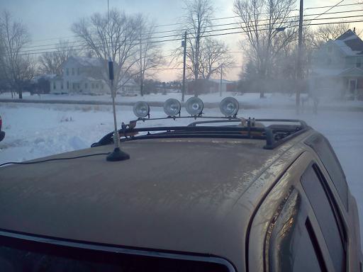

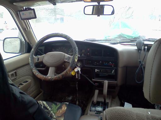

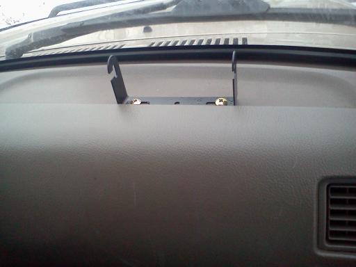

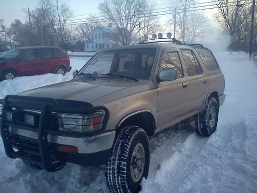

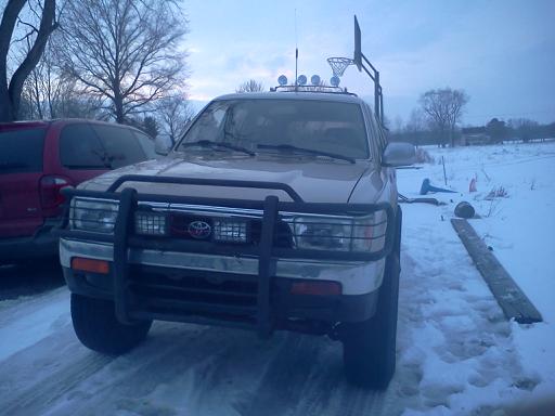

so i figure ill just post a build thread instead of scattering little bits everywhere and annoying everyone. 1994 t4r sr5 3.slow v6 4x4 automatic. brush guard, 2 rally lights, 4 pro beam lights, 2" wheel spacers, isr mod,...bj spacers and lc coils on the way!!

I like your pics with the Runner in the snow, Thats why I have mine to get to the powder when it falls :cheers: Good luck with your 4Runner

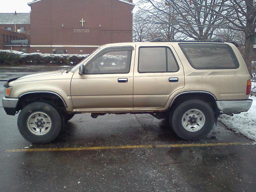

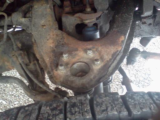

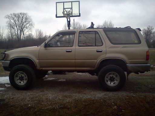

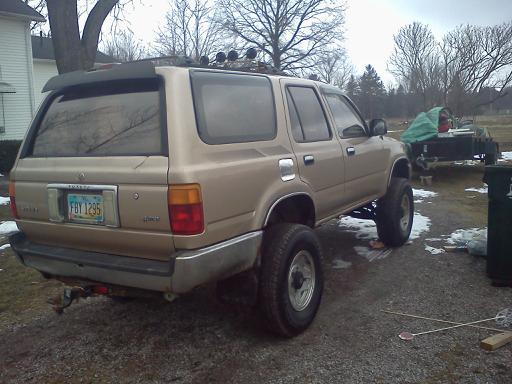

so heres the lift guys. comment! did it from 7pm to 4am alone in a garage. think i done pretty good for a 16 yr old with a few wrenches and some strength eh? thanks!

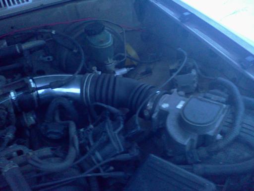

Nice work for anyone, but great work for someone your age!! Did you order the BJ spacers and coils as a kit or seperately? What shocks are you running? Was the chrome piece for the air intake before the MAS a fix (as in replace a damaged part) or an upgrade?
actually, i ordered the spacers from trdparts4u and got lc rear coils from muddertrucker99(thanks!). i am running after market jaycox shocks, but they arent suited for my lift. i have ome shocks for the lift on order. right now there almost fully extened. that is my 5 dollar version of the isr mod (intake silencer removal). had the piece laying around from an intake i built for my buddies acura integra. im very pleased with the difference in power it yielded

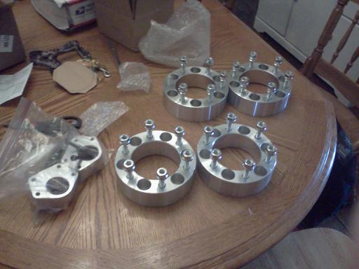

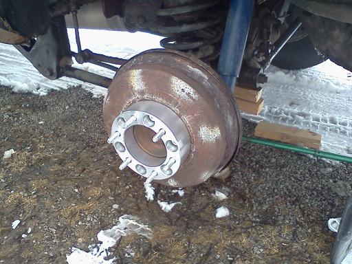

the wheel spacers are needed on the front because with the ball joint spacers the upper control arm will rub the tires, if you have stock rims. i could not afford new rims with more backspacing at the time so i got these spacers for about the price of one rim. also, with the increased height, and the already high risk rollover factor, its never a bad idea to widen the wheel base. hope that answers your question!
How much you pay for the wheel spacer's?
160 shipped free from ebay. the store is "thelugstore" appropriately named. just go to his store and search your vehicle. there good quality, tho a good coat of rustoleum is a very good idea because the will rust.
very nice! how much was the total after shipped? will they fit stock 31" tires? i was thinking about just painting my rims, but i like these better
Yes. Not sure on the total shipped cause i got 5 tire's and rim's mounted and balanced shipped to me at the same time. But they will fit your stock 31 inch tire.
