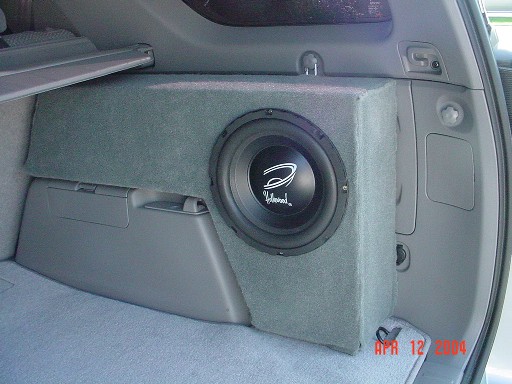

My Version of the JL Box
I just finished my box for my truck. I thought I was going to be disappointed but I am very happy with it. I think I am going to try a similar box for my wife's Highlander.

How did you mount your box to the 4Runner? I like the idea of building one myself since the JL Audio unit costs so much, but I am wondering how sturdy it is with your mouning setup.

I have a 4 inch bracket going parallel to the box and I am using a link to secure the bracket to the pin on the truck. However I did have the box fall once on a hard sharp turn once. Now I am looking at replacing the pin with bolt, but I am also going to secure the bottom of the box in the same manner using hook on the floor. I think the reason for the box falling was the lack of secure mount at the bottom, which allowed it to sway on the turn.
