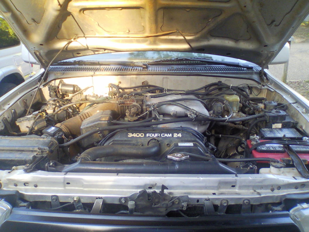

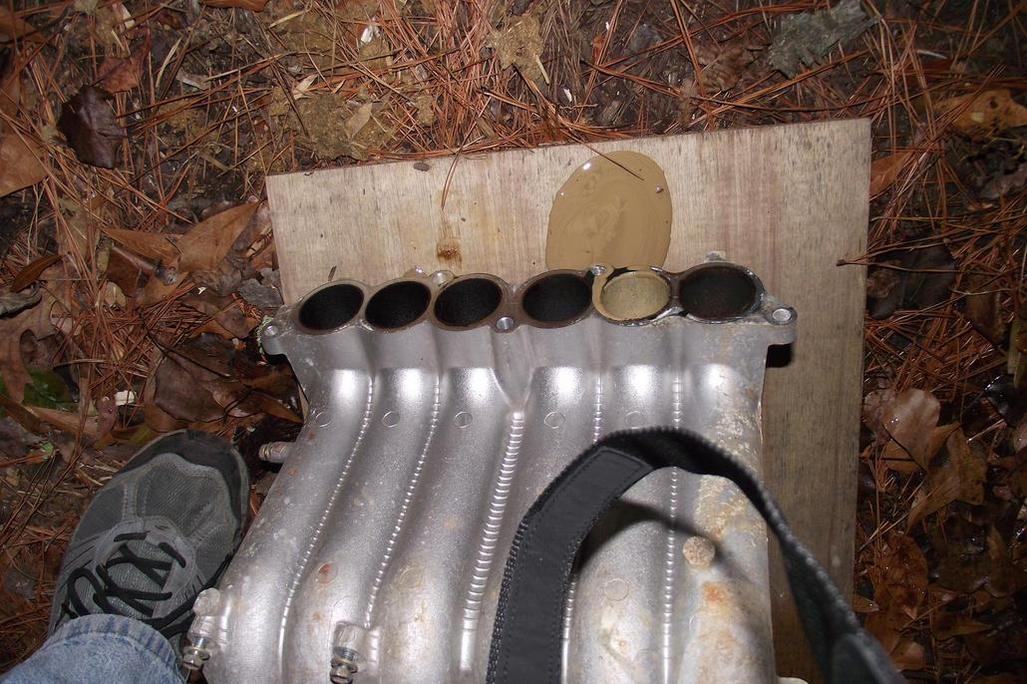

I purchased a 98 4Runner(Johhny 5) 2wd v6 Limited from a friend that was going to send it to the scrap yard. It was sitting behind his shop under the pine trees(messed up the paint and clearcoat some) from what appeared to be a blown head gasket. I bought is from him as a parts vehicle for $1k and proceeded to tear the motor down to find it actually had an intake leak that had burned a hole in the top of #2 piston. I completely rebuilt the motor from the ground up and have since put close to 10k miles it over the last year and still running strong. It had been rolled over in ditch on the drivers side and caved in the the fender doors and back sligthly and ripped off the mirror. I have removed most of the major dents and straighten the body to for the most part. This is a budget and donated parts rebuild. I passed my 94 DLX 4x4 down to my son.

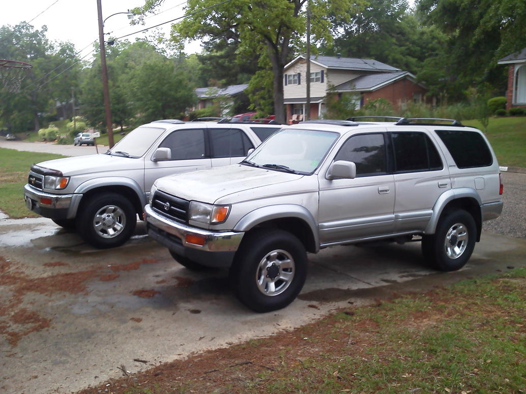

This is ressembled when I first got it

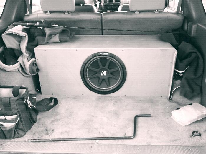

Pioneer headunit Kenwood amp and Kicker Comp 12

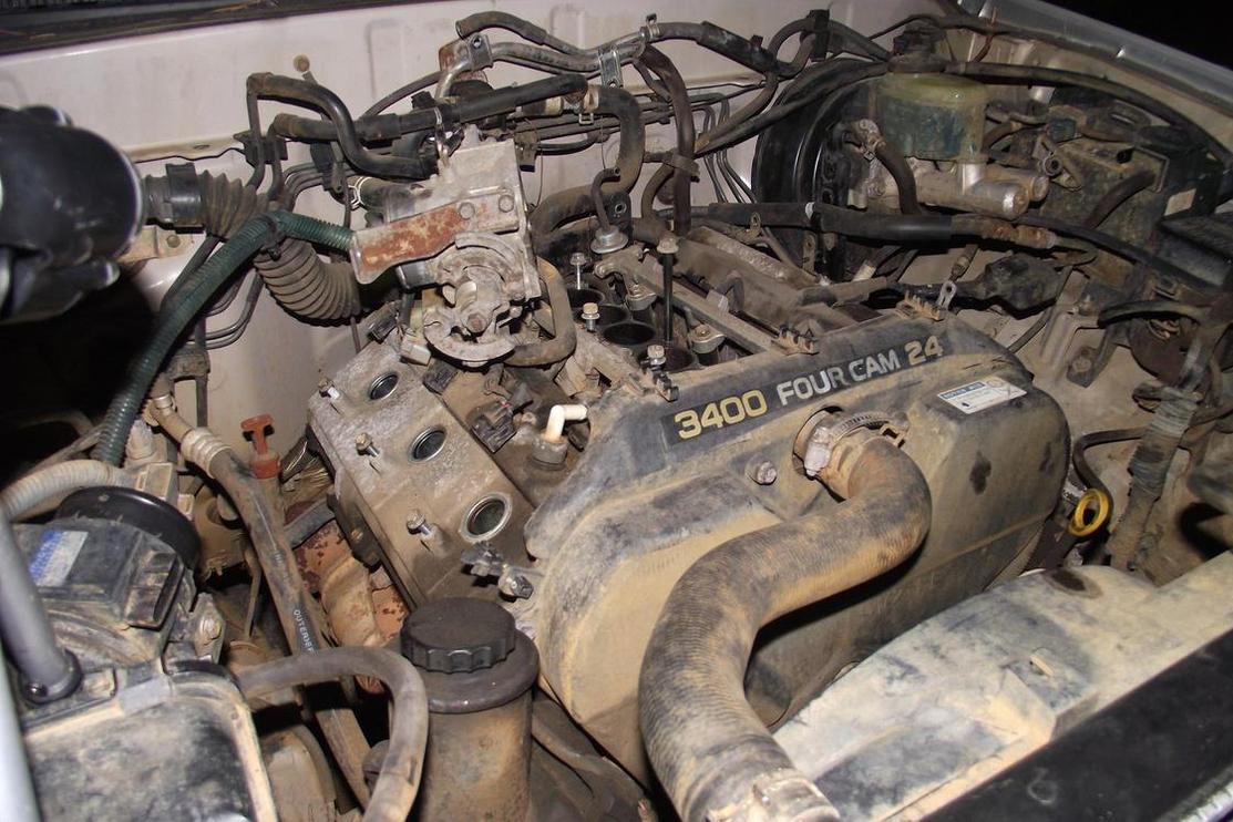

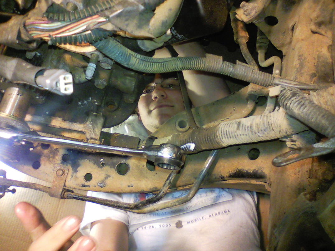

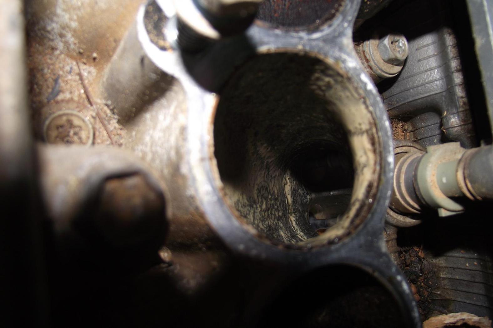

Tearing the engine down
1st sign of trouble
Knew I was screwed

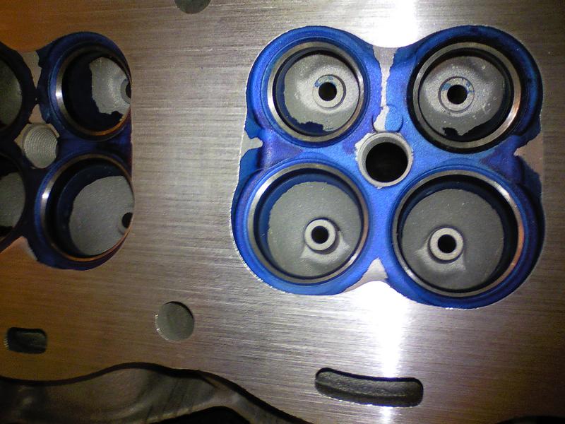

Heads back from machine shop(I had to snd these smooth and do the valve job)

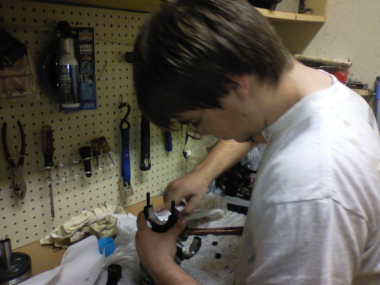

Teaching my son to assemble pistons rods and rings
My learning to install rod bearings
Installing pistons while my son guides them in place and tightens rod caps

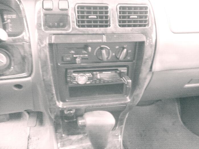

Headunit installed

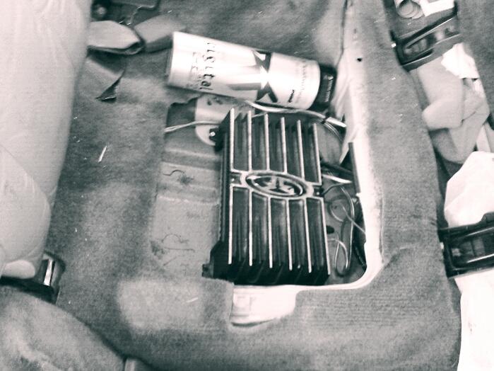

Amp and cap installed

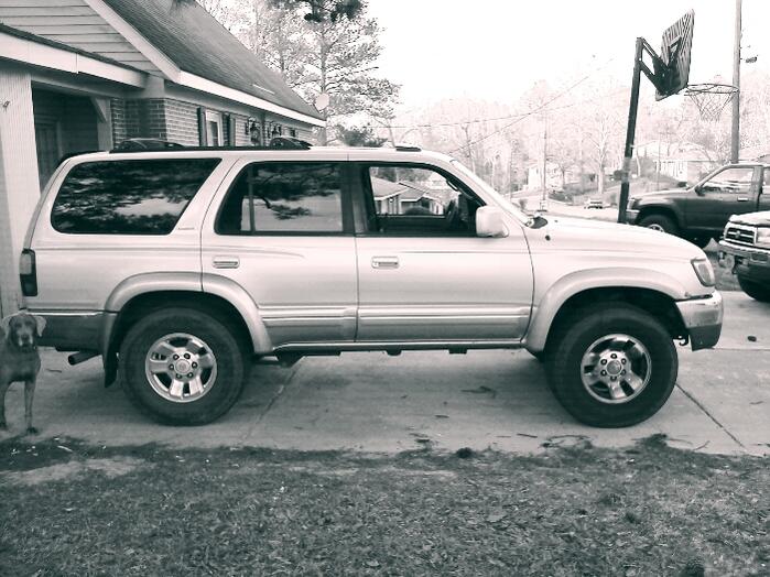

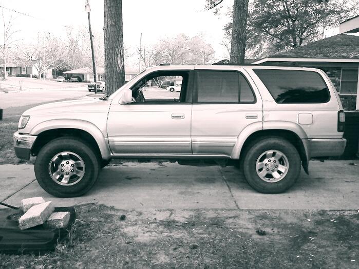

Front coils, Front and rear Bilstein shocks installed(rear sag) Donated by Chisel
Passenger side
Drivers side

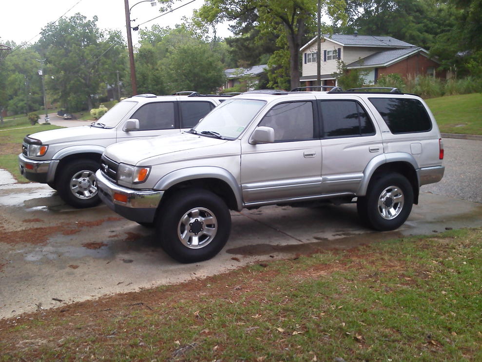

FJ Cruiser rears installed and in its present state. Donated by SMEE
I gained about 2" in the front and 2.5" in the rear.
You can see some of the body work(finish when I am ready to have it painted) left to do in the last 3 pics and the grill I repainted and the center caps refinished.

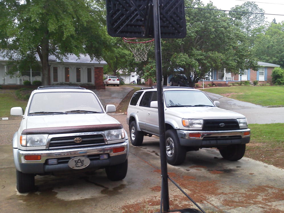

Oh, dismiss the Auburn tag on my wifes vehicle. :jaw drop: She has been brainwashed by her family for years. :redbrick:

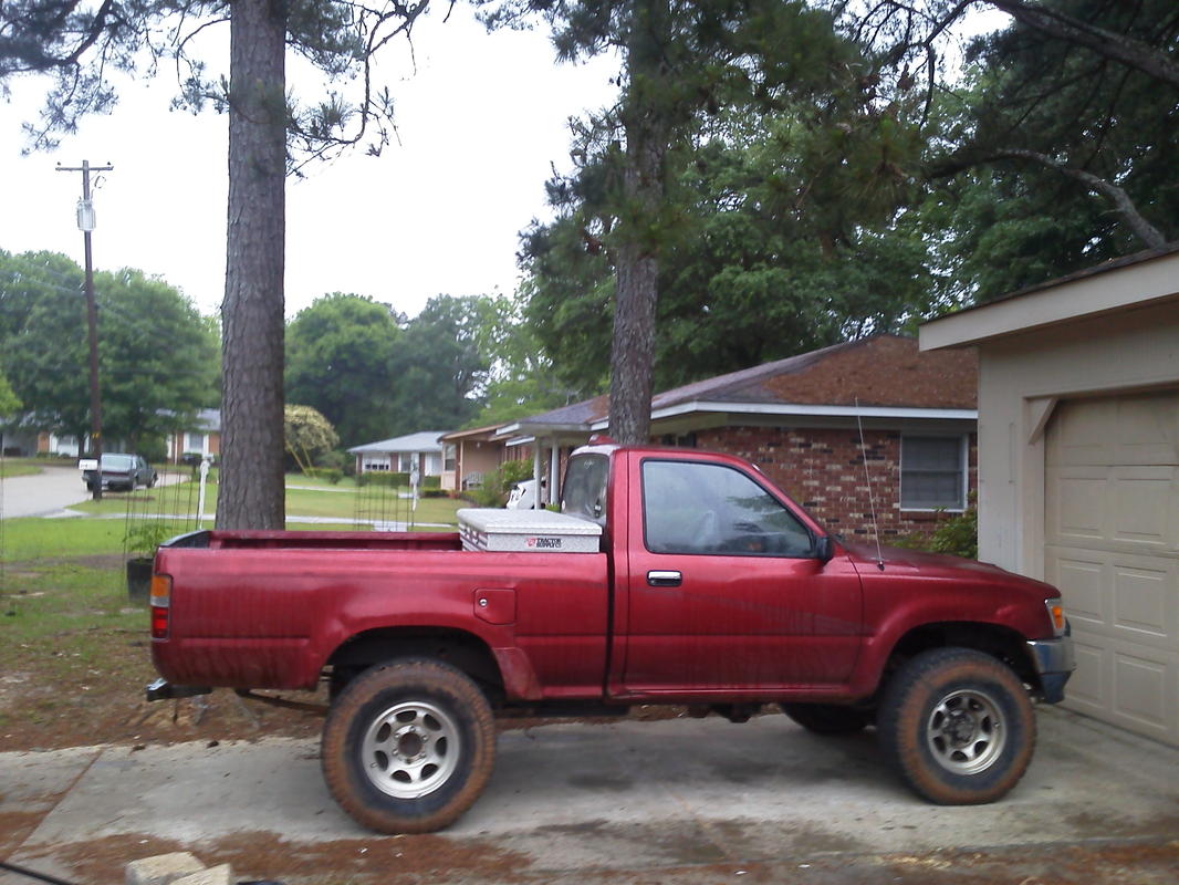

Here is my old ride that my son drives now.

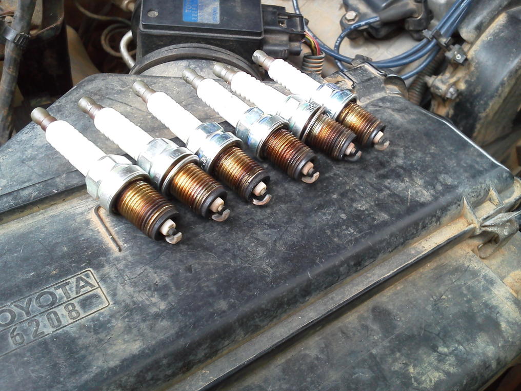

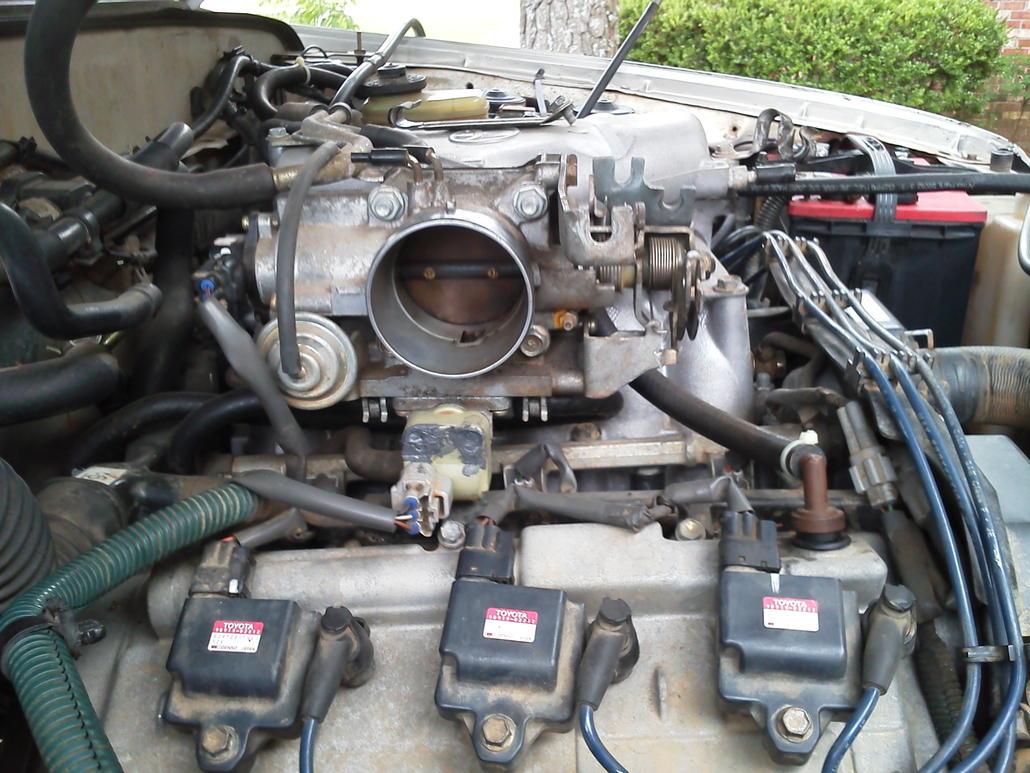

I changed out my single electrode plugs for the NGK Nickel's
and installed a new Dynomax Muffler.

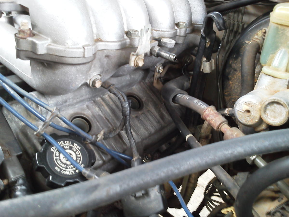

Removed breather tube to access the plugs on passenger side:
Driver's side:

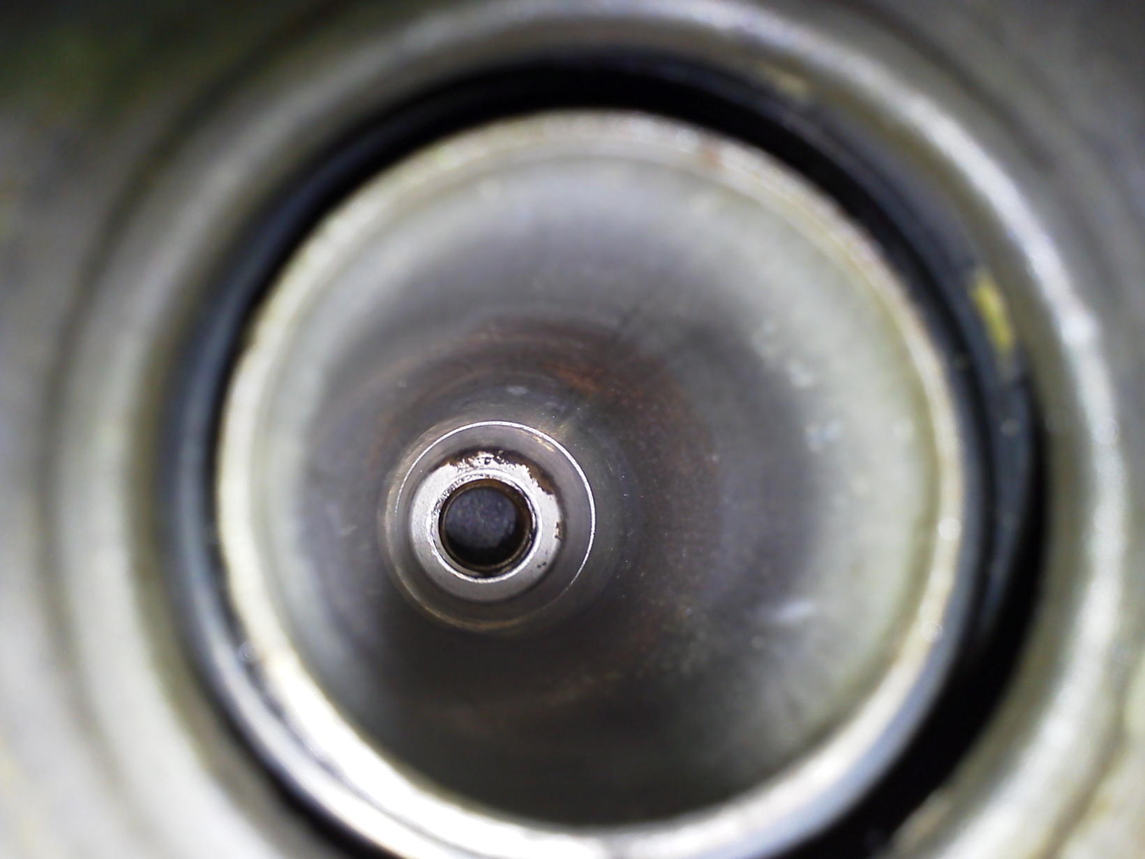

Look pretty clean inside cylinder #2 (cylinder that was blown before the rebuild last year)
Plugs look just as they should almost a perfect burn in all cylinders:
