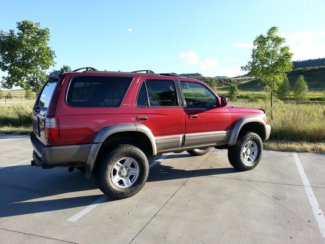

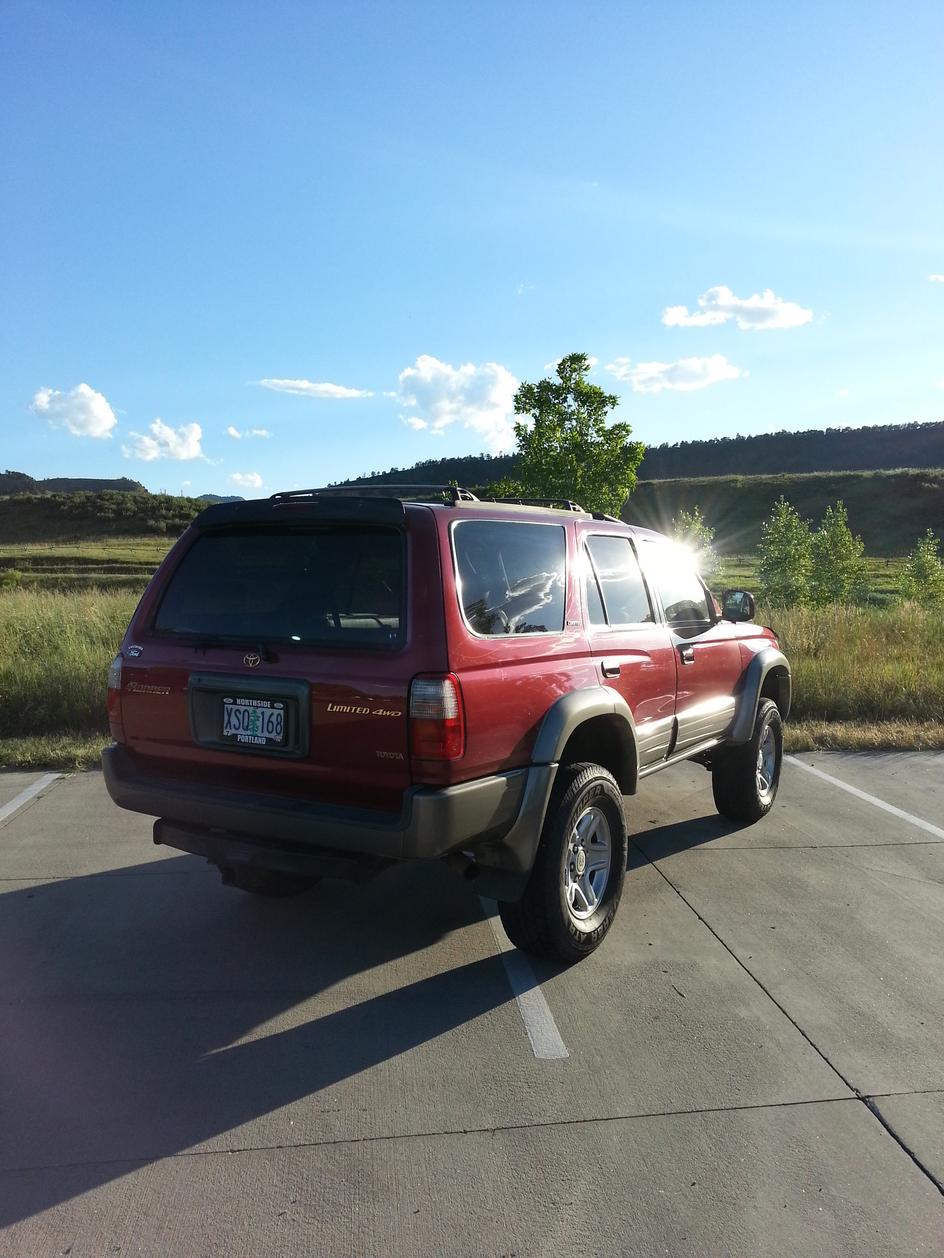

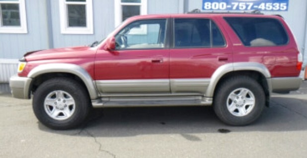

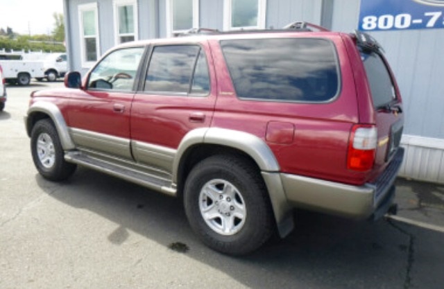

Here's a few grainy pics of what it looked like when I picked it up.

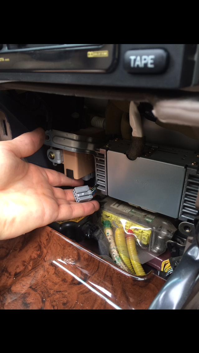

Not being satisfied with such a simple job, I moved on to disconnecting the power antenna. The nylon gears were clearly stripped out, leaving the antenna somewhat at half-mast (you old guys know all about that business, but I digress). After poking around the website, I found the wiring diagram for the stereo system and a post or two relating to the mysterious connector behind the center dash console. It took about 15 minutes of finagling with the mast before I could get it properly stowed. It was another 2 or 3 minutes to get the dash apart. Once I had the stereo removed, I found the antenna relay connector and simply unplugged it. Problem solved!
My index finger is touching the connector housing. Good stuff. Time for a beer.

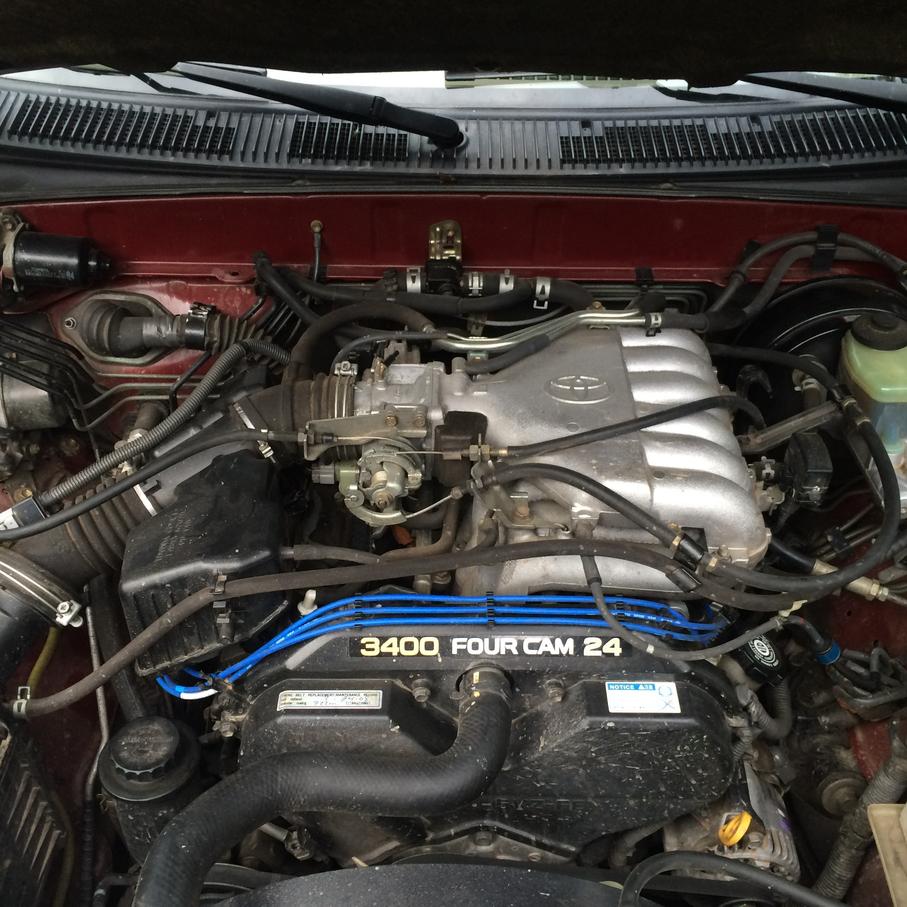

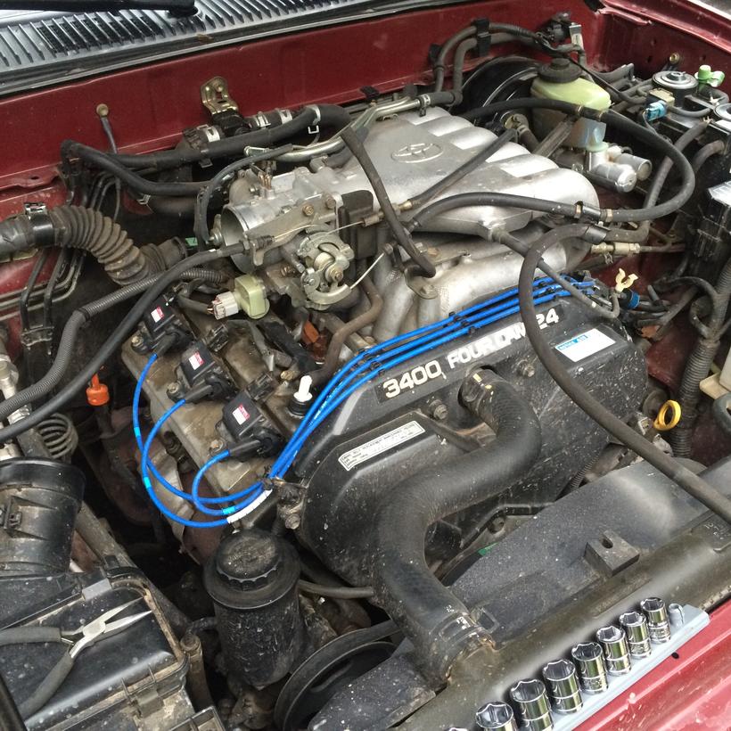

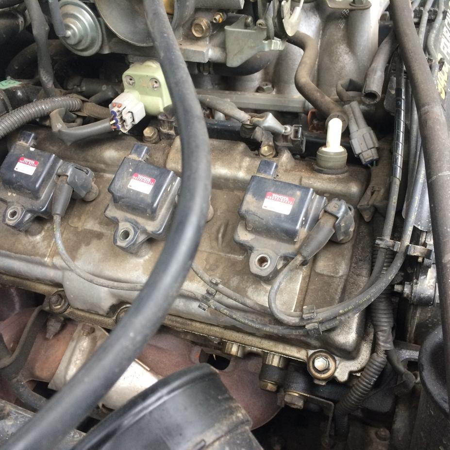

The plugs and wires were an interesting setup. I went with the Denso OEM plugs and the NGK direct-fit wires. I also popped in a new, all-metal PCV valve and a new rubber grommet. The grommet was so brittle that little pieces kept falling into my cover. Thankfully my fine needle nose pliers was able to pull out all the little chunks and the new unit was installed. I checked my plug gap and went to town. All in all, it was about an hours worth of work. Setup and cleanup was another hour. Not too shabby. There's a definite improvement with my cold starts and a much smoother idle.
You can see the old, faded PCV and grommet in the first pic. Shiny and new parts in the second. The jury is still out on the look of the wires. Blue is my favorite color, but whoa! It looks pretty loud under there.

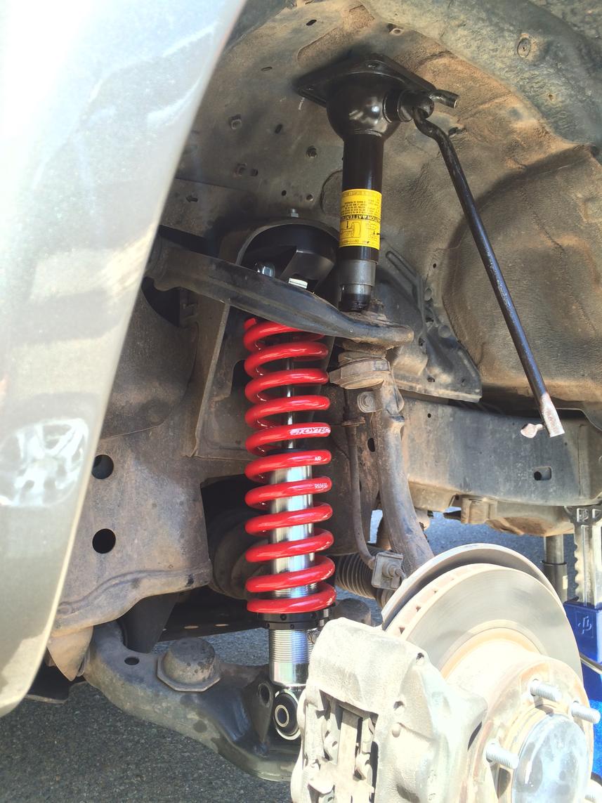

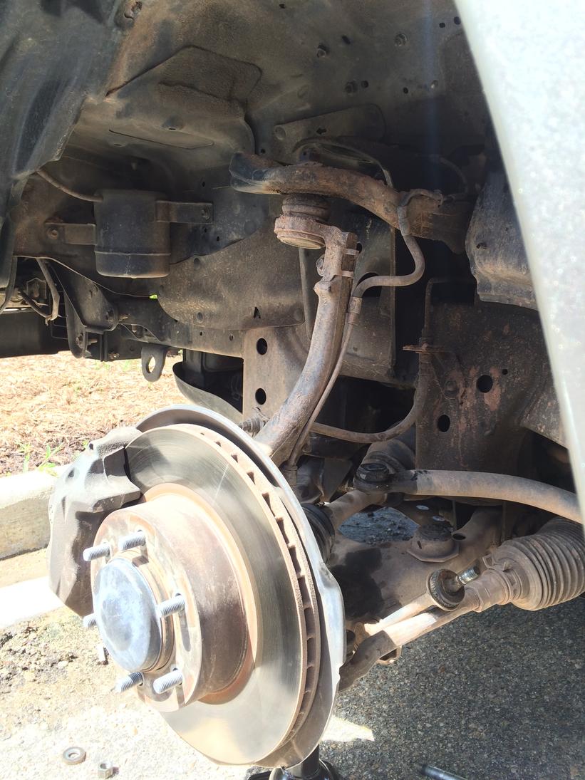

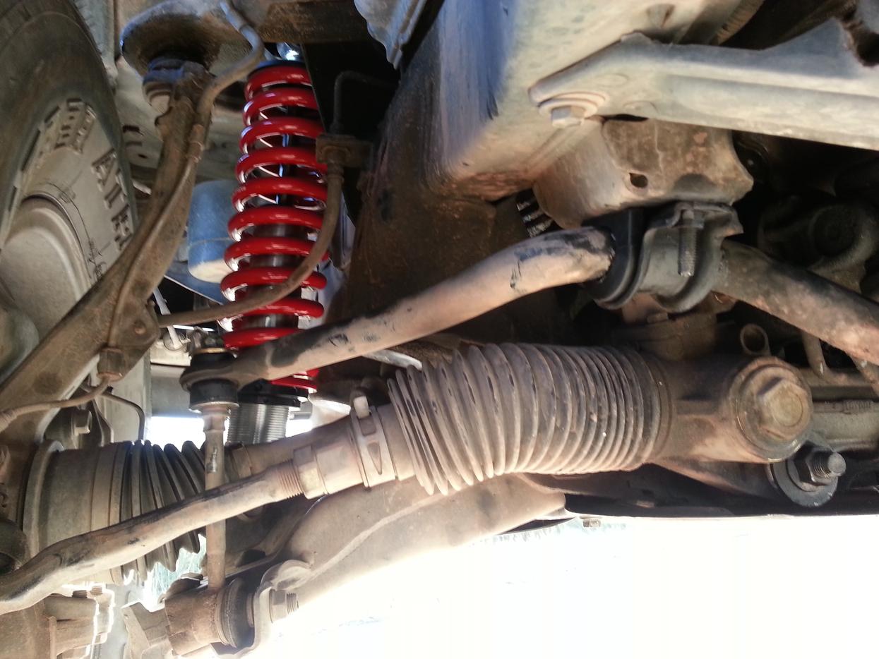

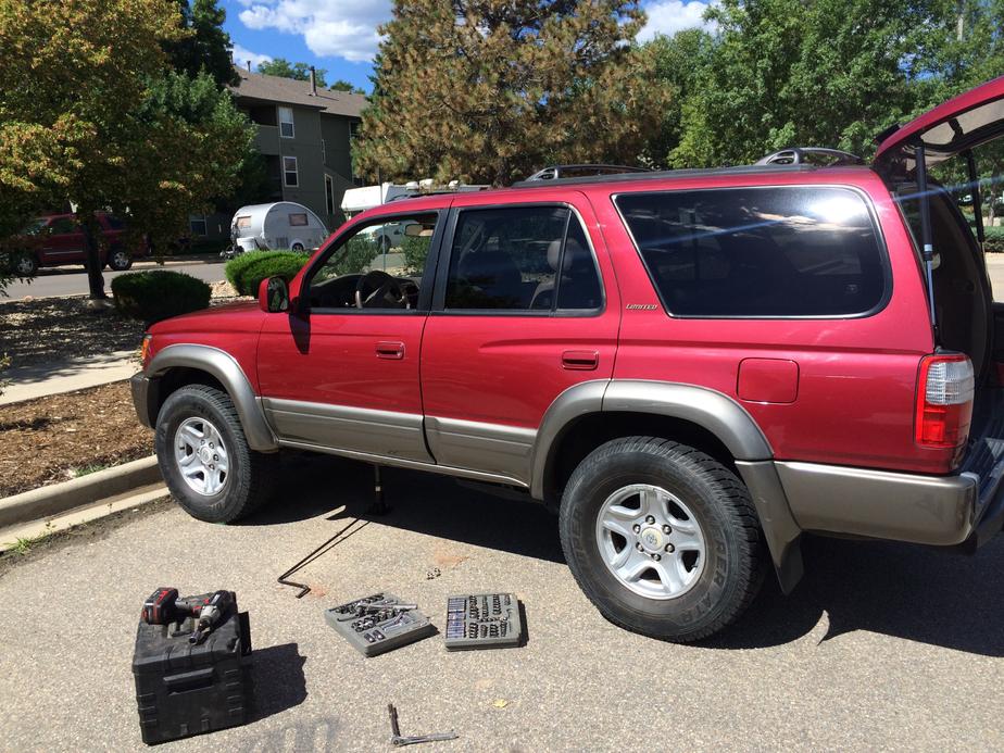

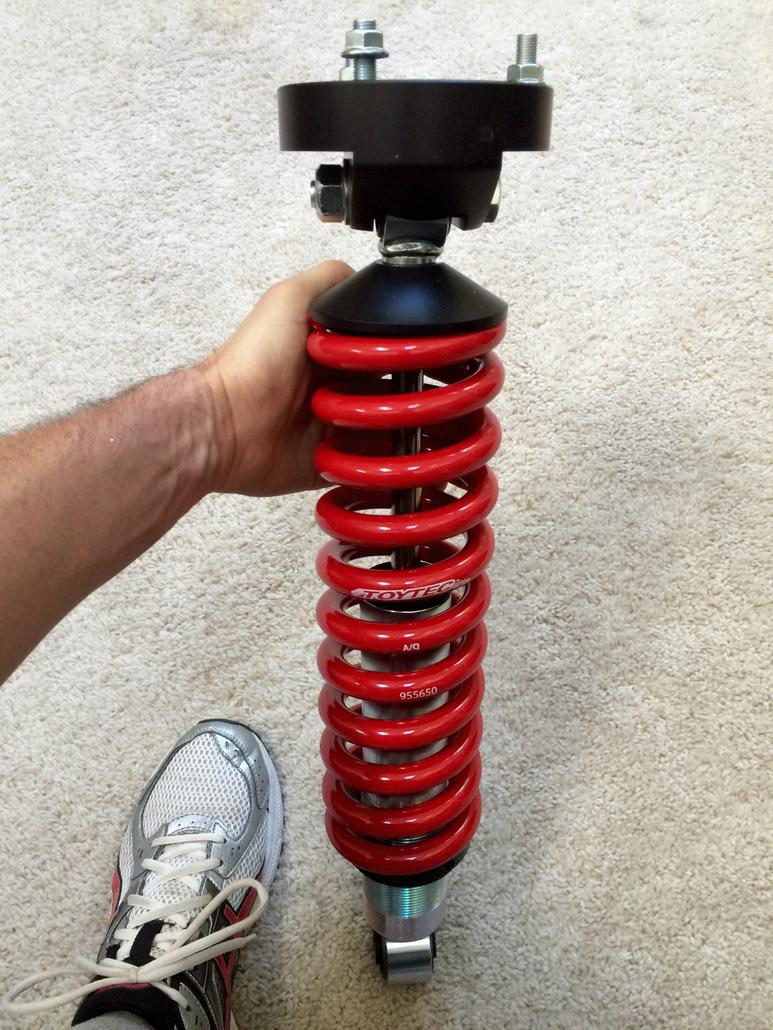

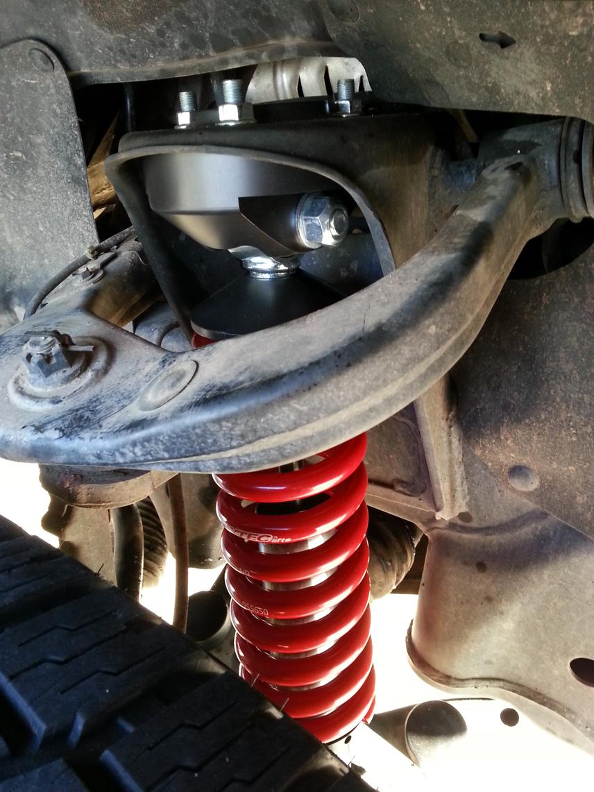

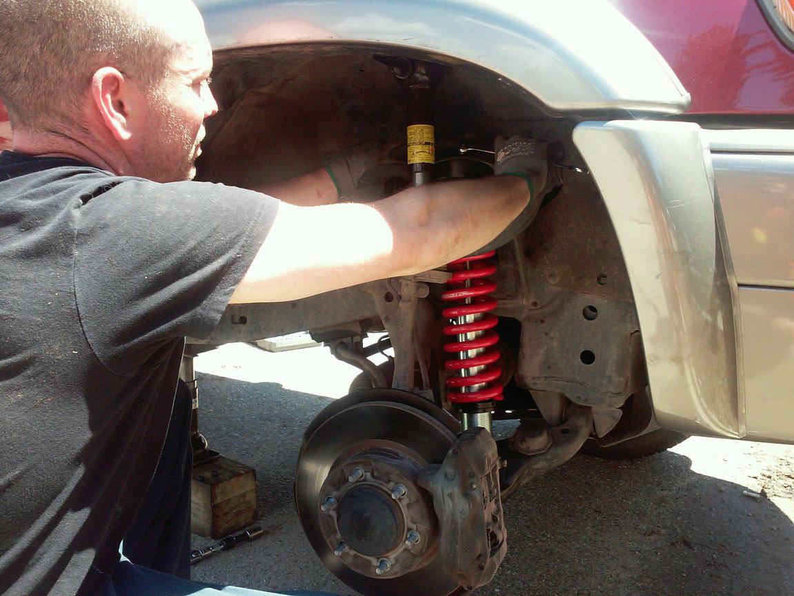

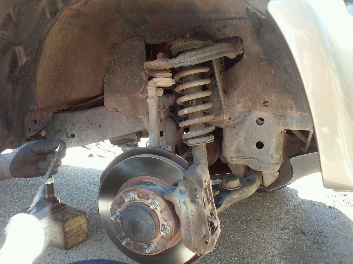

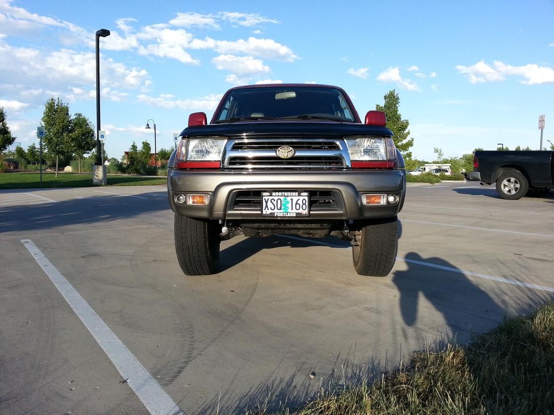

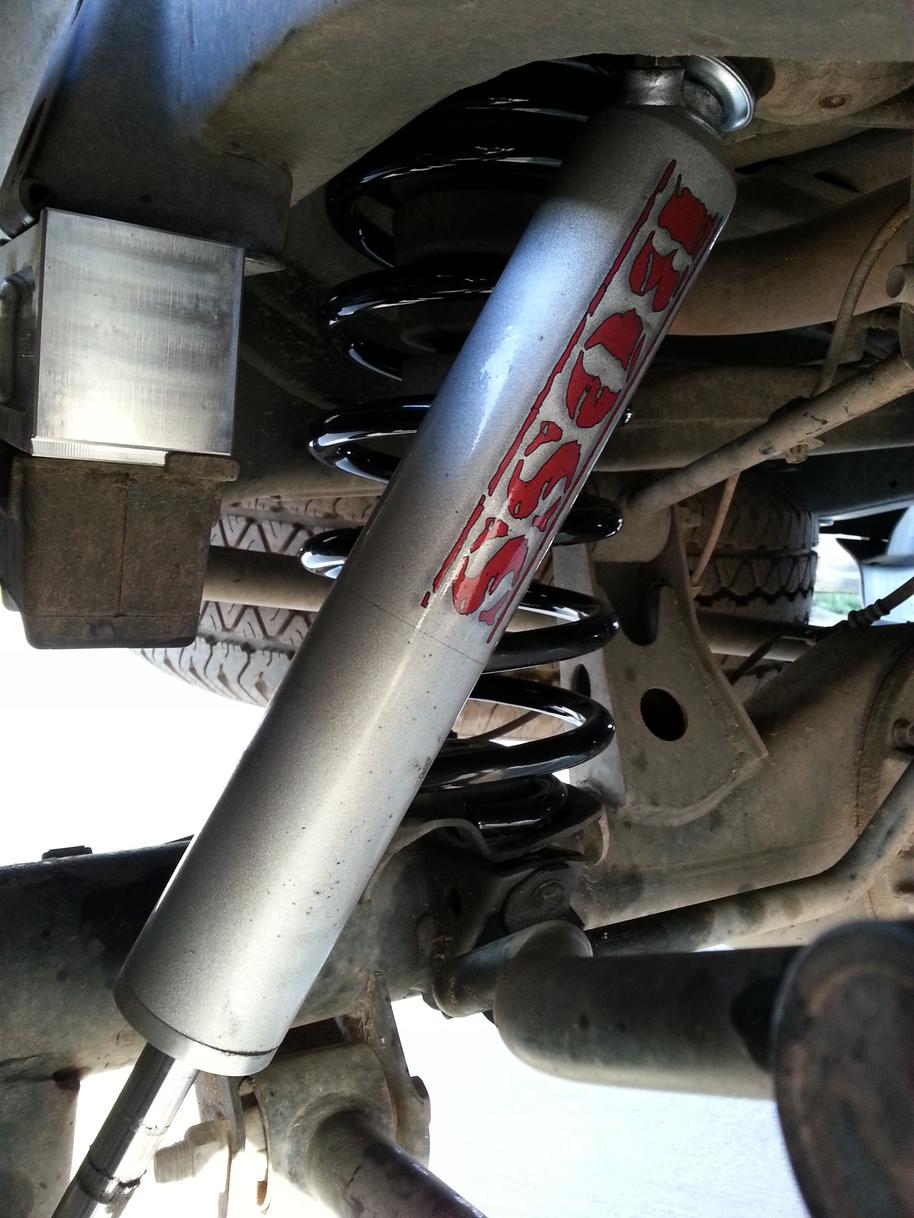

This past Saturday proved to be quite the adventure. Toytec lift install! Two sunburns, some doughnuts and a crushed iPhone 5s later, Asaspades and I had all back together. We managed to pull it off primarily using our factory bottle jacks and our jack stands. Oh yes, and one of Asa's 35" tires...
While we were at it, the running boards came off and new polyurethane bushings were installed on the front and rear sway bars.
I have to be honest: I really had no idea what to expect in terms of the ride. I will say this, though: going from worn out suspension and bushings to a complete Toytec system with all new bushings will make your head explode. She's tight.

A few more shots of the install and the finished product. Well, almost finished. Power steering polyurethane bushing kit, wheel spacers and the alignment need to be finished this week.
It's been a wild week.

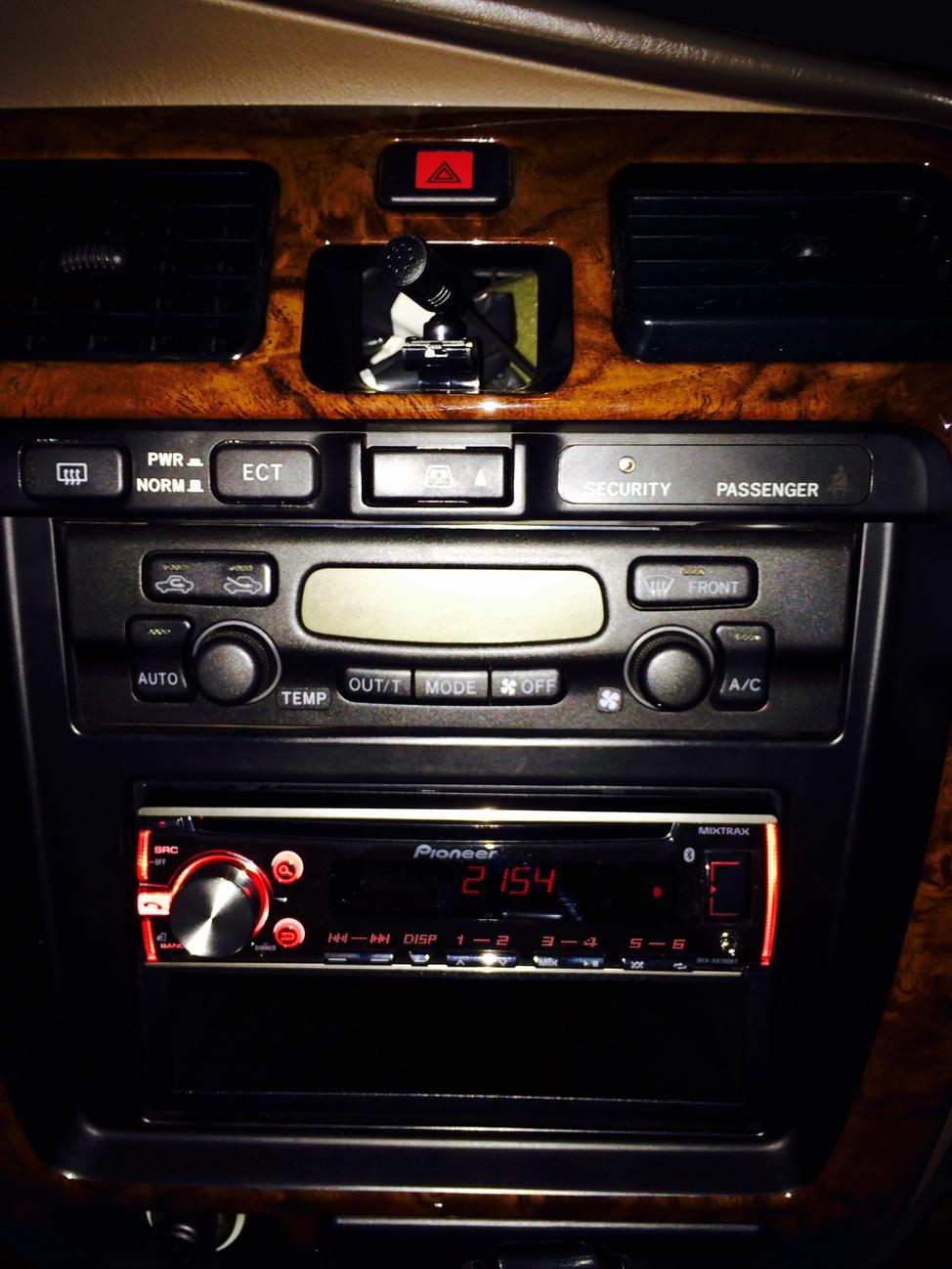

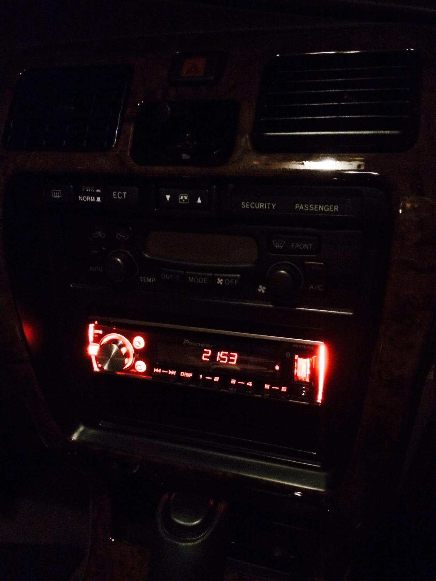

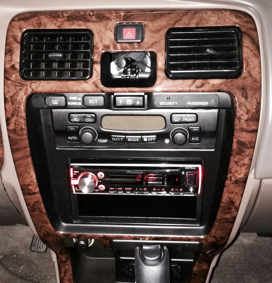

I almost forgot the corny shots of my newly installed radio...
Also, Crutchfield made this incredibly simple. Product support, instructions...it's all there. You might be able to find things a bit cheaper, but Crutchfield's way of doing things is solid. From start to finish, I was done in 3 hours. Good stuff. Time for another beer.

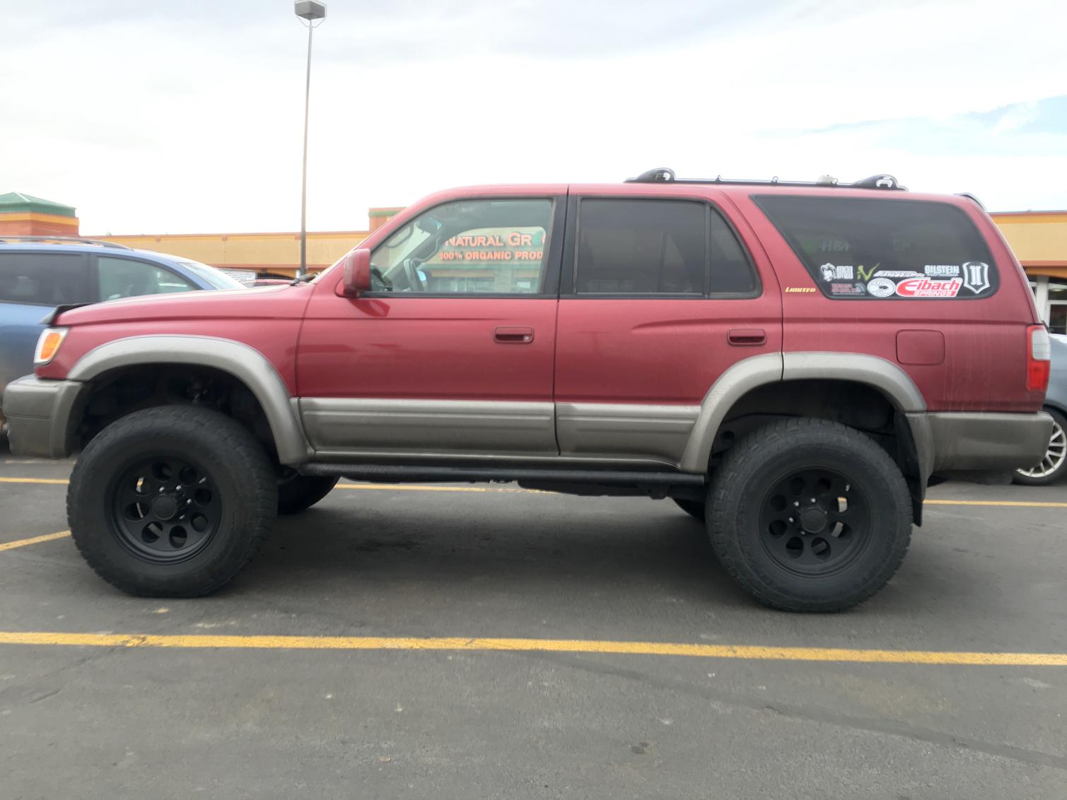

17" ION Alloy Wheels with 33" Nittos. $550 off of CL. And my [MENTION=17736]AddictedOffroad[/MENTION] sliders

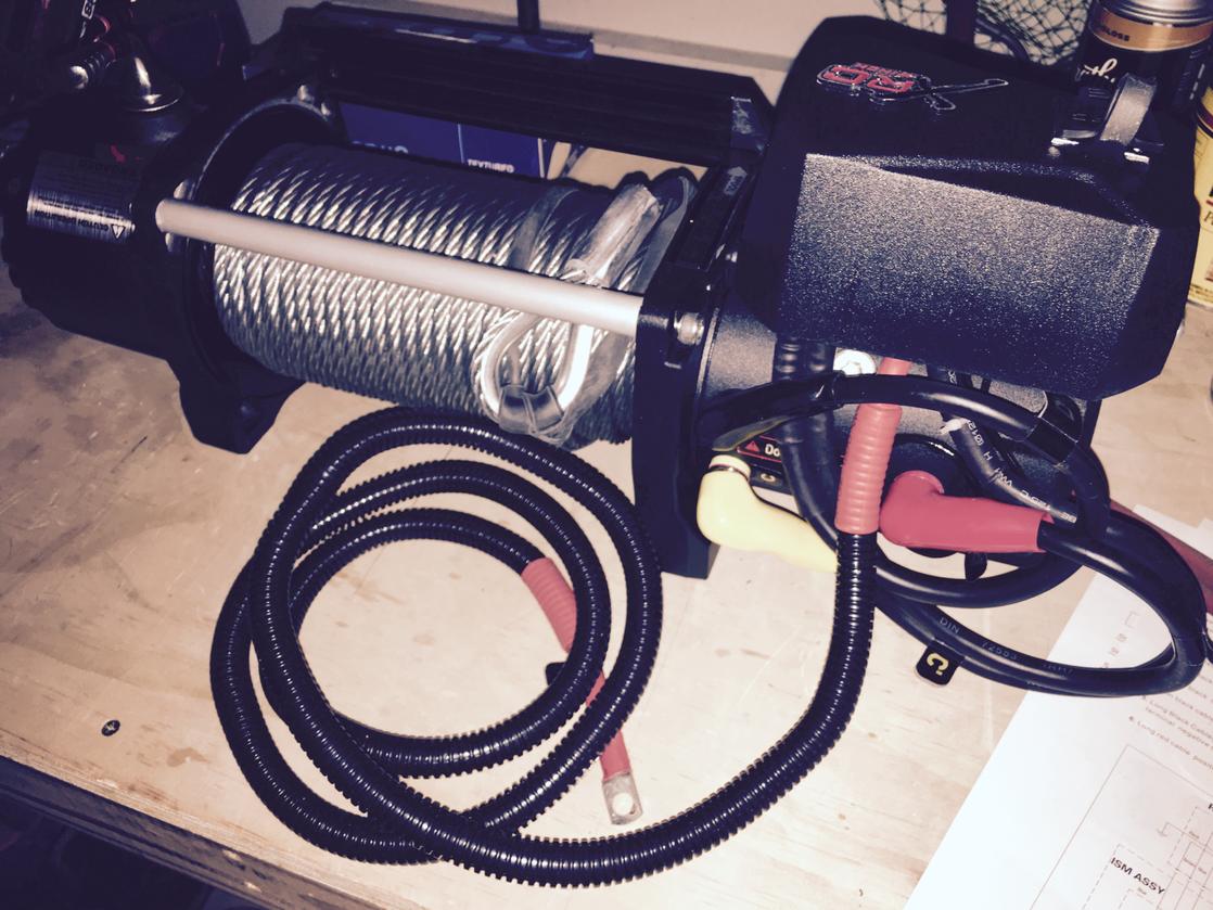

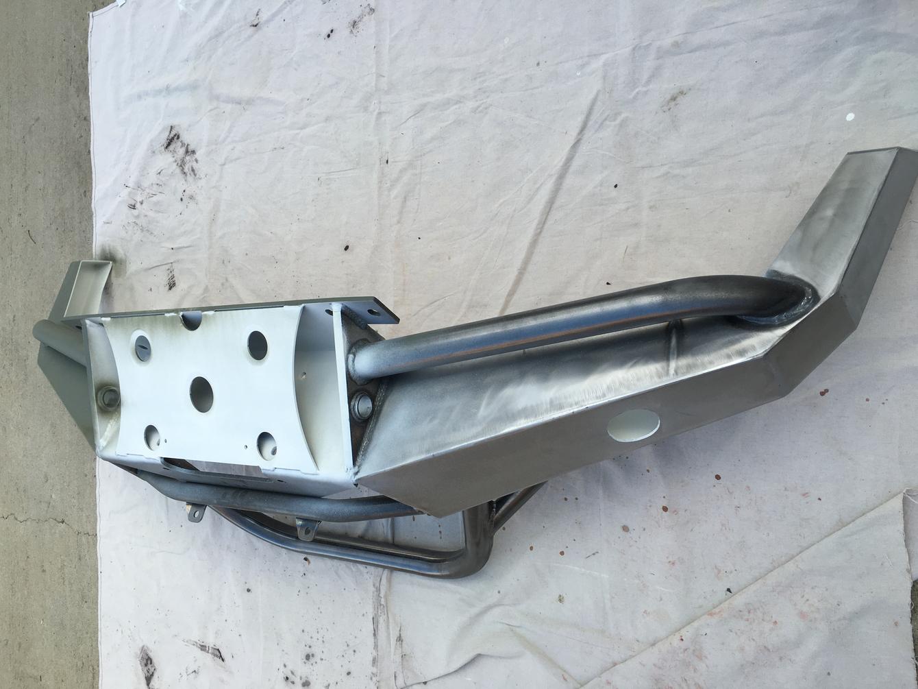

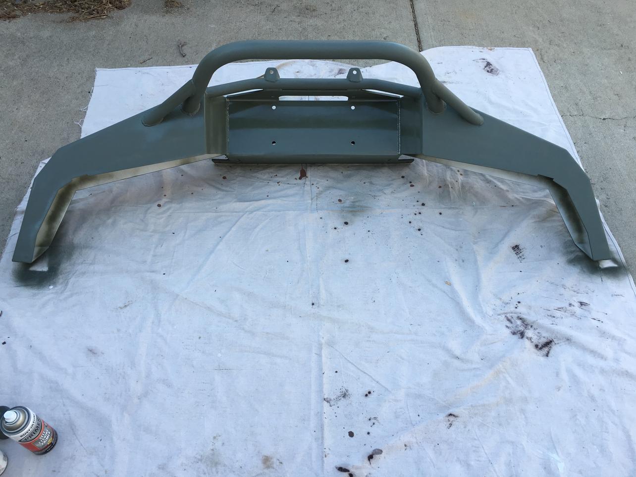

I also managed to get my [MENTION=17736]AddictedOffroad[/MENTION] bumper primer'd up for install. The new Smittybuilt XRC 9500 is also prepped for install. I'l be doing the B&M Transcooler upgrade when I take the stock bumper off. Anyone that needs a fat lip is welcome to mine.
