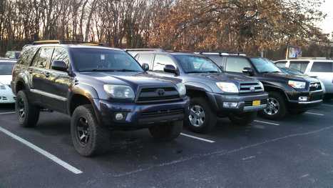

So my dad parked next to you at Kroger and then our friend with a 5th gen parked next to him. haha
