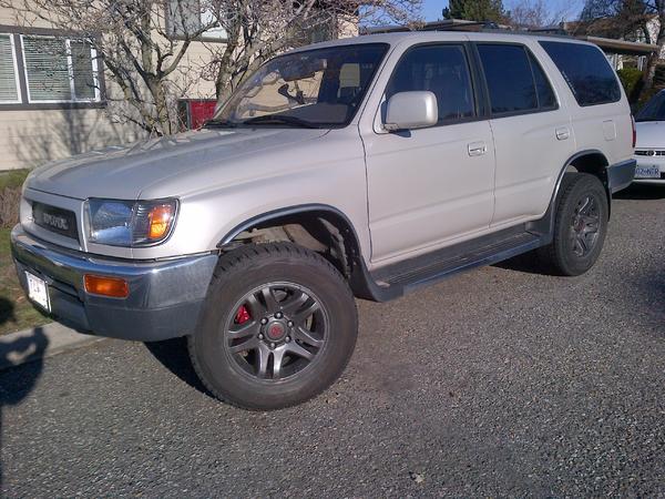

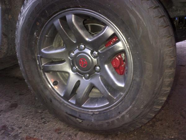

I live in an area with all 4 seasons. When I first bought my 4r, I bought 4 split 3's for $150--- they weren't in great shape so I removed the corrosion, re-finished them and painted them. They looked practically new. 3 years later I decided to do the TBU, so I had to replace 2 sets of rims. I found a set of 16" LTD rims from a fellow member--- this worked, as I had a great set of all season tires for the warmer months.
For Winter, I went to a junk yard and found a set of 17" Sequoia rims--- they were in pretty rough shape--- they tried to talk me out of them--- but they took $150. They were another corrosion/refinishing job, but they turned out well.
I found a good set of Winters--- I must admit I like the Sequoia rims the most.

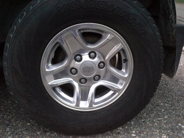

I'm not sure what the official reference means--- just what I've witnessed. My LTD rims are polished--- they are polished alloy with a clearcoat finish. When I got them the CC was starting to chip off and minute spots of corrosion were starting. I stripped the CC and re-polished them and applied 4 coats of CC.
My Sequoia rims, on the other hand, looked like polished alloy but due to the significant corrosion (lifting paint), they were clearly painted. When they were new you would have had a hard time telling. When I re-finished them, I had some sanding to do to remove the pitting till they were smooth again. I coated them with an adhesion agent, primer and 4 coats of rim paint.
If you're planning to go this route, here are the items required: paint stripper and a plastic scrapper, fine wet and dry sandpaper, steel wool, and for the really stubborn hard to reach spots a Dremel! The Dremel worked great!

The adhesion promoter was a zinc chromate primer made by Dupli-color CDAP1691
The paint was called High Performance wheel coating also made by Dupli-color CHWP10200 HIGH PERFORMANCE GRAPHITE

Sounds like a plan. If they were already painted, then a light sanding and paint will be better. The primer I used is specifically to improve adhesion to AL alloy. With my caps, I lightly sanded them and painted. Them I took a dollar store fine paint brush and painted the "Toyota" symbol with red. done.
