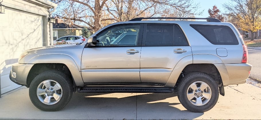

I got the fronts installed today and it seems like I've gained 3".
I think I understand that excess can be due to the potential sagging OEM parts. I'll get the rear done tomorrow and asses.
Thank you for your response
also, I did the no compress method. Easy peazy
Complete.
I think it sits pretty good. Might be kind of hard to tell because the driveway is a bit angled, but I don't think the front is up too high
what do y'all think
