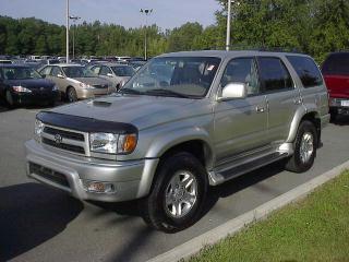

I just purchased a 2000 4Runner SR5 but the ride was really bouncy. I got a good deal and figured I'd look for some good aftermarket replacements and now I'm searching. The Tirerack has KYB non adjustable shocks for $55 front and $38 rear, and front mounts are $36 each which I figured I'd also replace.
How is this price? How do these compare to stock? Bilstein? Tokico? etc etc? I'm not going off road, I just want to tighten things up w/o getting too harsh of a ride.
Thanks in advance!!
