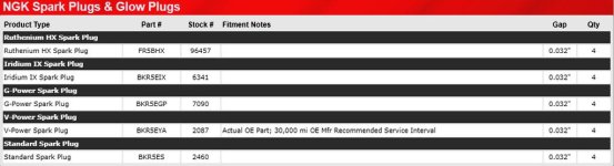

The NGK web site lists suitable replacements as
1. Standard NGK BKR5ES
2. OE NGK BKR5EYA
3. GPower NGK BKR5EGP
4. Iridium NGK BKR5EIX
5 Ruthenium NGK FR5BHX
Pricewise, they are roughly equivalent given there are only 4 of them and they're pretty inexpensive so the question isn't at all about price.

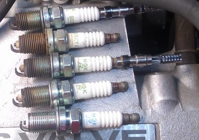

I put a tiny bit of anti seize gray paste on the threads and some dialectric grease on the rubber so that it won't stick so much when removed.
The plugs were pretty worn so I replaced the plugs and torqued each to a half turn or so.
Then I replaced the wires.

While I was reading about the corona on the spark plugs in your link and then noticing the corona on my plugs, I just noticed the number 1 plug (on top, where the plugs are in order) is a bit grungy on the insulator but maybe that was from the misfire on cylinder 1.

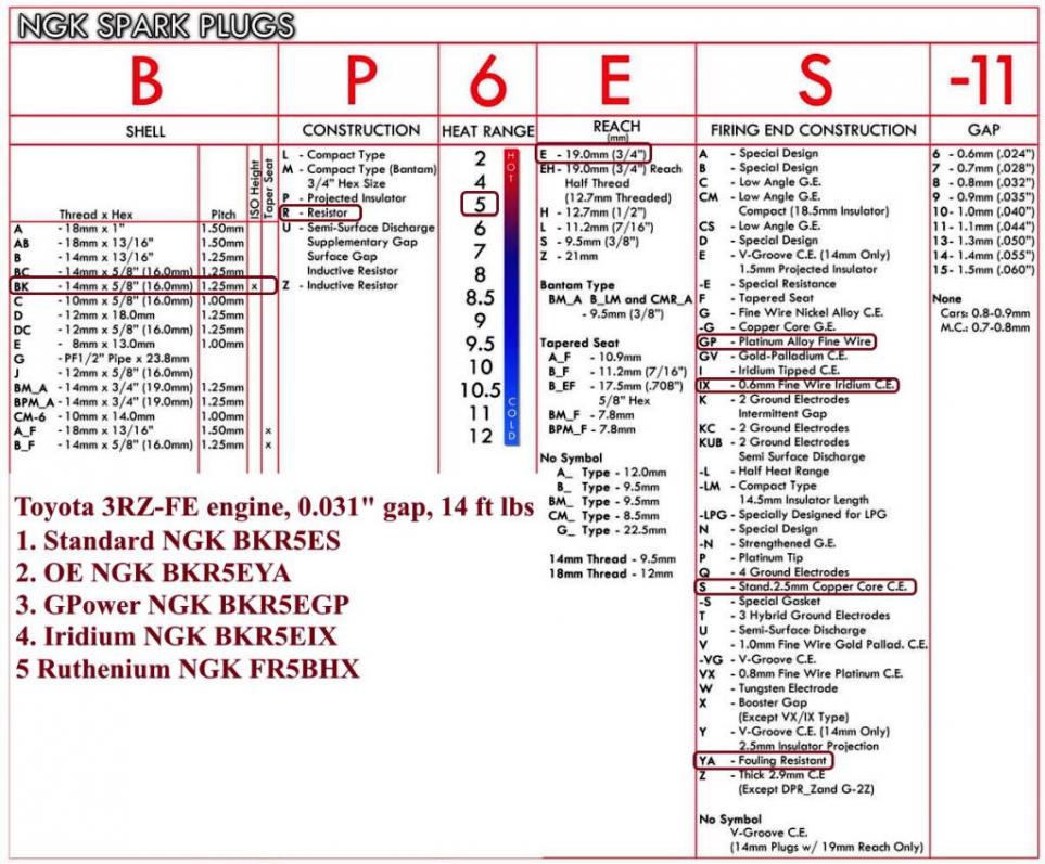

As I read your helpful link, I found this NGK secret decoder chart which seems to explains the plugs.
I had to ride my bicycle to get the parts and they only had the standard NGK BKR5ES in stock but it seems the only thing I lose are miles given the heat range is the same.
