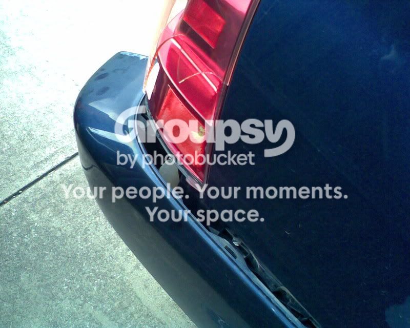

So the Runner just got rear ended :( Anyways, just wondering about the insurance part. Never been in an accident before, my insurance company says it can go two ways. 1st I pay the deductable of $500, and my insurance company pays the rest and they go after the other insurace company for my deducatable and everything is payed off, or they said I could just get it all done thru the other drivers insurance. I don't know witch would be better??

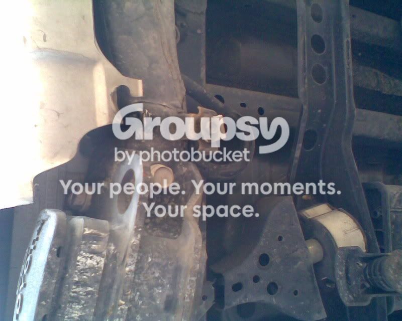

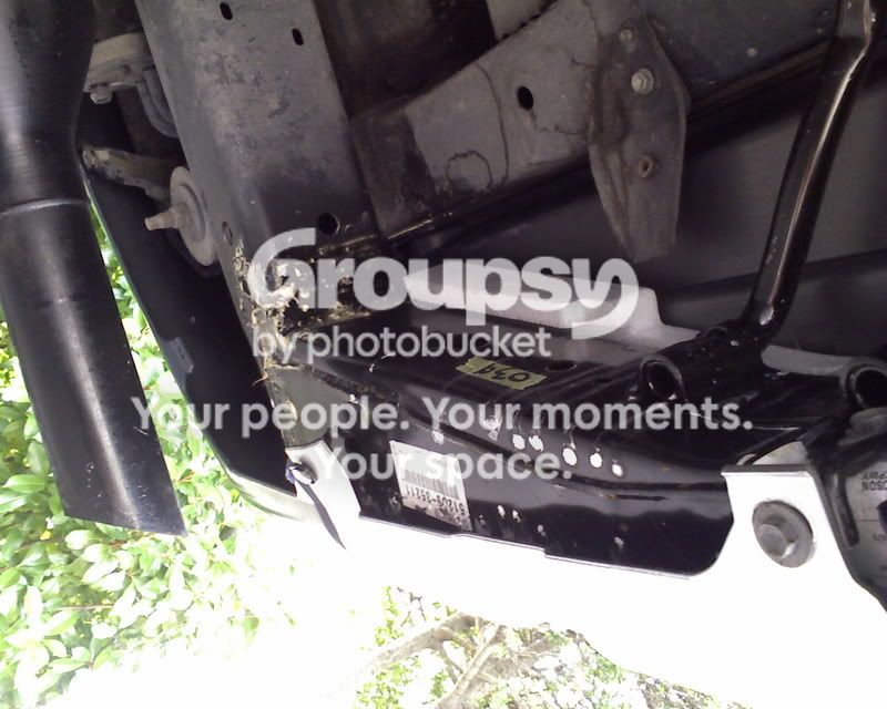

I'm still in shock. What is considered totaled out. I might feel better if the frame wasn't bent. I tow frequently and thats right where the tow bolts to the frame. :( I know they can repair, but will it be as sturdy?
It is very unlikely that your frame is bent. Looking at the pics, the right side of the rear crossmember and hitch took the brunt of the hit. The upper sheet metal damage appears to have left the rear hatch in tact. Once they pop it open, you will be able to see if there is any damage to the jamb or floor.
To total a vehicle, it would take a lot more damage. There are calculations the ins co. does to determine if it is totaled, mostly based on cost of repair vs actual cash value.
If you are concerned about the frame, take a look under the truck and look for new cracks, not old rusty ones in the black coating on the frame rails. Remember, the 4Runner has a boxed frame, which makes it very strong. If you have a bent frame, you would see other evidence, such as the rear doors not opening or closing properly or the rear end would be out of alignment. Once all the broken pieces are taken off, you would be able to see how little structural damage remains to the rest of the truck.
Good luck! Hope everyone is ok:)
Yes sir, you are correct. No frame damage. :) Crossmember is still bent like crazy and its welded to the frame. Guess they'll just pull it. Hope it will still pull 5k loads every once in a while :(

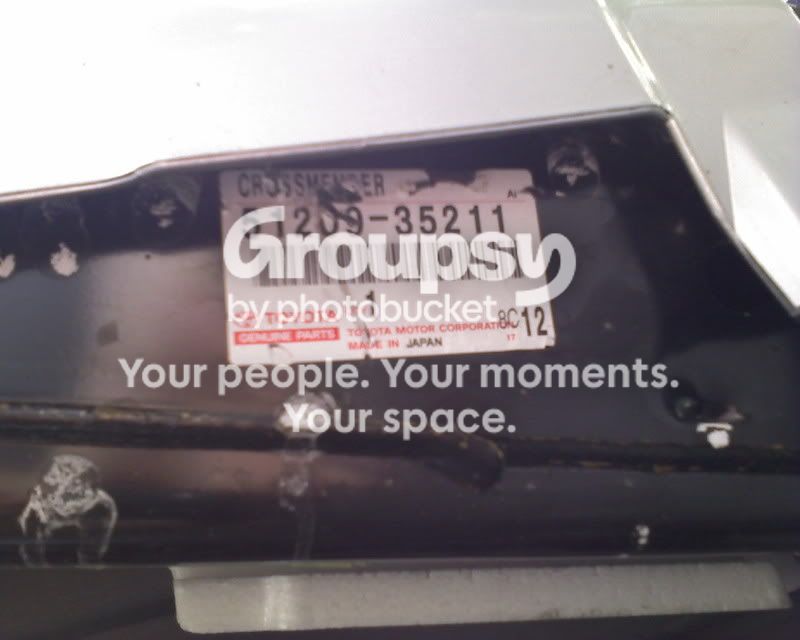

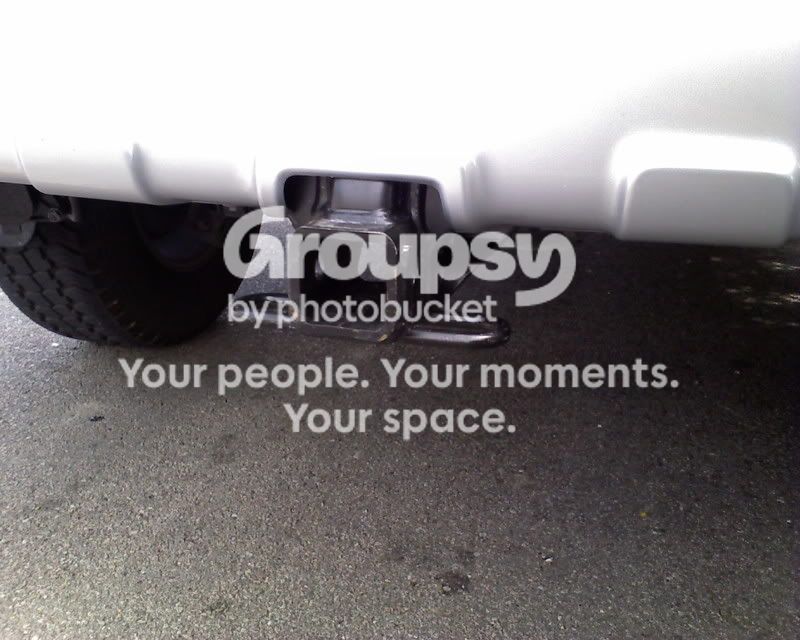

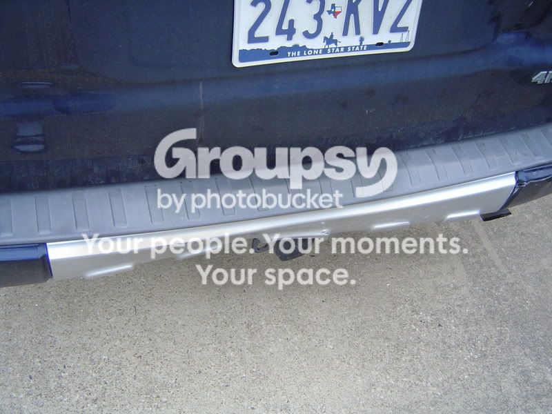

So I got the Runner back from the shop. They welded a new crossmember on with tow hitch. Its from toyota but two of the clips on the rear bumper cover did not line up. I just tie wrapped em up. And they hit the muffler with some flat black paint. Other than that, flawless job.
008.jpg~original
013.jpg~original
014.jpg~original
012.jpg~original
jeremysoca said:
That hitch is hanging a little low, no?
Yeah, I tried to look up the part number for the crossmember but no help. Anyone work at toyota and can look the part # up?? The spare is still lower than the hitch.
See part # 12 in the diagram.
I dont see any alternate parts avail.
Search by OEM Part Number:5120935211
Multi-Part Search
Collision Catalog
Item Number MSRP Core Price Price
5120935211 $230.53 $0.00 $176.36
Frame - Frame and components - Crossmember - Rear
Rear 2003 - 2005
Add to Cart Contact Us
Rear 2006 - 2008
OEM Catalog
CROSSMEMBER SUB-ASSY
