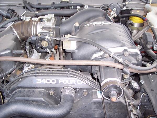

Just now ordered some parts from Conicelli Toyota who advertises on here, I found their prices to be very good and I called them with a couple questions and they were helpful.
I ordered:
OE Front Brake Pads and OE Rear Shoes
Coolant Hoses:
Upper radiator, Lower radiator, coolant recovery, and bypass hoses.
AC Bulbs #81850-35020....been meaning to do this fix as I've been driving around in the dark for a while, but didn't want to pay shipping costs that cost more than the bulbs themselves, so i waited until I had to order other stuff for free shipping.
I now need to order the parts to do the timing belt change and so i'm asking for opinions here. Some places online offer a "timing belt kit" that includes various parts.
In addition to the timing belt and water pump themselves, Conicelli recommended (says Toyota recommends) changing the "idler pully" and the "tensioner pulley". I also see on another site with a kit "idler bearings". I am also going to order the cam and crank seals.
Does anyone have an opinion on what should be replaced or not to bother with related to the timing belt-water pump change. Did any of you not bother with the 2 pulleys? Are there bearings? I figure the timing belt change is a huge project so i'd prefer not to miss anything, but also don't want to overspend for things that really don't need it. Thanks in advance.
