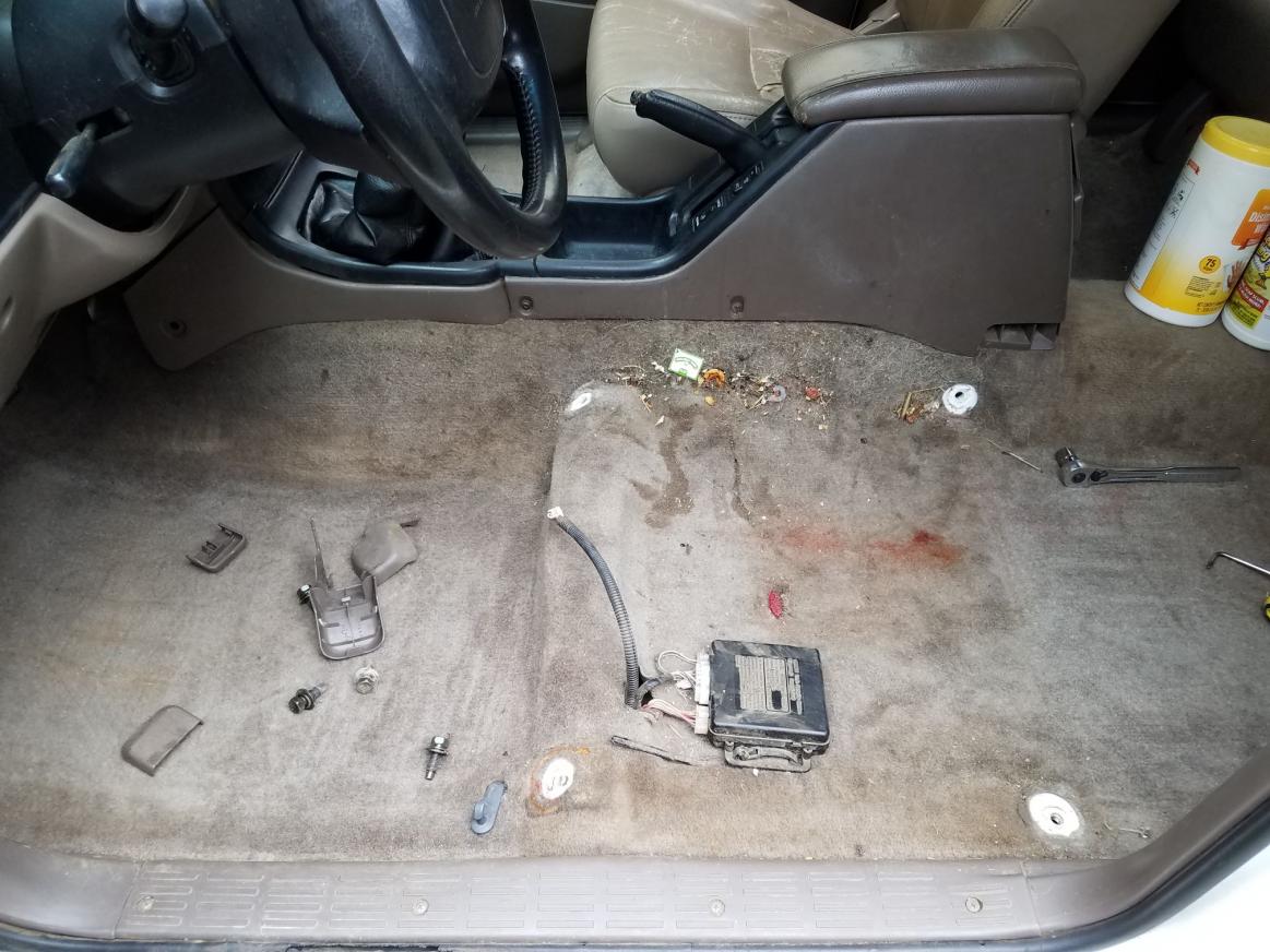

Picked up a 97, manual, 3.4, 4x4 with 315k miles a couple weeks ago.
$2k, came with most parts to do a timing belt. Unfortunately it needed tires and a SERIOUS interior cleaning.
Completed most of the interior cleaning and the timing belt service (with pulleys, pump, tensioner, belts, radiator hoses), and got new tires on it.

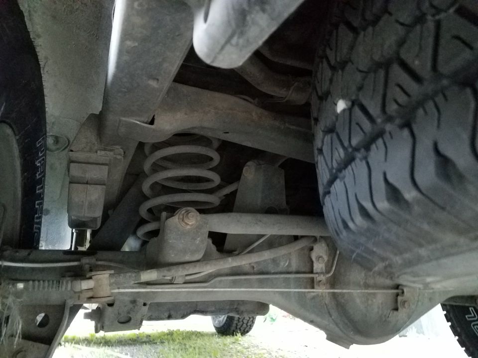

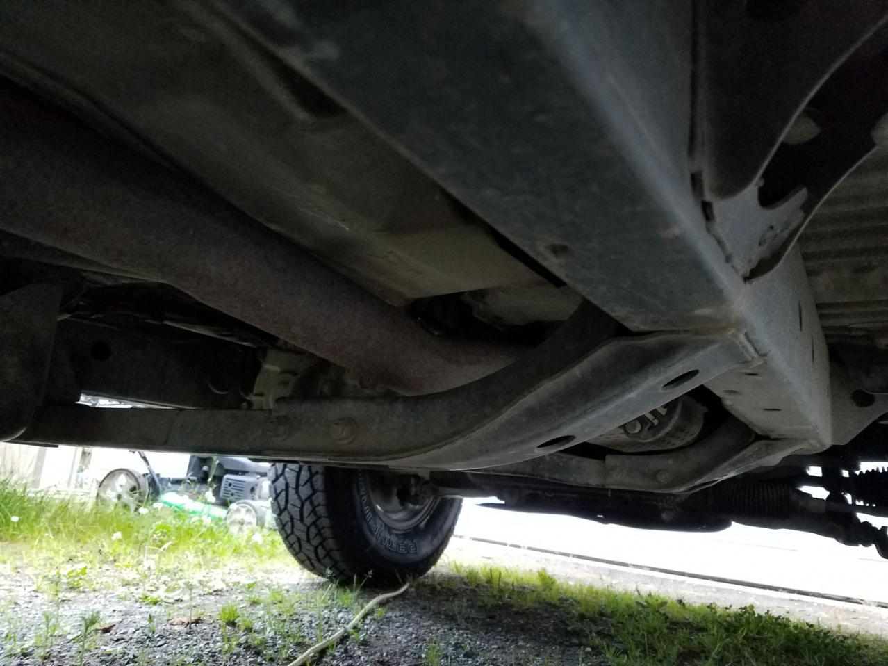

Should also add... zero, and I mean zero, rust on this thing.
The FJ40 was rusty, required new floor panels be put in and the tub was swiss cheese still. The 62 has rusty parts and a rusty roof (otherwise very clean). The FZJ80 had very mild rust on bolts. Hell, even the IS300 had some rust on bolt heads.
At 315k miles its the cleanest high mileage vehicle I've ever seen. Surface rust on the exhaust is the most I've seen.

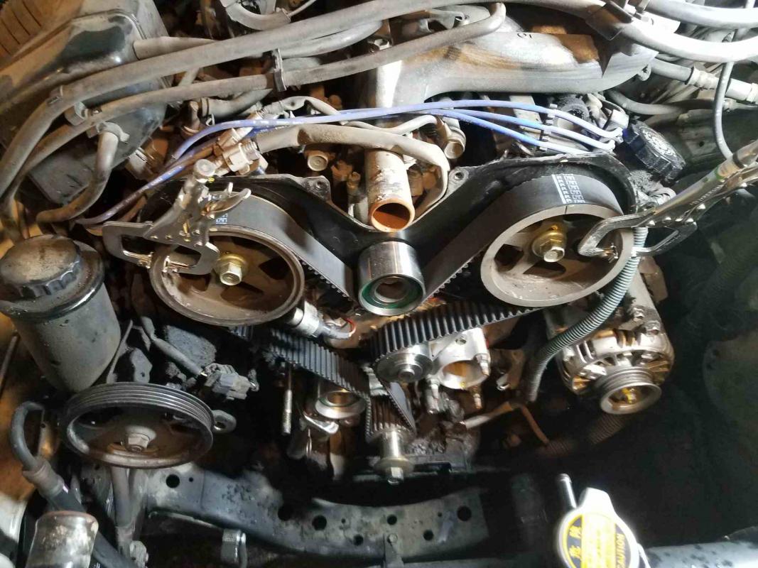

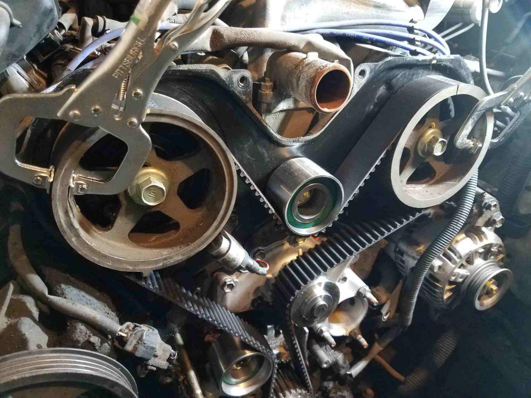

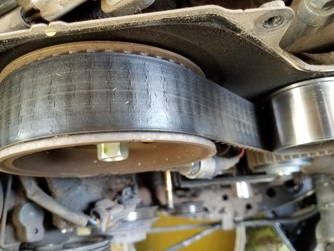

For installing timing belts this is a trick I used/came up with well over a decade ago that I've used on MR2 timing belts. Helps keep the belt in place without jumping teeth nor allowing the cam gears to move independently.
Not tight, but taught in the clamps. Worked like a charm.

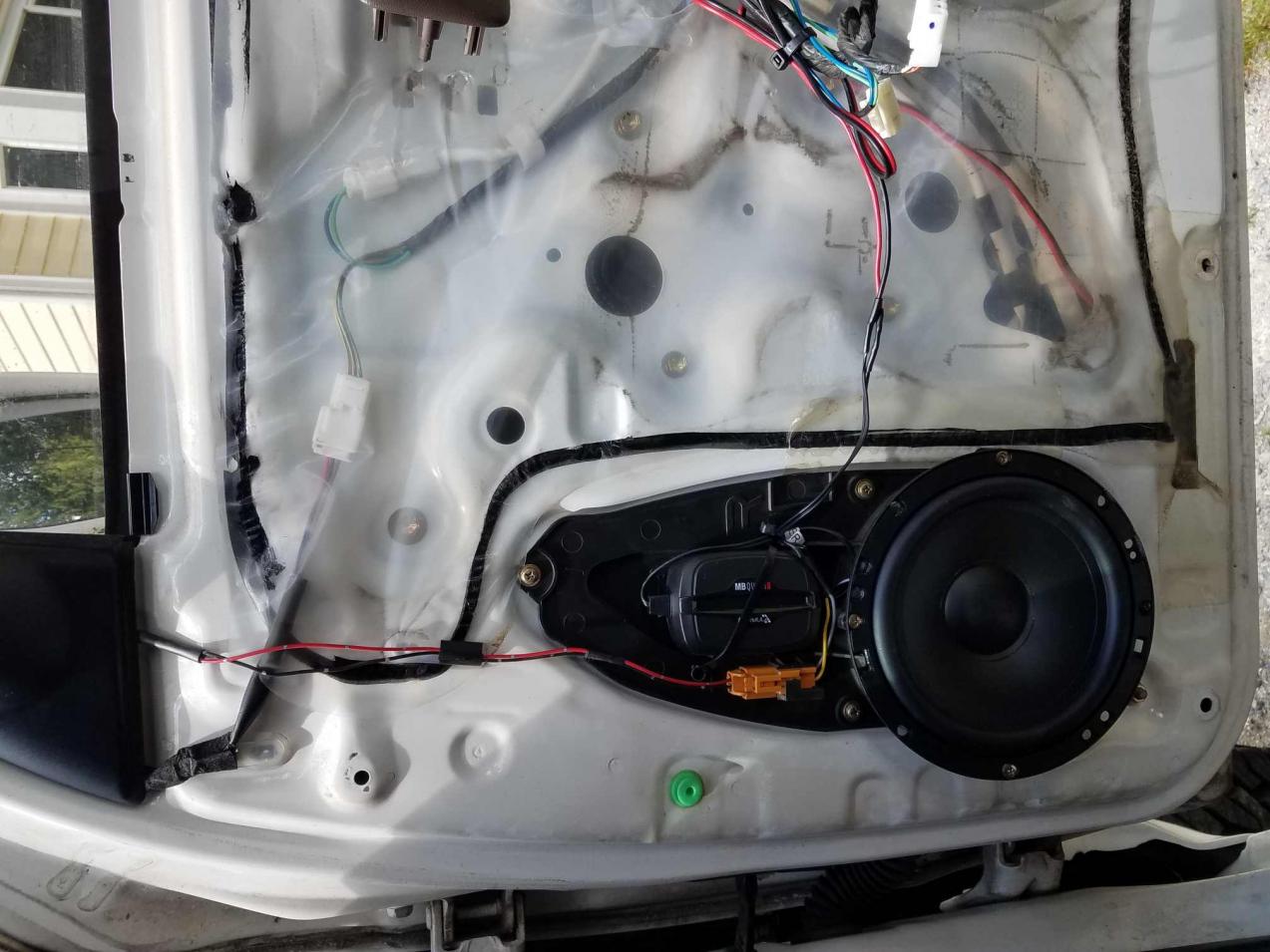

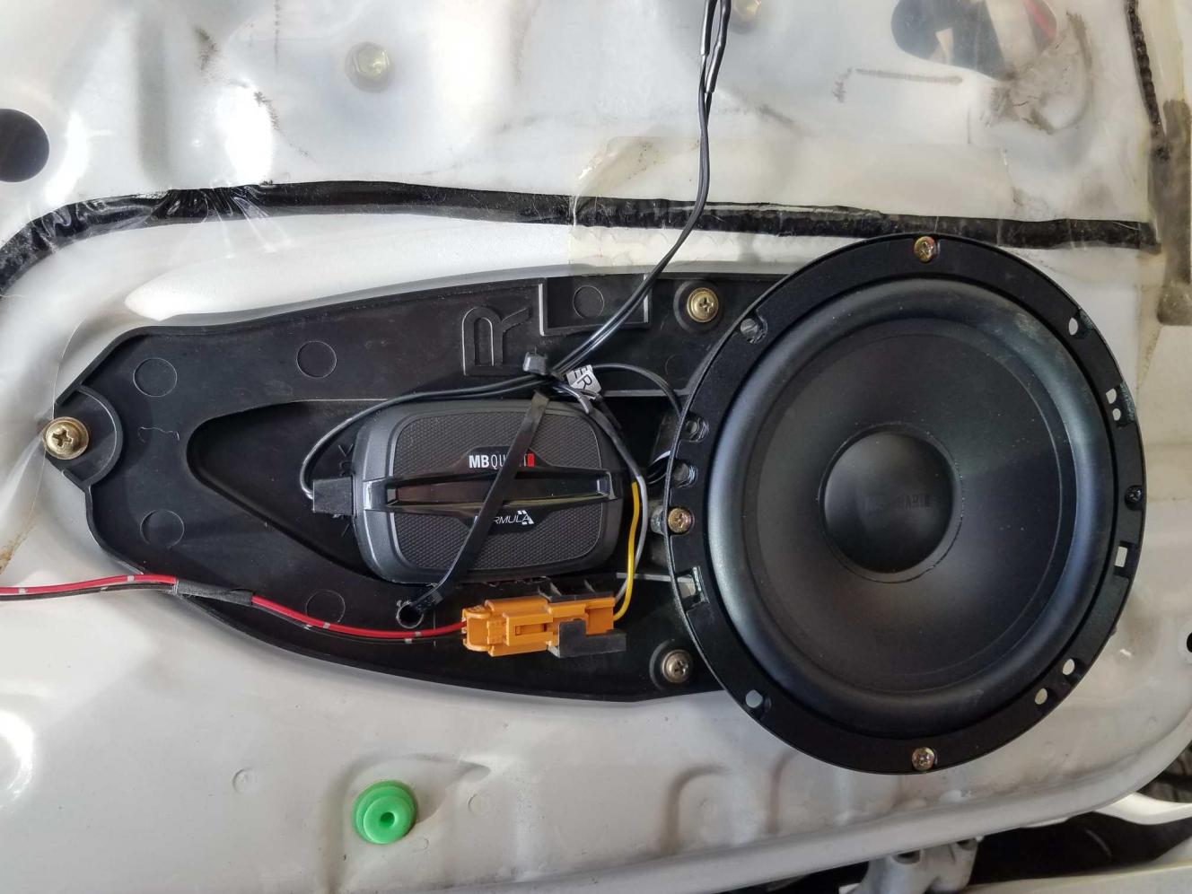

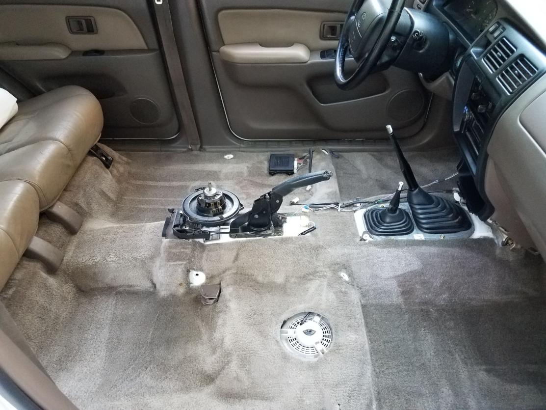

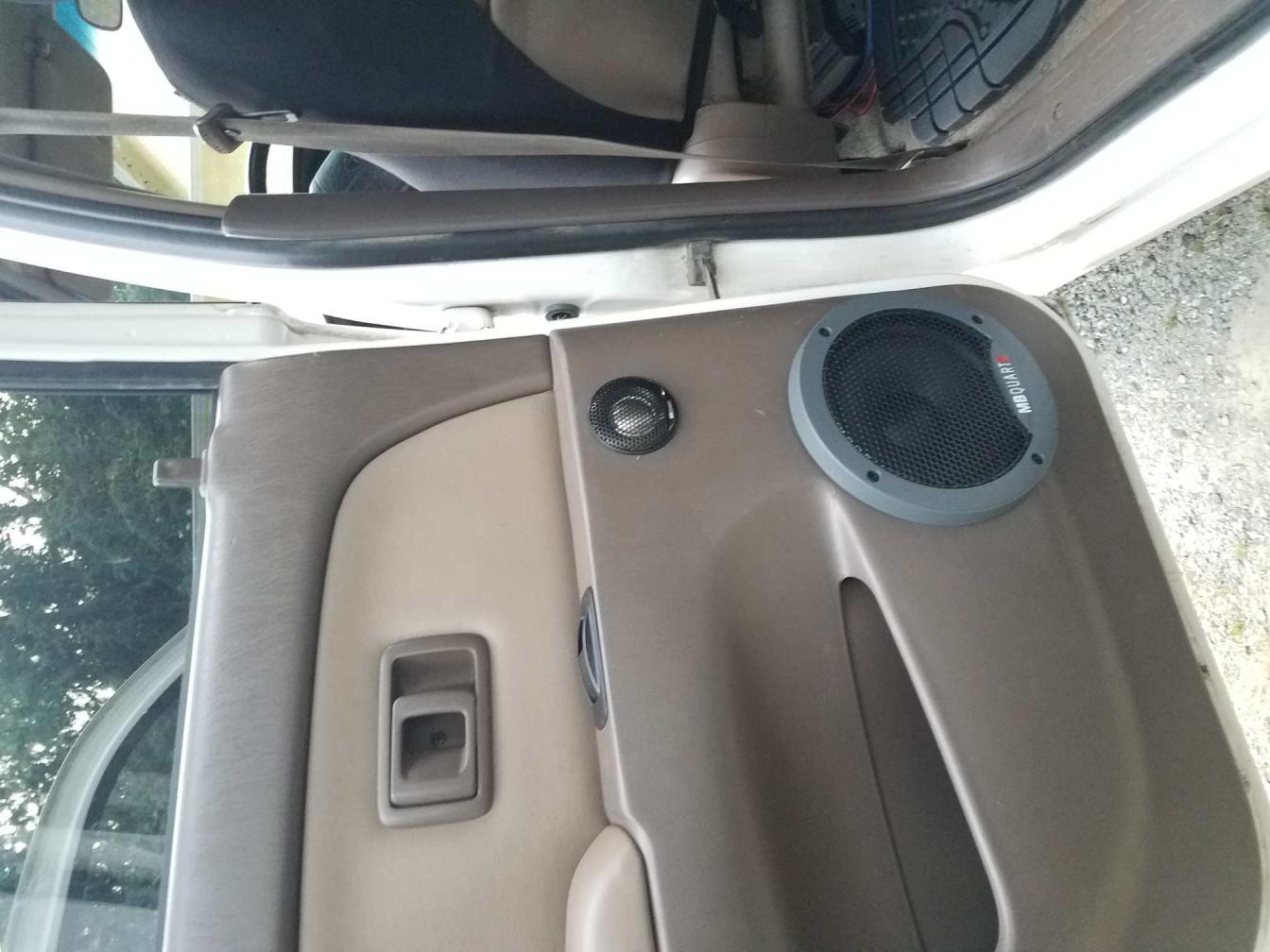

For the components-
The front stock tweeters were still perfect and the MBs wouldn't fit, so just wired those to the MB crossover. The crossover was mounted into the stock recessed housing with some minor cutting.
Rears didn't fit in the housing, so I cut and installed them into the panel. Not my first choice. but is what it is.
Amp is simply under the seat.

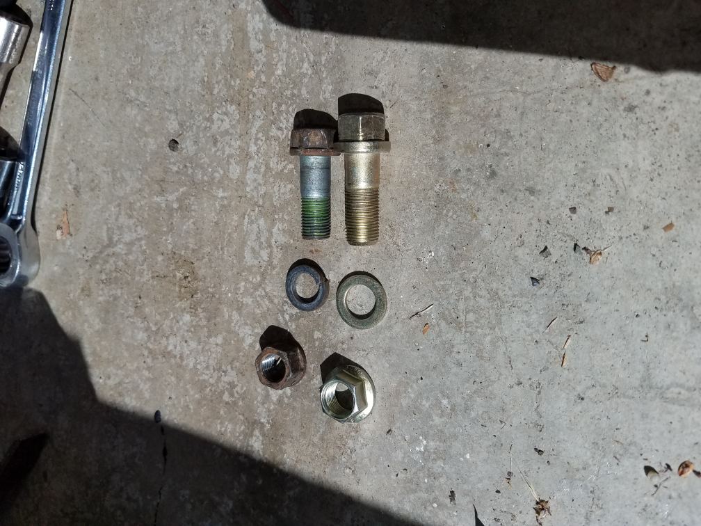

When I dragged the limited home I pulled the rear driveline to keep the trans from rotating. Just by chance I used a small tool carrier that I used to carry in an FJ40. I had to buy all sets of driveline bolts for it (as they were missing and then I upgraded the 71 to 76 axles).
Here's a new 1976 driveline bolt vs the 99 T4R. Mind you, the FJ40 had almost nothing in terms of power...

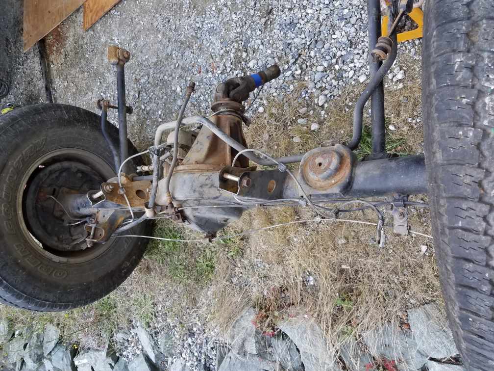

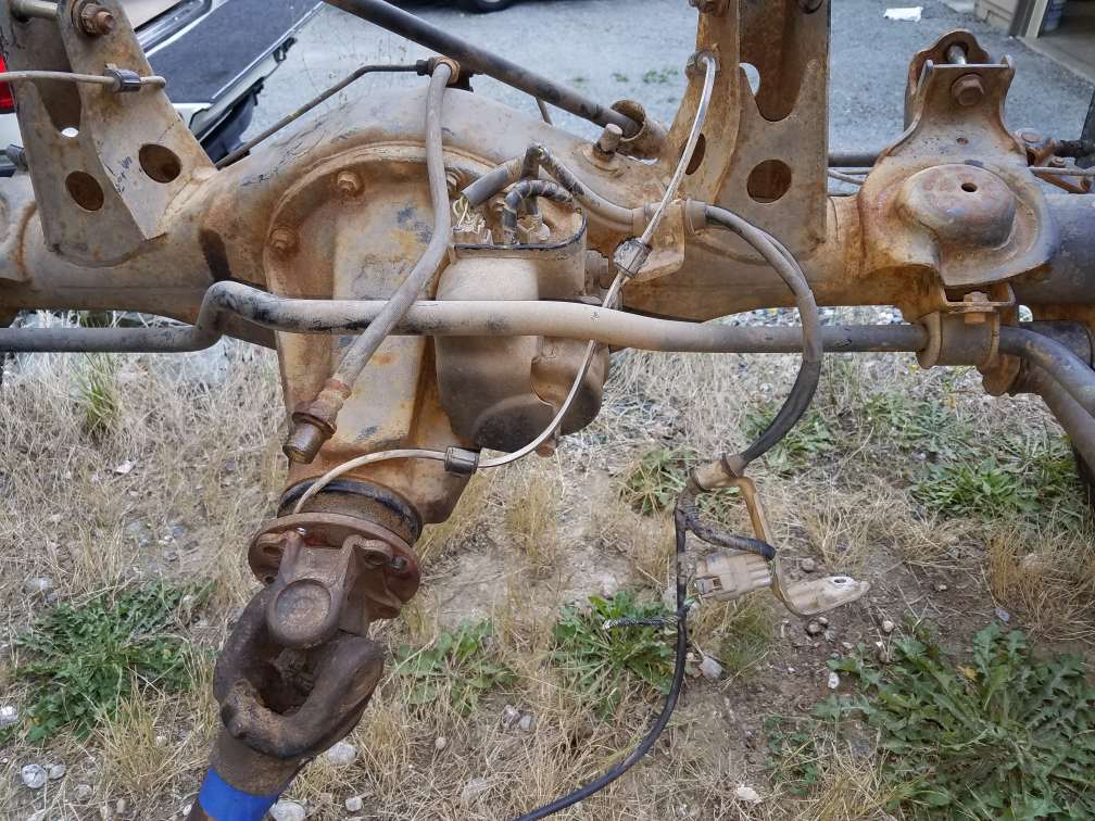

Did the simple rear ratio check.... as expected the auto locker is 4.30 and the 5sp open is 4.10.
If I can get enough for the 4.30 rear then I'll throw in an ARB (sounds like that's what my wife wants - her price for the factory locked rear keeps going down....) if not then I will look into swapping both front and rear. I did get the 4.30 axle out yesterday.

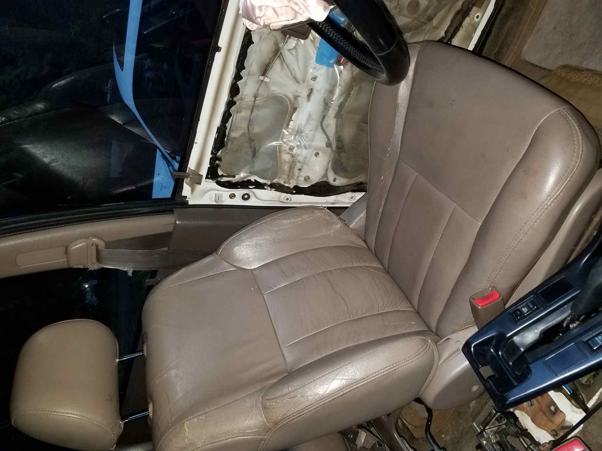

Gearing up to swap 3 of the 4 rear seat pieces (after cleaning).
So far the only items actually sold are:
Wheels and tires (and I got a set of Tundra rollers as a partial trade)
Rear hatch
Mirrors
Engine/trans I have several people on the line for with a 'viewing' today. If I get my asking price I will have back what I have into it (not counting labor, and I'm pulling the motor).
I think the steering rackin the parts rig is new(er). It's way too shiny.
I also think the parts rig saw a lot of wheeling. Very clean detail I recent history- extremely dusty/dirty behind all of the door panels.
Once the parts rig is stripped down and gone then I will start taking the manual apart to start with new fresh suspension and steering compnents.

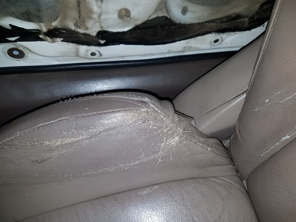

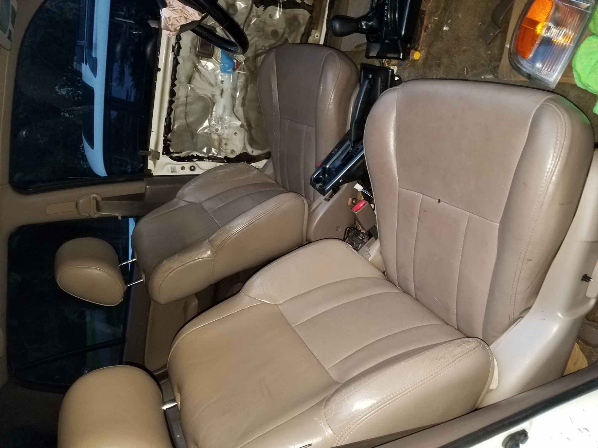

We'll see about the seats.
I would prefer the manual seats. If we can sell them to (mostly) cover the cost of new leather covers (the Lseat covers in our LX are pretty amazing for their price) then we'll go that route.

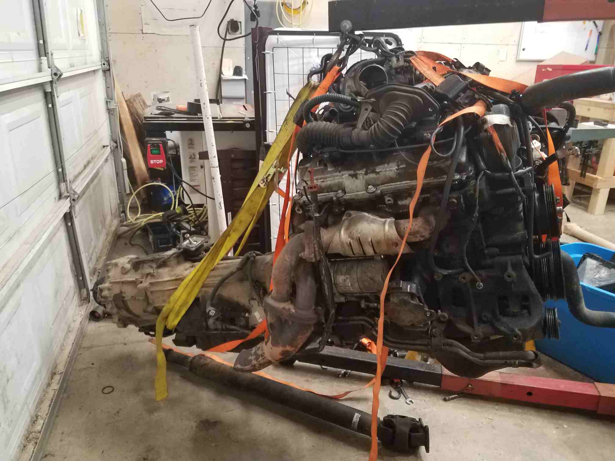

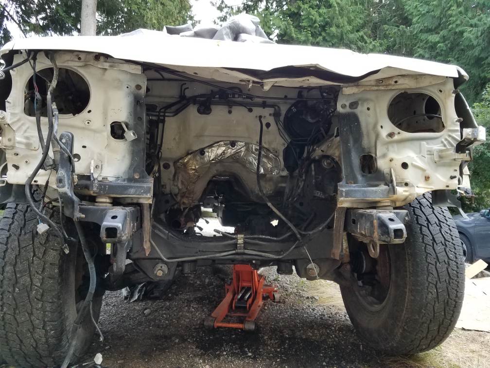

I think I learned today that this is not the easiest way to pull the engine and trans....
Should be noted.... bought this as a parts car and the PO ran it into a tree and the front center was fubar'd.
Even with the front cut open like this, the transfercase is really tough to get though between the front diff and the transmission tunnel.
