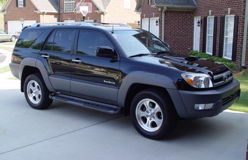

Here is mine after a good Griot's treatment..... :artist:
