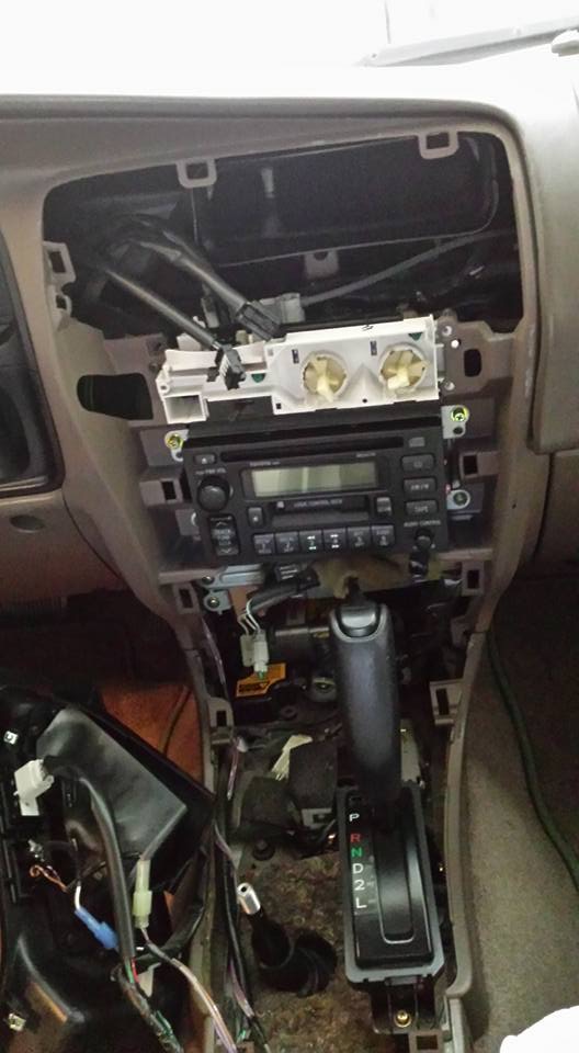

I need to see what an Auto/4WD looks like with the center trim pulled up to know where a bracket could mount. Want to take a picture for me?
. This doesn't help you does it Jordan ?
