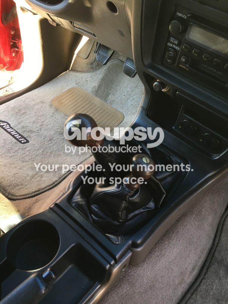

Cool looking knobs, but for the 4wd is it easy to tell which you're shifting into? I know it becomes easy with shifting a manual tranny but I wasn't sure about the same with 4wd since I've never used one lol
Just a J-pattern shifter so no problem. If it's in 4HI the 4WD light is on, if its in N the truck won't move, and if its in 4LO the truck will move really slow. :surfer:
