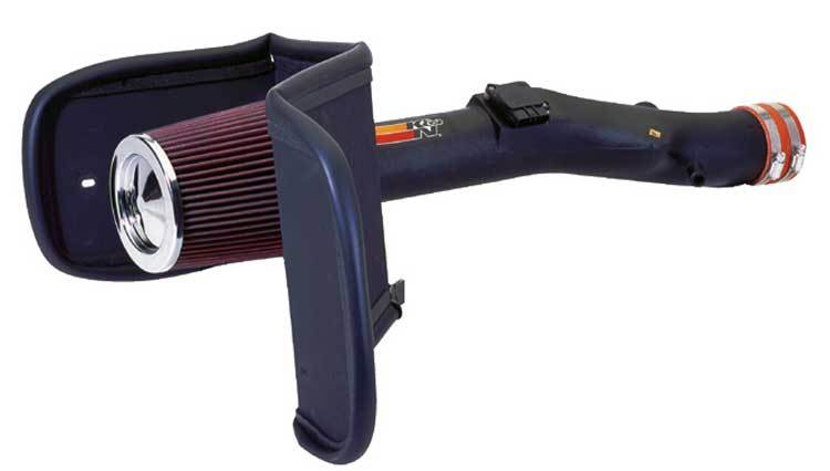

Has anyone purchased an Air intake, mainly a K&N one? If so, was it worth it and how hard was the install?

mine was ok in the jeep i had but i used a cover you can buy for them, (just on filter) but if you dont get a mostly enclosed box unit, water might/will get splashed up on it. depending how deep of water or mud your crossing & engine bay shields. id say if your worried, get a brand that is more enclosed or snorkel it. i mean, if ya look at the pic. of the k&n unit on this thread, its not protected much, so the cover is advisable at least for off roading, youll still need to clean the dust off though.
