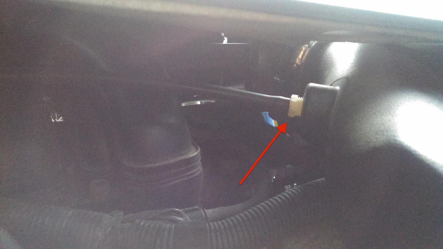

Hey guys, just installed my K&N intake. There's one part I have no idea what to do with. It has this hole on the side that I see no use for
Its on the tube towards the windshield side. Didn't have instructions, bought it used, any help is appreciated. Thanks.

im gonna go outside and look at mine, but I'm fairly certain its a vacuum hose. standby

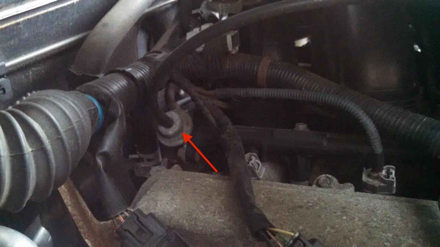

edit: just looked, it is a vacuum hose, it has a screw in fitting that goes on the intake tube and then a rubber hose runs to the rear (windshield side) of the intake manifold, there should have been a hose that came off with the stock intake that ran to the same location

Crap, can you post a pic of what it looks like please, didn't see a hose on my regular air box
yes sir give me one second
first pic is the hose attaching to the intake
second pic is hose attaching to the manifold

Thank you, the white twist in fitting is off the air box or did it come with the k&n kit? I bought mine used and don't think I received it, can I buy it at an auto parts store maybe?
i bought mine used and IIRC it was already installed on the intake tube when i got it, i think its supposed to come with the kit. it could help to call K&N and get a part number for it, a local auto parts store may have something like that
Emailed k&n, pm'ed member I bought it from, if worse comes to worse can I just put one of those tiny filters on the end of the hose and be ok?
