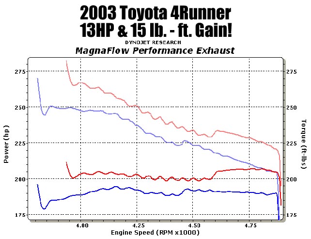

Towing 5100 lbs requires not using the OD. Some things that may help; The biggest thing that would help is to lower the final gear ratio. Change the tire size to one size smaller diameter (255/60/18). LT (E) tires are rated to carry heavier loads and you run them at 80 psi. The higher air pressure helps give a tighter ride (less rolling resistance with the added tow weight) Make sure you are running the tires at max air pressure. Adding an intake (CAI) and an exhaust will add an extra 15/20 hp and more importantly more torque in the lower/mid range RPM. Most people look at the peak hp gains from an intake and exhaust and think they did great or are disappointed. A good intake and exhaust could make a big difference in the low and mid RPM range where it would come in very handy, especially for towing .
Koz
