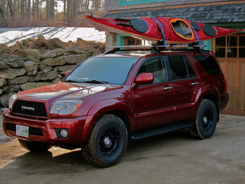

There is a product by Thule called the "Hullavator"
Thule 897XT Hullavator Demonstrated by Rack Attack - YouTube
I just put mine in "J" racks but 70 lbs is pretty heavy to be playing with over your head; especially if a breeze acts on it while you're trying to load it. (lot of surface area there) The "Hullavator" is pretty spendy but its cheaper than trashing your rig or your self.

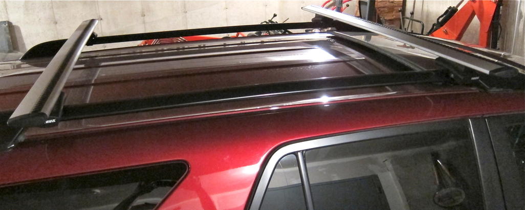

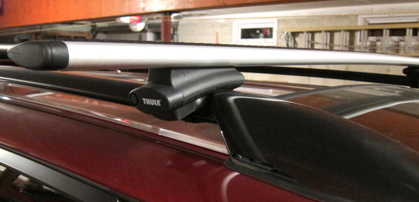

I think you will want to create a really sound platform to start with.
The main rails for our roof rack system are quite strong; the factory cross bars are not. You will not want to trust your kayak with those cross bars while doing 75 (or more) down the highway.
You will want to get a pair of cross bars to mount on your factory rails. You will want to mount them as close to the rail ends as possible to maximize the distance between the cross bars and to take advantage of the the strength of the feet that are bolted to your roof. (under the end caps). Once you have a good solid set of well-spaced cross bars you have a lot of options.
I can't assure you that the Hullavators will handle 100 lbs but I'm going to bet that they have a significant safety factor built in. I mounted a set on my wife's car and I can tell you that they are very heavily built. They are not cheap. The "J" bars would serve you well and cheaply but you would want two of you to place the kayak on your roof if you will be adding gear that stays in the boat. (I think the fish finders can be mounted so that they are quickly removable)
(To answer your question, the kayak you see on my Runner is ~ 63 lbs, 17'-6" long. I put it on and remove it my self but I'm 6'3" so perhaps a little easier for me and I do it a lot)
There are often roof rack components from Thule and Yakima for sale used. Craigs List is a good resource. The equipment new is spendy but Thule guarantees for life and Yakima may as well.
Sorry for long winded response; hope it helped some. I will add a photo of the cross rail set up in just a bit.
I thought our factory racks (including our cross bars), could handle at least 100 lbs? I'm looking at your photos and your main rails look different than mine... mine are round and the cross bars (which are flat) slide inside the main rails with locking twist knobs. It seems really sturdy. Did you have bad experience with the factory cross bars in the past?

Cangler:
I have the basic roof rack that comes with SR5. My cross rails had plastic ends that slid into the tracks and I didn't trust them. As I said earlier, the forces trying to rip your kayak off the roof are significant when you are traveling at highway speeds. Add to that, buffeting cross winds and ... well, you get the picture.
Cangler:
I'll look at my cross bars again and see if I see any plastic, but I don't recall seeing any plastic other than the twist knobs. Yeah, I defiantly wouldn't want plastic holding the cross bars on to the main rails.

Do the yakima crossbars mount to the existing 4R main rails, and you just remove the factory crossbars?
Cangler,
yes, Yakima and Thule (and possibly others) make "feet" that attach to your factory rails which you then attach the new cross bars to.
You can explore this at thule.com or yakima.com
The nice thing is that you can move this set-up to your next vehicle or a different one as needed.
