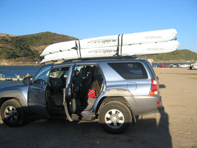

Does this work? Well, then again, these are ocean kayaks; but still. What we have here are rack pads for cushion, and cargo webbing purchased from the kayak dealer which strap down tight enough to dent the kayaks. Been kayak-fishing since June 2003. No problems transporting the 'yaks yet*
I'm not a very big guy (5' 9", 140lbs), and I just pick up my kayak sideways, step on the running board, and place it on the racks. Nevertheless, they do weigh 52 pounds; I don't know how much your guys' kayaks weigh, but this is how I do it.
