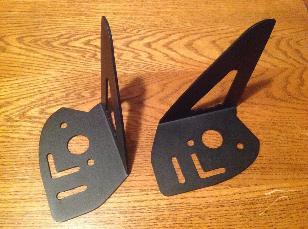

I bought these side mirror brackets from Yodateq. They're made for FJ 80's, but I figured I can make them work. I took measurements and the won't fit as is, so I'm either going to modify these or use them as a template for building my own and sell these.
