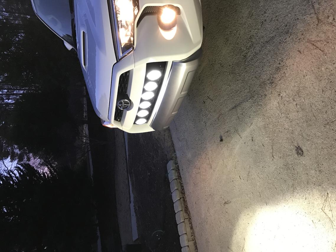

Like this ? Fairly easy, only trouble I had was connect the last red wire to the starter. To not accidentally touch the light button and leave them open all night, but you can fuse tap it if you don't want to open the dash and all.

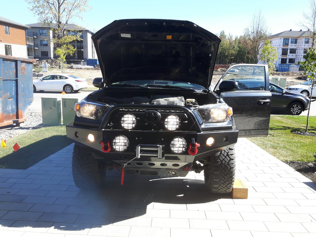

Yes the 2 on top had holes already made for leds or PIAA and the bottom ones I pre-drilled before I got it installed. 2 1-inch holes and 2 3/4-inch holes for the wires. I got installation pics but never got a chance to upload them on the forum :)

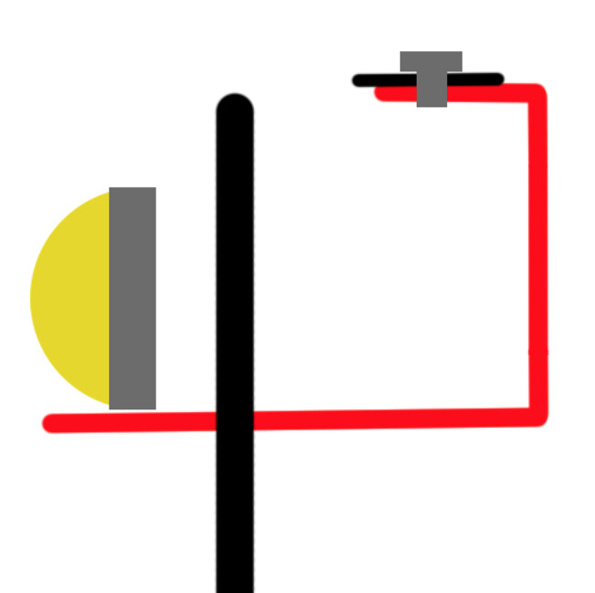

You could use the grille support frame and mount some brackets to the underside and have it come out of one of the grille openings. Think of a "J" bracket. Where the long part top of the "J" would be what pokes sticks out of the grille and the bottom of the "J" would be where you would mount to the grille support. Below is quick illustration of what I am talking about. This would be a side view. The small black line is the grille support. The red line is the bracket, the grey and yellow is the light. The thick black line would be the grille.
The only problem with that would be bouncing, or jiggling, maybe a cross brace would help, if there is room for it. Sorry, just thinking out loud.
Yea, I was going to mentioned that as well. Just drill a hole in the brackets and and use a piece of aluminum stock bolt it everything up nice and tight. Another cross brace could be used where you would mount the lights too. It would also be a good idea to use a thicker aluminum/steel stock for the brackets/cross brace to prevent them from moving as much.

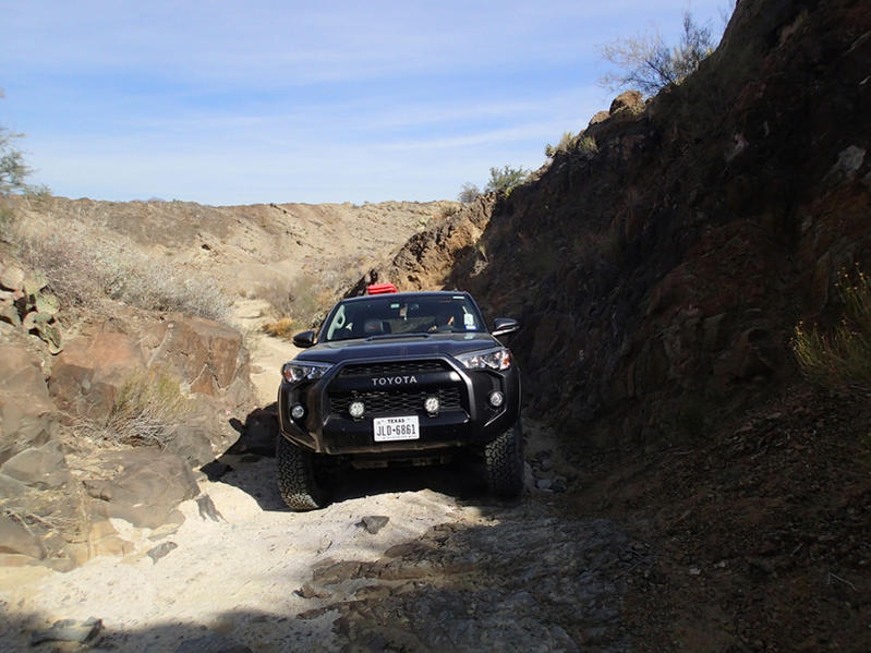

So... these aren't exactly KCs, but they are similar. I mounted them to the bumper "skin". I put a large piece of metal and some huge washers on the threaded post to help distribute the weight across a larger area of the bumper skin. I was afraid they would vibrate and damage the plastic bumper skin, but they haven't despite my best off-roading efforts.
