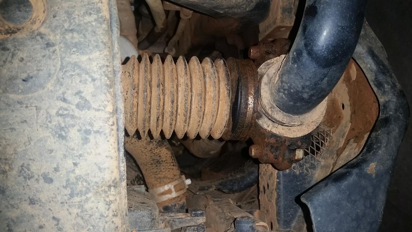

So I've been going to and from the dealership on a creaking when making a left hand turn at low speed and finally got under it and took out the skids (finding they forgot 3 bolts while I was at it) and saw this on the KDSS front boot.
Taking it in on Thursday to have a pretty enlightening conversation with someone that knows diddly about the KDSS system but now but here's the rub. I have Bilsteins set at 2.5" and im almost 100% sure they are going to give me the "you have modified it and we can't cover it".
Thoughts on this? From what I can see and understand, this piston only goes straight up and down and should not be persuaded one way or another due to the lift.
2014 TEP 2.5" lift with 285s

You can try but here is how it works...
Dealer makes a claim with Toyota for warranty. If Toyota thinks its a reasonable/normal problem... Then it gets fixed with no more questions. If Toyota sees that this is not a common problem or it is an expensive repair... they start asking questions about modifications to the vehicle. The dealer either lies and gets it covered or they hand you a really expensive bill.
KDSS and lifts are not compatible according to Toyota. We all know that people run lifts with KDSS with no major problems, but you can understand why they would take that position. It puts the control arms in a static position that KDSS was never designed for.
Are you sure it is leaking. That may be some fluid from somewhere else...

Agree. Quite frankly when it comes to the mechanicals of our rigs we probably know more than the techs working on it. Just a case by case scenario. It was lucky that the sales managers recognized you. If the first dealership doesn't work, I recommend hoping from one to the next until you find the best quote or can hopefully get it done for free without issue. Definitely a hassle but worth it if you can avoid a KDSS bill which I can only imagine would cost some serious $$$$.
I'm not suggesting that this would be perfectly ethical, but maybe try to get the factory shocks from someone who is upgrading and swap those in before you take it to the dealership?
i'm not sure shopping the issues to multiple dealerships, it seems like other dealerships would be able to see a denied warranty claim, right?
If you're really really concerned, set the shocks down to zero or .85 before you go in, they may not even notice.
I know that's not a small deal, but neither is standing KDSS repairs on your dime.
This is unfortunate and I hope you're able to get it fixed but if I had to guess, I'm going to bet they'll deny it.
I really don't think putting stock shocks on is the right thing to do either because if they cover it, they're basically covering a claim which is your fault and not theirs. All that means is that the price of warranties goes up for everyone else.
Personally, I'd monitor it a little more, do some more research about KDSS leaks/repairs, and if you need to replace/repair it.
Any update? Was it diagnosed as a KDSS leak?
I don't feel that it is a leak. I have monitored this thing every week and nothing. I think that the tech sprayed silicone on all the swayback bushings when i said it was making sounds so it likely spread a bit or over-spray prior to me complaining about it. Also,the creaking sound that i was hearing was the hood latch... amazing what a simple creak makes your head spin.

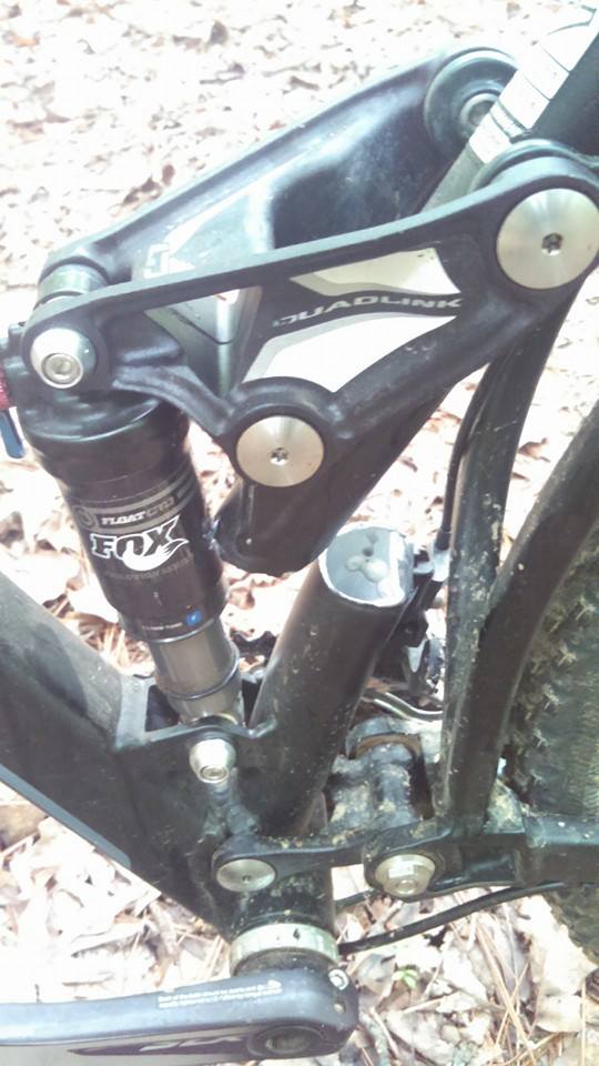

Haha. Rider: "I swear it's the bottom bracket!" Mechanic: "Sorry. It's your seat post."
Yeah, I don't know why I said it's just FS riders that go through hair-pulling sessions of creaking noise chasing. Having more moving parts certainly doesn't help but even the KISS crowd can have "fun". The derailleur hanger is one of my favorite WTF! ones.
That's a lesson every full-suspension mountain bike rider learns. ESPECIALLY on carbon frames.
Ti SS is the worst. there is nothing that should make any noise... i swear it it the WORST. At least i know there will be noises with gears!
I get some squeaks with my fully rigid steel hardtail 29er SS, too.
It's just one of those WTF moments.

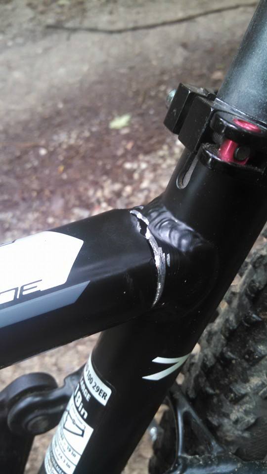

Last time I had creaking it turned into this..

Update....
... So it is a leak...
Went in for one last checkup before the warranty is up. Toyota is taking care of it. Ordering a new front piston, and boot assembly. I guess they replace and re-pressurize the system.
Regardless, I'm driving a Taco while this is done so cheers.
Wow. Good to hear. Had a scare on my system a few months back (there's a thread on it).... turned out to be nothing. But I keep a close watch now for leaks. Your scenario matches mine (set-up), so it gives me a little more peace of mind if something were to happen. Obviously, each dealership is its own beast, so ya never know...
