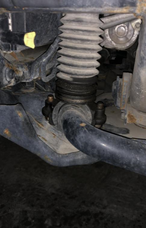

Can you post a picture of the leak so others, such as myself, know what to look for on our 4 Runners?
Thank you.
I never took a picture but just grabbed this from the internet. My undercarriage still looks brand new and just the bottom of my boot looked a little wet. Not a lot of fluid was coming out. My boot even looked pretty new. But I think you get the idea. Any fluid is no good.
