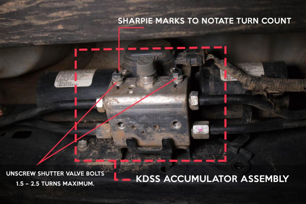

KDSS lift install method - anyone try this?

This is almost a requirement on the 200-series Land Cruiser’s. It’s been done plenty, and will likely make the process a ton easier than the bafoonery I got into with rachet straps. Be sure you DO NOT back those screws out beyond 2.5 turns. There’s nothing but sadness beyond 2.5 turns.
I used this method when I install my Icon stage 2. I did it per Metal Tech's advise. It makes it easier because the system isn't as pressurized. I didn't use straps or remove the clamps on the KDSS piston or the stationary bar. An extra hand makes the install easier. Make sure you do it on level ground.
There’s plenty of ways to do it. I chose not to remove or loosen anything KDSS related. Just jack up the kdss piston to lower the opposite side.

I agree if you’re worried about lifting on the piston lift the LCA on the driver side to make it easier

first time i installed the lift i had about 3/4" lean. i opened the valves like the OP says, jumped on the high side and it was enough to pull the high side down. Not sure if it remained even like that, i stopped checking/caring. It might not have even been related to the sway bar, just needed to get the suspension to settle.

Yeah, I tried it on the ground yesterday and nothing changed whatsoever. I had backed out the valves 2 full turns but maybe that wasn't enough? I was stressing going passed the 2.5 mark.
“You do not need to remove your KDSS sway bars. Just loosen the shutter valve bolts 1.5-2.5 turns maximum. Do not go further than this. Once you have the shutter valves open, you should have more flexibility with the KDSS”
I have done a bit of work to mine. I have seen that technique. Screwing with anything hydraulic related KDSS, no thanks. If I had the SST or knew where I could borrow one, I would. As is I have two floor jacks, a long drift punch and a single ratchet strap, unbolt one side at a time and zero issues. I will say the first time I did it was a PITA :madgrin:
